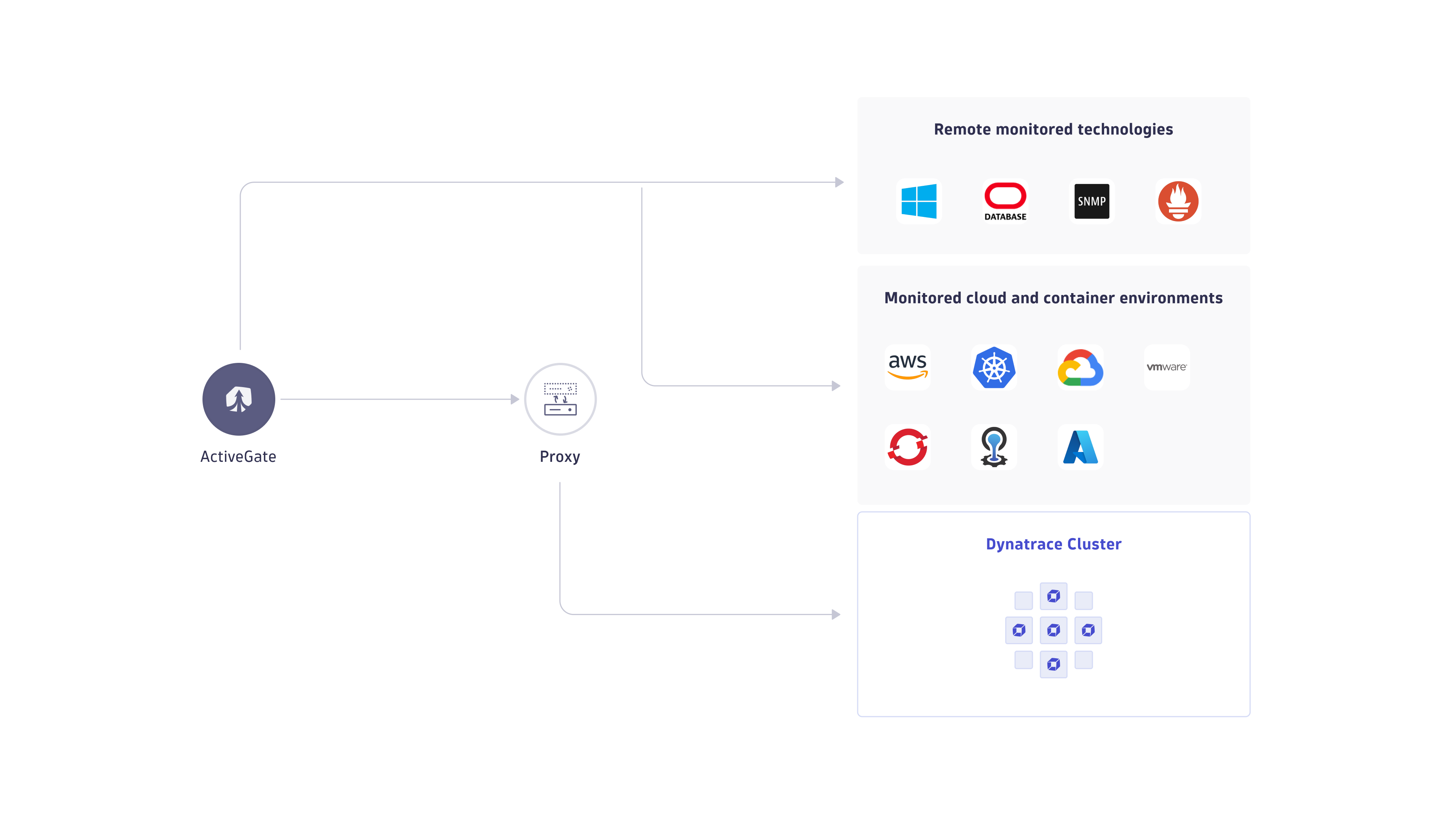

The following configuration covers the most common case of specifying proxy settings for ActiveGate outgoing connection to both the Dynatrace Cluster as well as monitored technologies, such as AWS, VMware, or Azure.
Specify the proxy-related parameters in the [http.client] section of the custom.properties file— including those parameters related to authentication, if required:
[http.client]
proxy-server=127.0.0.1
proxy-port=8080
# basic authentication credentials
proxy-user=username
proxy-password=password

ActiveGate proxy for outgoing monitoring traffic, with direct connection to Dynatrace Cluster
ActiveGate proxy for outgoing monitoring traffic only
To set up a proxy specifically for outgoing monitoring traffic, but keep connection to Dynatrace Cluster direct:
  • Specify proxy configuration in the [http.client] section of the custom.properties file.
  • Turn proxy off in the [http.client.internal] section.
For example
[http.client]
proxy-port=8080
proxy-user=username
proxy-off=true
ActiveGate version 1.247 and earlier For ActiveGate communication to function properly, after specifying the above settings, you will need to repeat non-proxy communication settings in http.client.internal or http.client.external and/or you will need to create sections http.client.internal or http.client.external. For more information see current limitations.

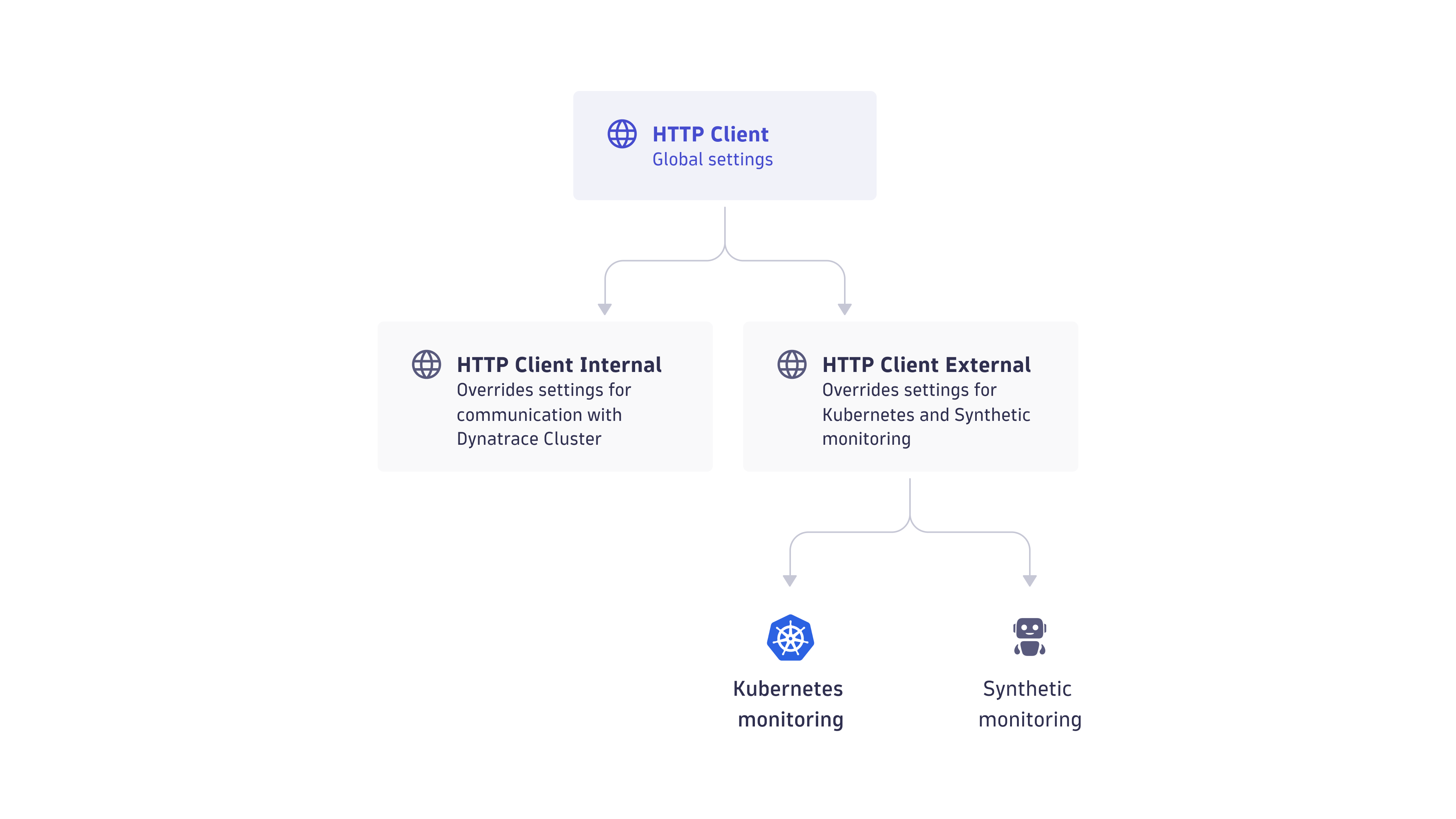

Advanced proxy configuration scenarios for ActiveGate
To set up a proxy for outgoing connections from ActiveGate—that is for connections to monitored technologies or to the Dynatrace Cluster—edit the custom.properties file and set properties in the appropriate section. Depending on the configuration section in which the properties are specified, the proxy (and other communication settings) affect only selected types of connections:
  • [http.client]—proxy settings for all ActiveGate outgoing connections, including the Dynatrace Cluster as well as all monitored technologies.
  • [http.client.internal]—proxy settings specifically for the communication with Dynatrace Cluster. These settings override the settings specified in [http.client]
  • [http.client.external]—proxy settings specifically for monitored technologies: CloudFoundry, Kubernetes, private Synthetic monitoring. These settings override the settings specified in [http.client]
  • [<technology name>]—proxy settings specifically for the particular monitored technology, such as cloudfoundry_monitoring, kubernetes_monitoring, synthetic. These settings override the settings specified in [http.client] and [http.client.external]. Note that Settings for many of these technologies can be specified jointly in [http.client.external].
This precedence and inheritance of configuration settings between different configuration sections can be pictured graphically as follows:
Proxy inheritance
