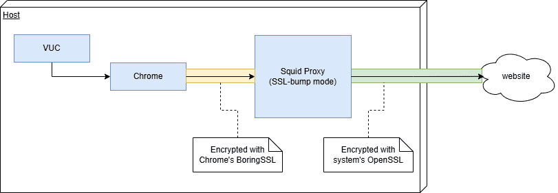

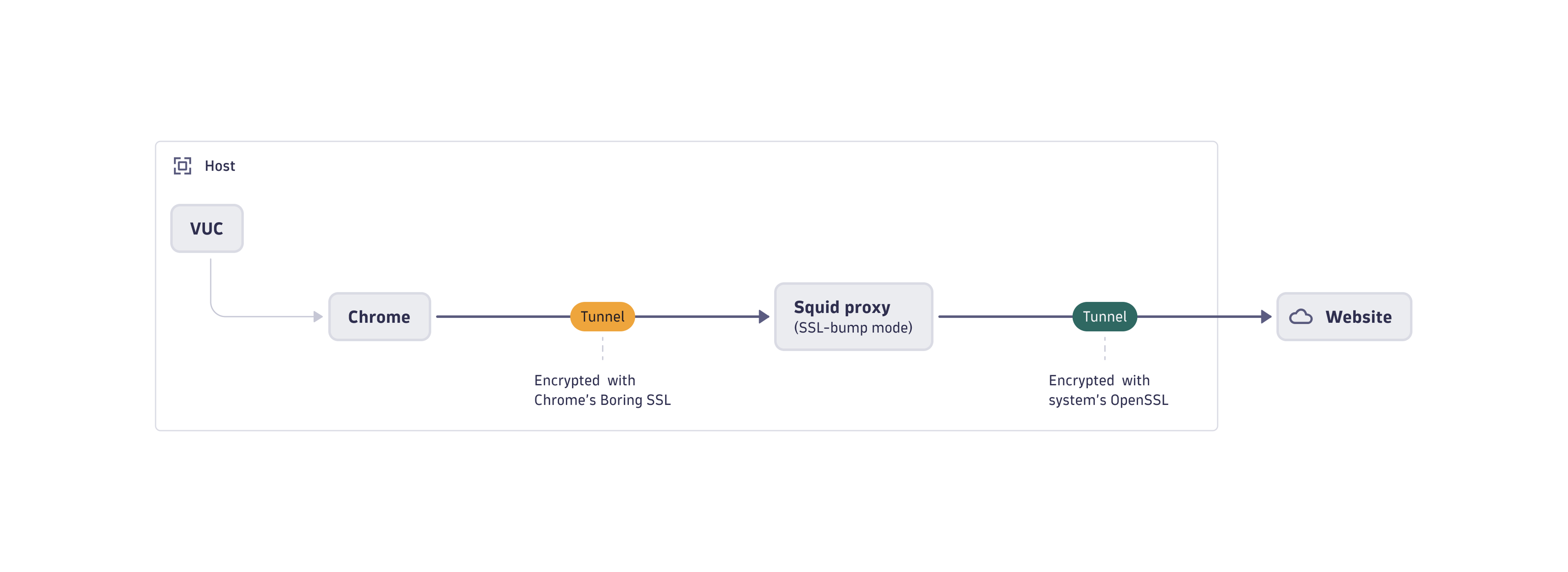

Proxy configuration for FIPS mode
When Synthetic location is installed in FIPS mode, browser monitor traffic must be routed through local intercepting proxy, so that all traffic leaving the host is encrypted with a crypto library that is FIPS-certified:
FIPS proxy
In this example setup, we use the Squid proxy linked to the system's OpenSSL library, but you can use different proxy software as long as its crypto library is FIPS-certified.

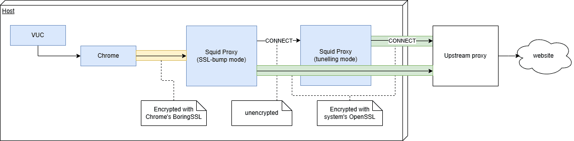

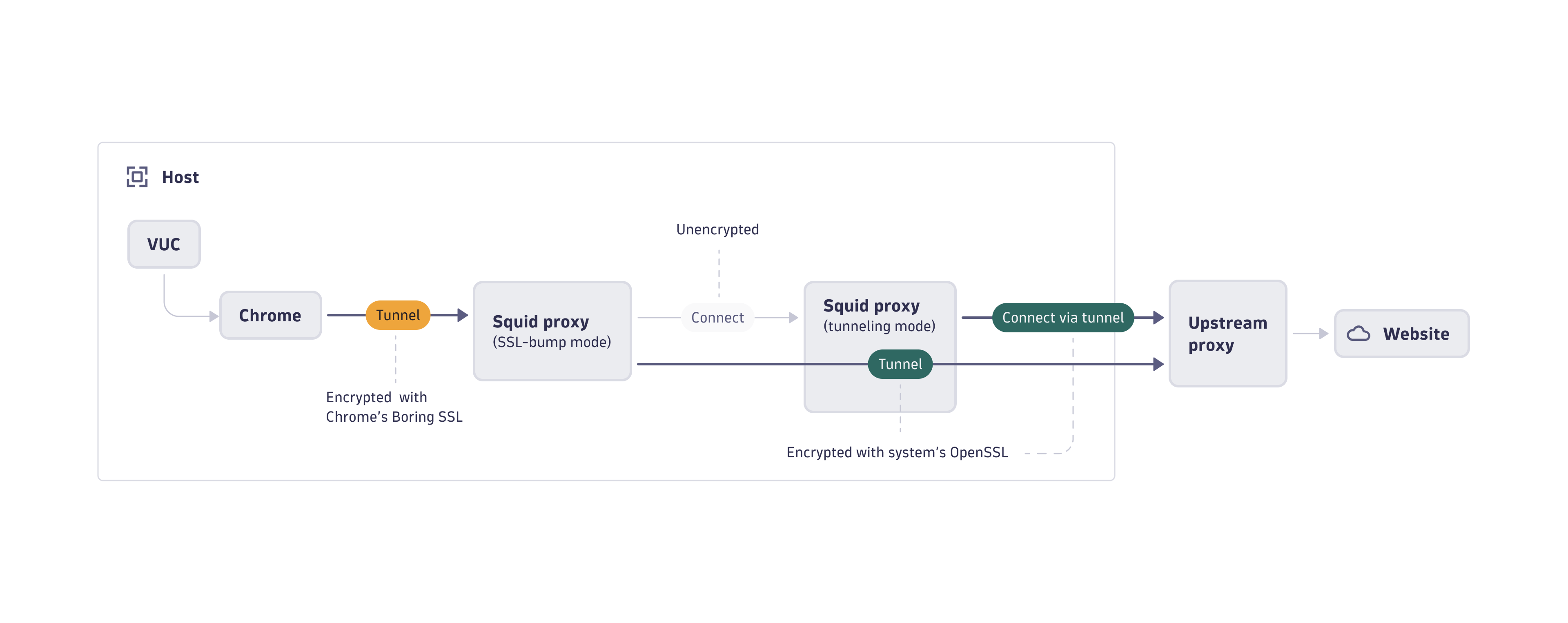

Proxy configuration for FIPS mode with corporate proxy
If your organization mandates use of a corporate proxy, you need to set up a second local Squid instance due to limitations of Squid:
FIPS proxy chain
If you're using a different proxy software, this might not be applicable to you.
