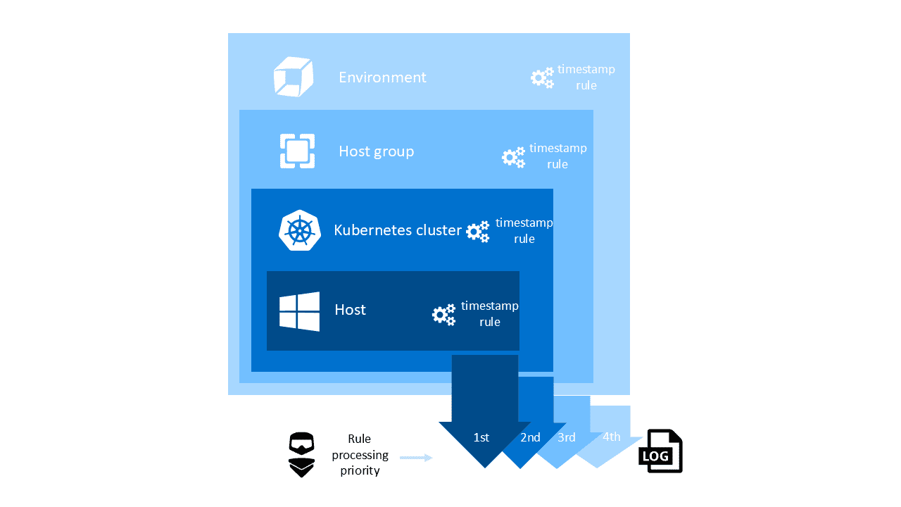

Supported scopes
Four hierarchy scopes are supported: host, host group, and environment.
The hierarchy scopes are merged into one list in the following order:
  1. Host rules
  2. Kubernetes cluster rules
  3. Host group rules
  4. Environment rules
The OneAgent receives the merged list (merged lists from its respective hosts, host groups, and environments) with no indication of which scopes are defined.

Rules are executed in the order in which they appear on the Timestamp/Splitting patterns page.
Rule reorder propagation delay
When you change the rule order (to change the order in which they are executed), allow for two or three minutes of propagation time between when you save the change and when the change takes effect.
The Active toggle
Starting with OneAgent version 1.249, you can activate/inactivate your rules by turning on/off the Active toggle. To manage your rules effectively, we recommend that you upgrade your OneAgent to version 1.249. If you have any rules set on the host with OneAgent version earlier than 249, you will not be able to inactivate them, in which case you need to remove such rules by selecting Delete on the rule level or via the REST API.
Configuration limits
You can add a maximum of 100 timestamp rules per each scope (host, host group, Kubernetes cluster, or environment).
