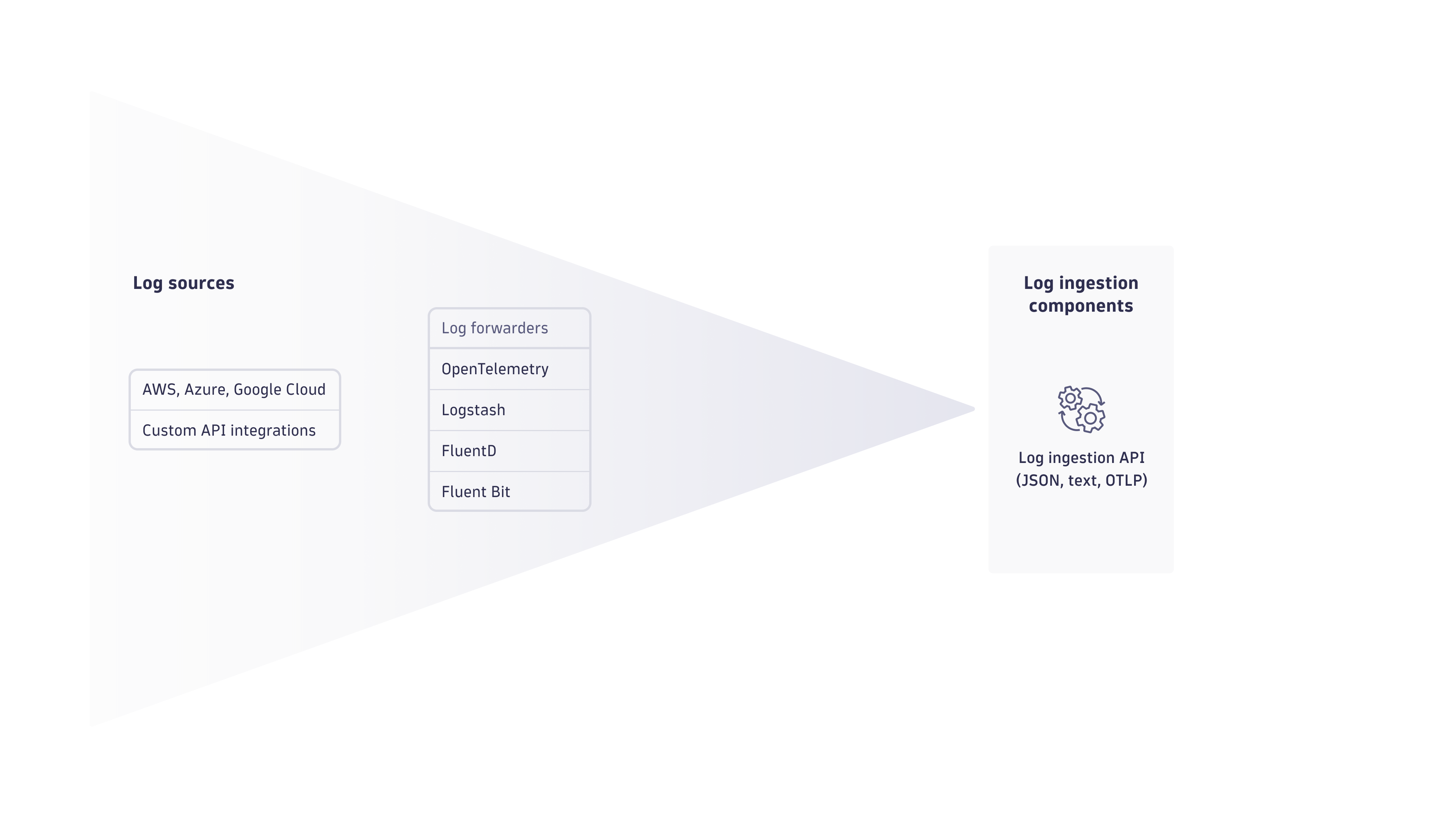

You can configure Log ingestion API integration for any log shippers that integrate with Dynatrace REST API, e.g. OpenTelemetry Collector, Fluentbit, Fluentd, Logstash.
Dynatrace automatically collects log and event data from a vast array of technologies. With the Log ingestion API, you can stream log records to a system and have Dynatrace transform the stream into meaningful log messages.

The Log ingestion API allows you to stream log records to the system. It is available via Ingest JSON and TXT logs or via Ingest OTLP logs.
