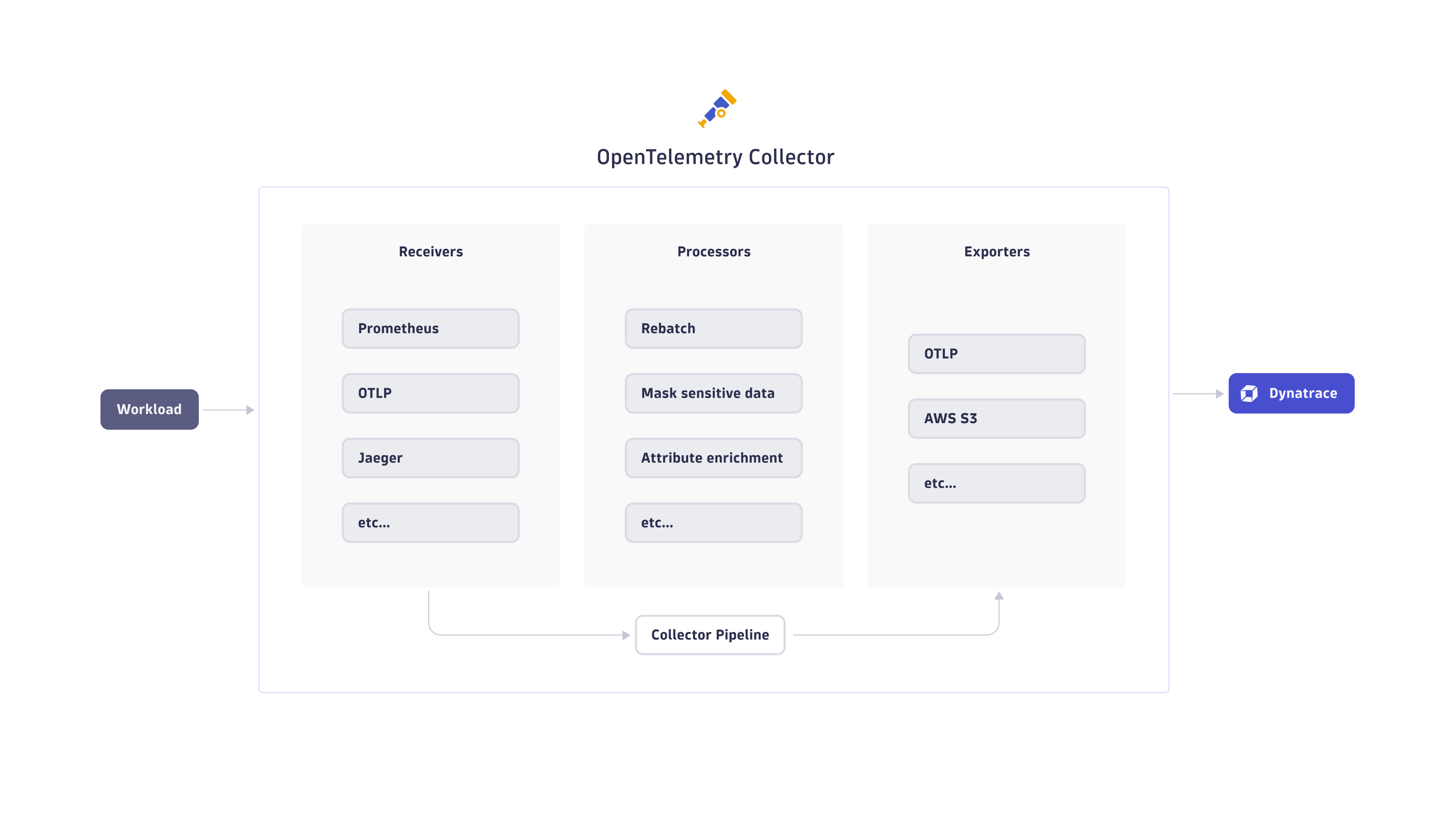

The OTel Collector (or just "Collector") is a network service application that you can use to batch and transform telemetry data. It acts as a proxy and can receive OTLP requests as well as data from other sources, transform these requests according to defined rules, and forward them to the backend.
The following diagram shows different components that the Collector can use to receive, process, and export telemetry data to Dynatrace.
The OTel Collector can receive, process, and export telemetry data to Dynatrace
OTel Collector pipeline
Advantages of using the Collector
