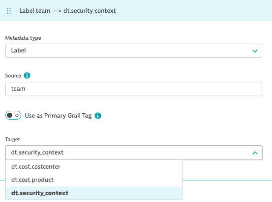

Go to Settings > Collect and capture > Kubernetes Telemetry Enrichment.
Select Add rule.

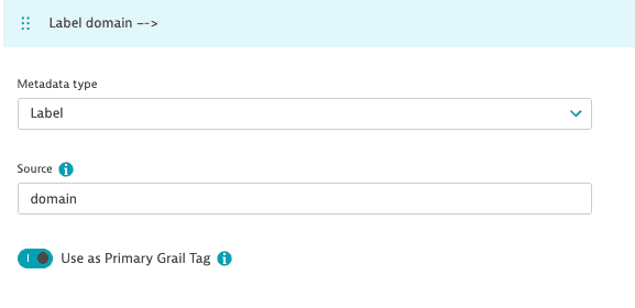

Select Annotation or Label in the Metadata type dropdown.
Enter the namespace annotation/label key in the Source field, following Kubernetes conventions:

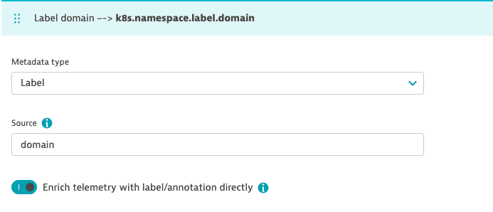

To use the key of the annotation or label as field name, turn on Enrich telemetry with label/annotation directly.
For remapping, turn off Enrich telemetry with label/annotation directly and choose a value from the Target dropdown.
Select Save changes.

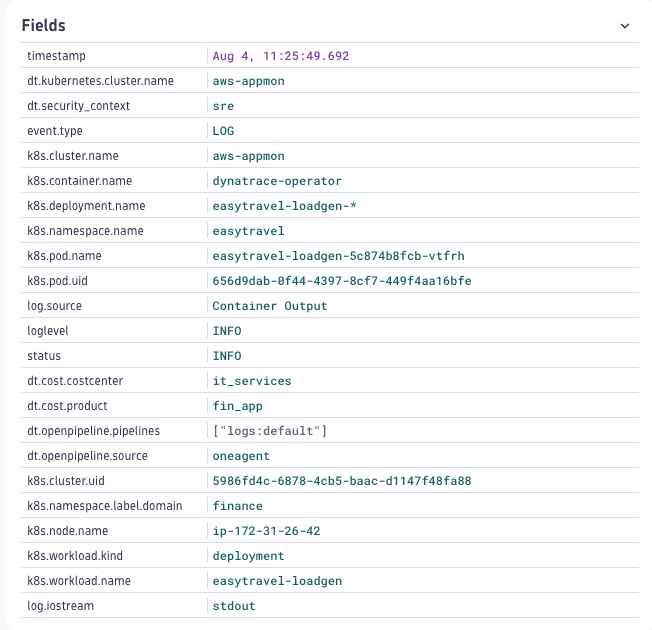

Navigate to your data and verify that the metadata is successfully enriched.

The following attributes will be enriched on the data:
dt.security_context: sredt.cost.costcenter: it_servicesdt.cost.product: fin_appk8s.namespace.label.domain: finance
