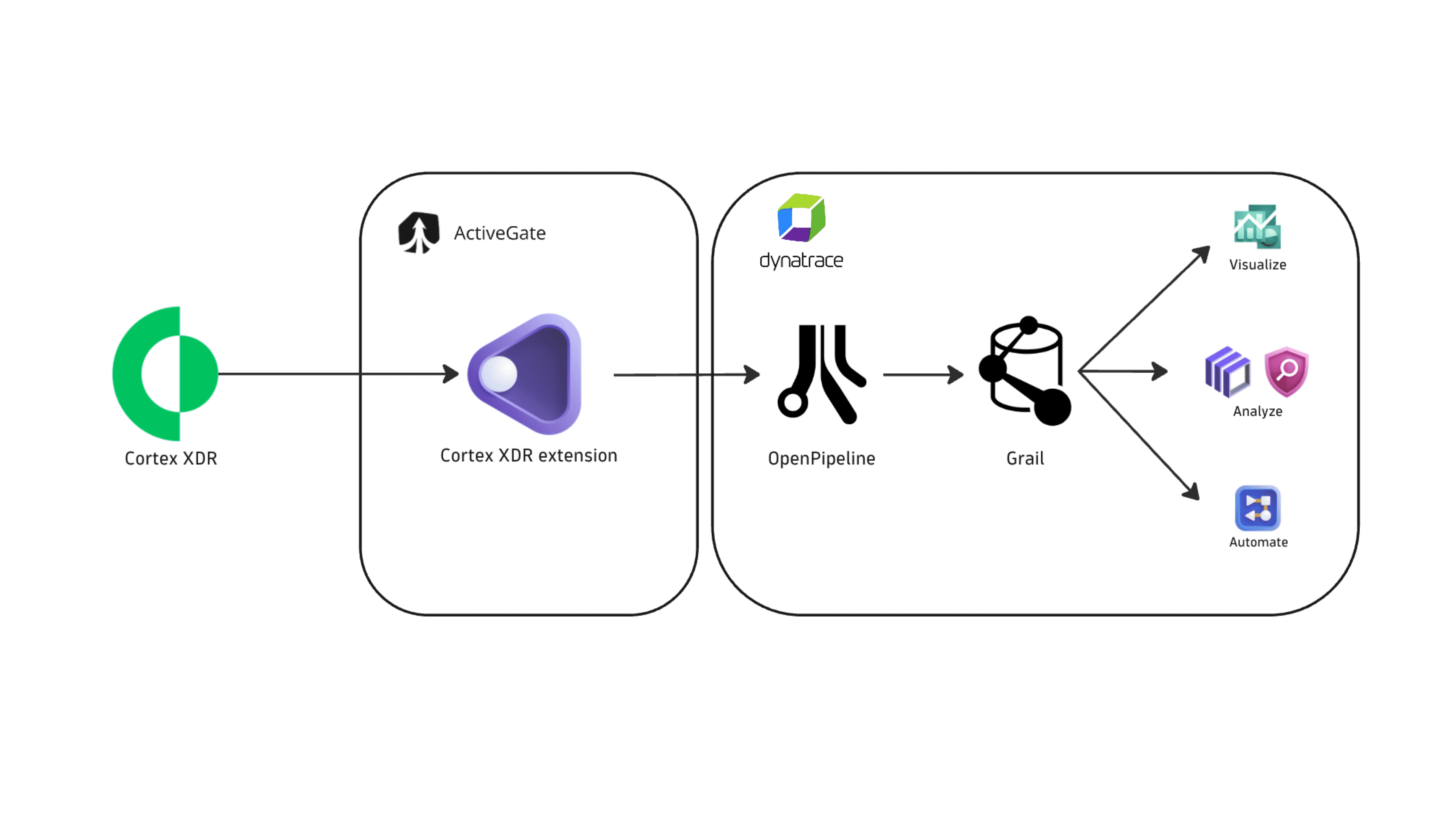

How ingest of Palo Alto Cortex XDR detection findings and audit logs works
The integration runs as an extension on Dynatrace ActiveGate. After you enable and configure the Cortex XDR extension:
  1. The extension periodically polls the Cortex XDR APIs for detection findings and, when enabled, management audit logs, based on the ingestion configuration.
  2. Dynatrace maps the fetched data to the appropriate Dynatrace Semantic Dictionary data models.
  3. Dynatrace stores the data in the default_securityevents bucket (for details, see Built-in Grail buckets).
