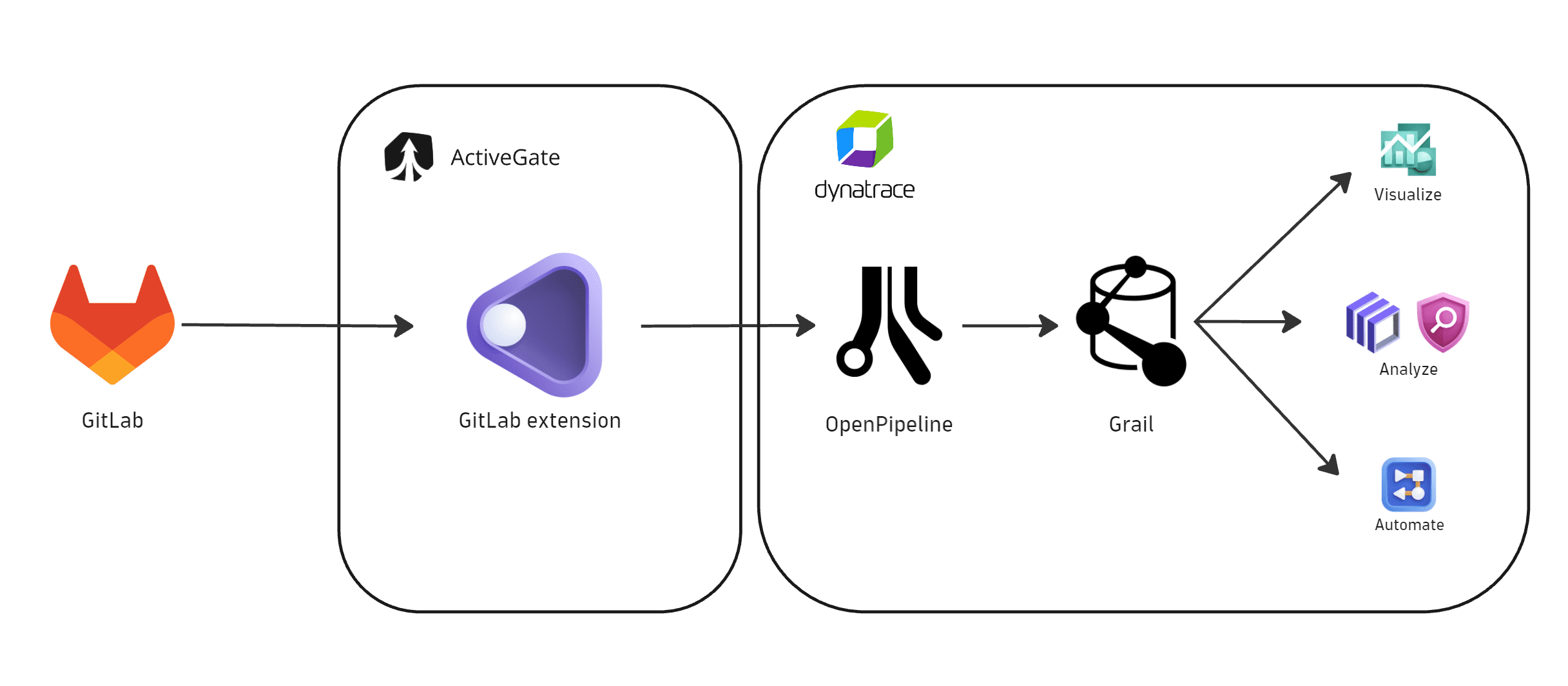

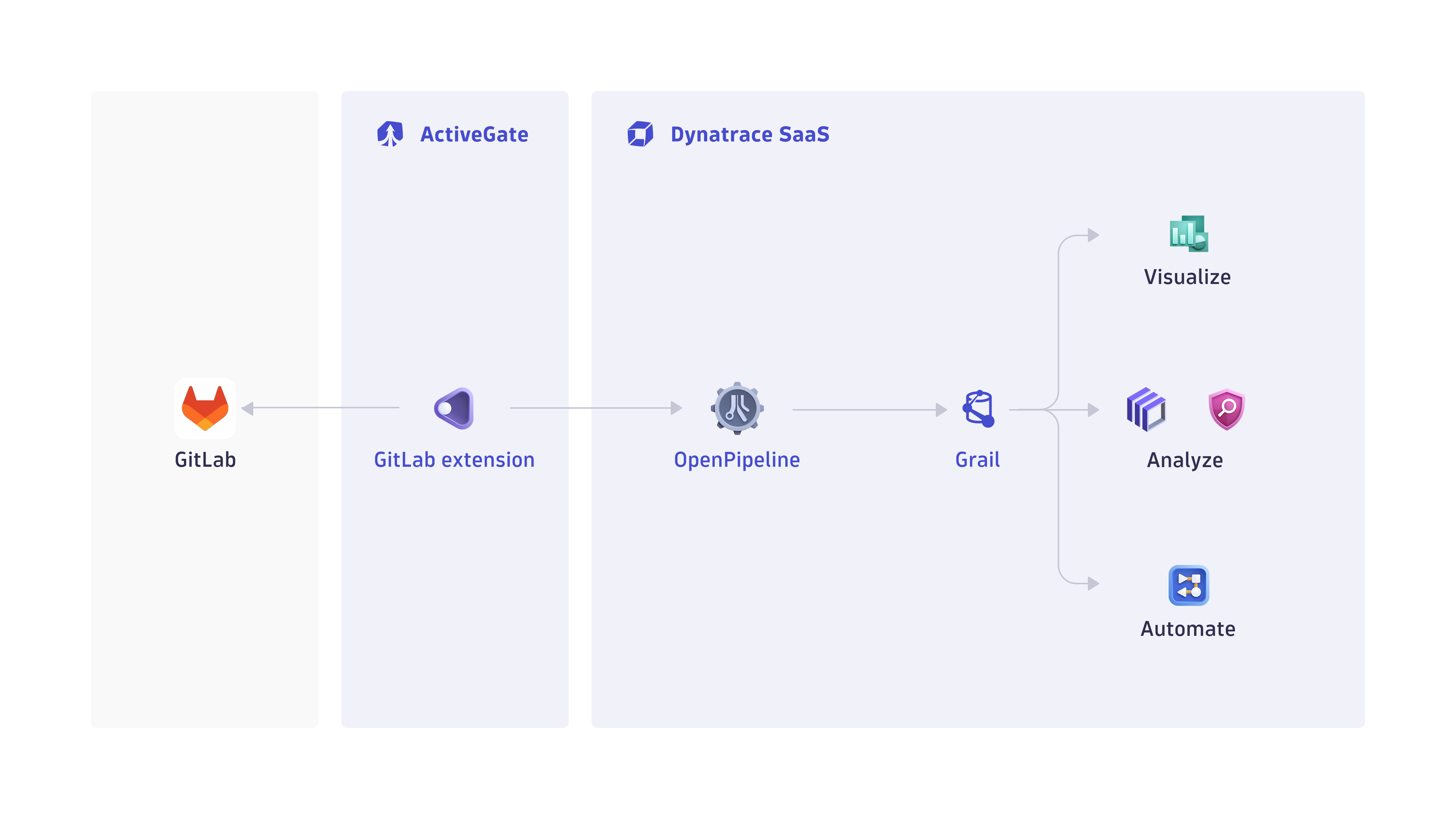

How it works
How the ingest of GitLab security findings and audit logs works
Dynatrace integration with GitLab is an extension running on Dynatrace ActiveGate. Once you enable and configure the Dynatrace GitLab extension:
  1. It periodically collects security findings and audit logs using GitLab APIs.
  2. The fetched data is ingested into Dynatrace and mapped to the Dynatrace Semantic Dictionary.
  3. Data is stored in a bucket called default_securityevents (for details, see Built-in Grail buckets).
