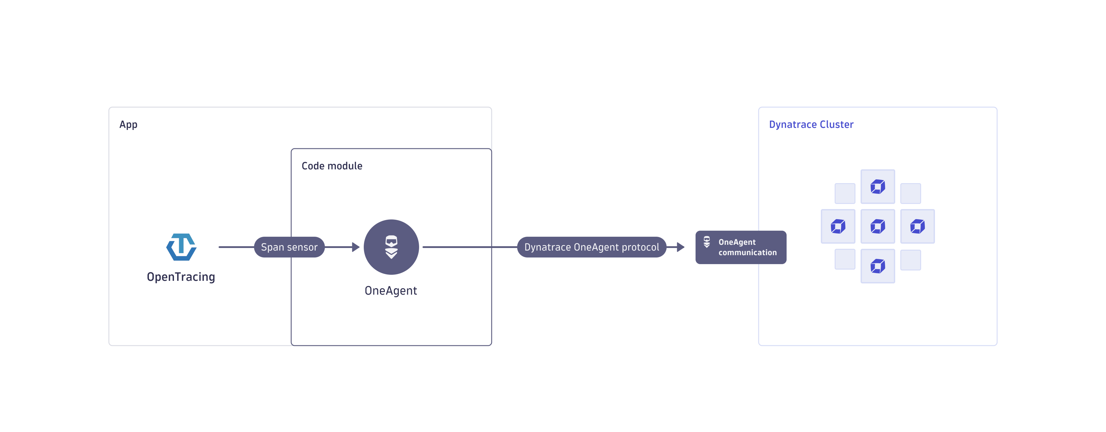

OpenTracing is an open source project that provides APIs and instrumentation for distributed tracing. Although OpenTracing and OpenCensus merged in 2019 to form OpenTelemetry, OpenTracing instrumentations are still used by many popular frameworks, libraries, and projects.
Dynatrace OneAgent for Java automatically collects OpenTracing span data and integrates it into end-to-end PurePath® distributed traces. OpenTracing with OneAgent enables you to:
  • Gain insights into Java third-party libraries or frameworks that aren’t natively covered by OneAgent but come with OpenTracing pre-instrumentation.
  • Enrich monitoring data with project-specific additions (for example, custom instrumentation that adds business data or the capture of developer-specific diagnostics points).
  • Stitch together independent, unrelated transactions to extend end-to-end distributed traces (for instance, by adding vendor-neutral custom instrumentation to gain business-process-specific or domain-specific end-to-end transactional insights).
OpenTracing support in OneAgent
The quality of the OpenTracing spans captured by OneAgent depends on the quality of instrumentation provided by the third-party library.
