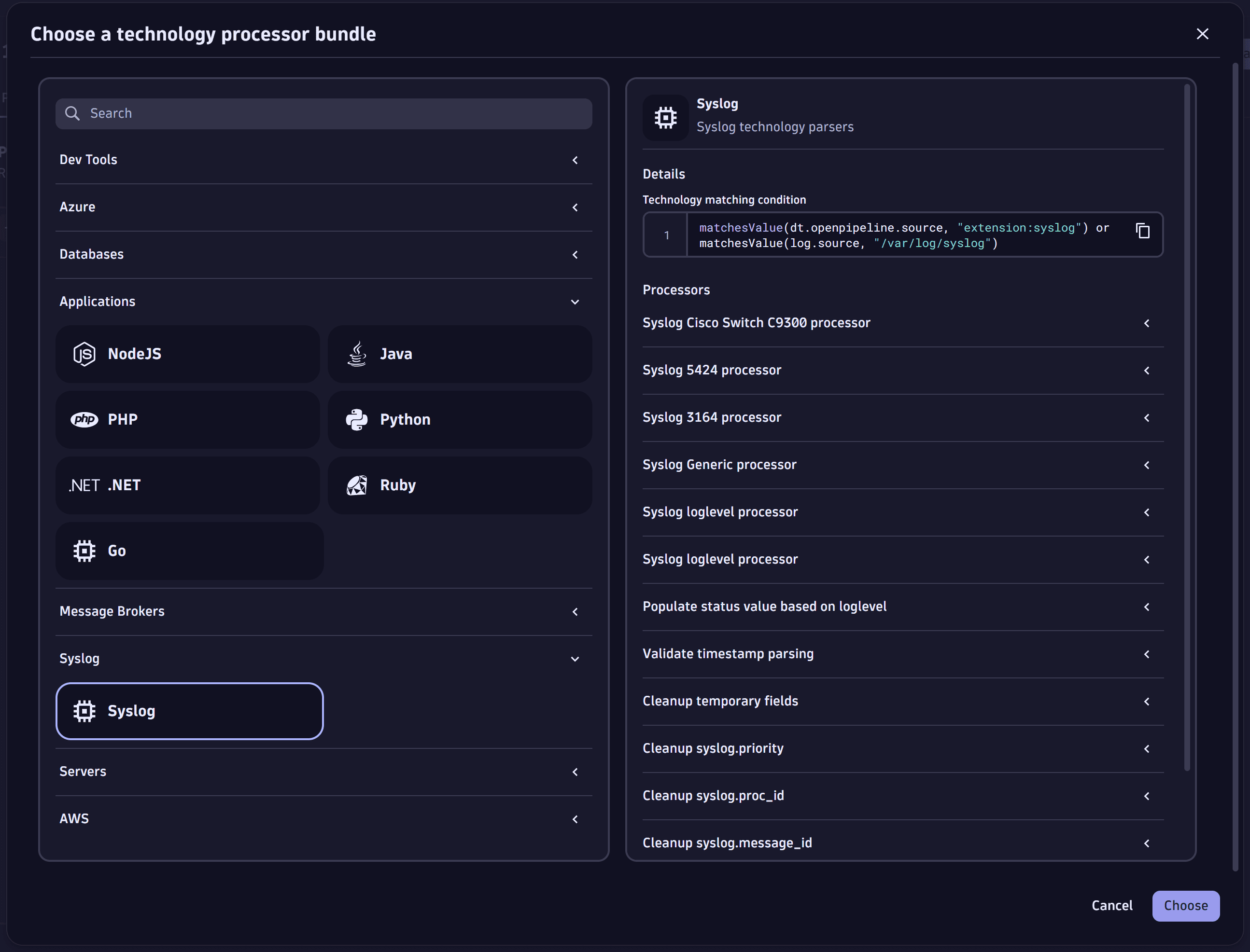

To fix this issue, use OpenPipeline to parse non-standard syslogs with the built-in Syslog technology bundle.
1. Create a pipeline for processing
  1. Go to Settings Settings > Process and contextualize > OpenPipeline > Logs > Pipelines.
  2. Select Pipeline, and enter a name for your new pipeline, for example, Non-standard syslog pipeline.
  3. Go to Processing > Processor > Technology bundle.
  4. From the list, select the Syslog technology bundle, and then select Choose in the lower-right corner of the page.
  5. Copy the technology matching condition under Details.
  6. Select Save.
You successfully created a pipeline and configured it with a processor to structure syslog entries using the Syslog technology bundle. The new pipeline is in the pipeline list.

  4. Place the new dynamic route in the correct position on the list.
  5. Select Save.
You successfully configured a new dynamic route. All syslog logs are routed to the pipeline for processing. The new route is in the route list.
To learn more about dynamic routing, see Route data.
3. Add custom attributes
Optional
You can enrich syslogs at ingest with custom attributes, allowing you to route different syslog streams to separate pipelines. For details, see Add custom attributes.
For additional instructions and information on analyzing structured logs, see Process logs with technology bundle parsers.
