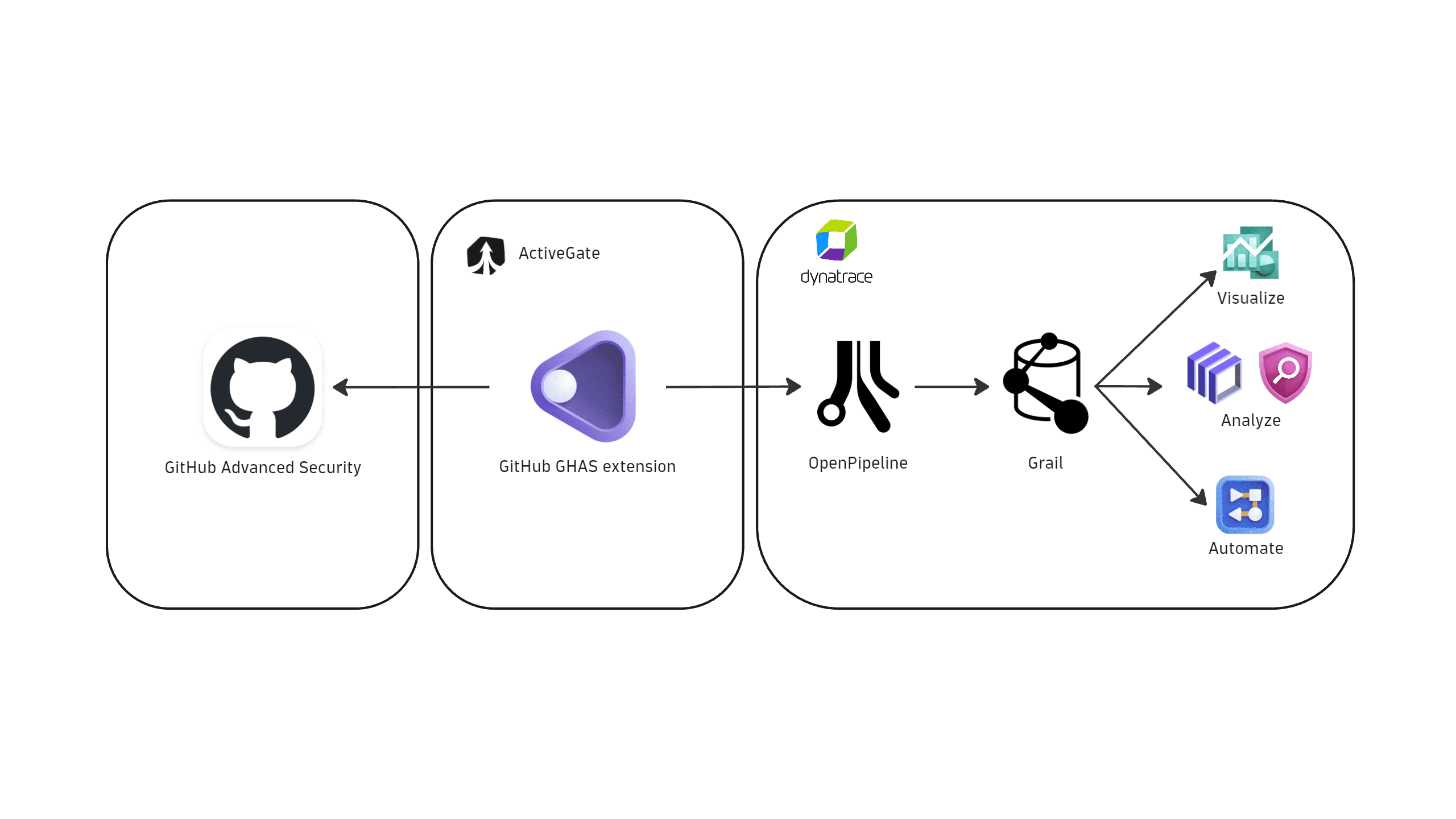

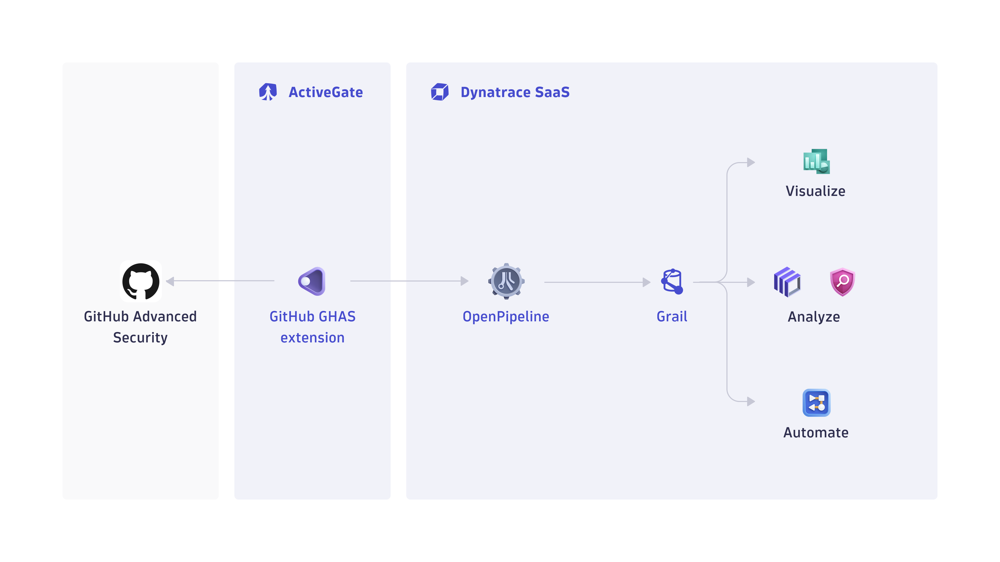

How it works
How ingest of GitHub Advanced Security works
1. Events and logs are collected from GHAS products
The Dynatrace GHAS integration is an extension deployed in a Dynatrace ActiveGate that periodically collects security findings and audit logs using the GitHub REST API.
2. Security findings and logs are ingested into Dynatrace
Security findings are ingested into the Dynatrace platform via a dedicated OpenPipeline security ingest endpoint.
3. Security findings and logs are processed and stored in Grail
The OpenPipeline ingest endpoint processes and maps the security findings according to the Semantic Dictionary conventions.
These are stored in a bucket called default_securityevents (for details, see: Built-in Grail buckets).
Optionally, the collected audit logs are ingested via a dedicated extensions log ingest pipeline and stored in the appropriate semantic format.
