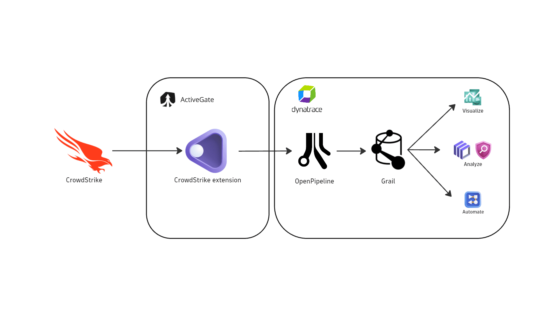

How it works
How ingest of CrowdStrike detection findings, threat intelligence, and audit logs works
The integration runs as an extension on Dynatrace ActiveGate. After you enable and configure the extension:
  1. It periodically polls the CrowdStrike APIs for detection findings, threat reports, and audit logs based on the ingestion configuration.
  2. Dynatrace maps the fetched data to the appropriate Dynatrace Semantic Dictionary data models.
  3. Dynatrace stores the data in the default_securityevents bucket (for details, see Built-in Grail buckets).
