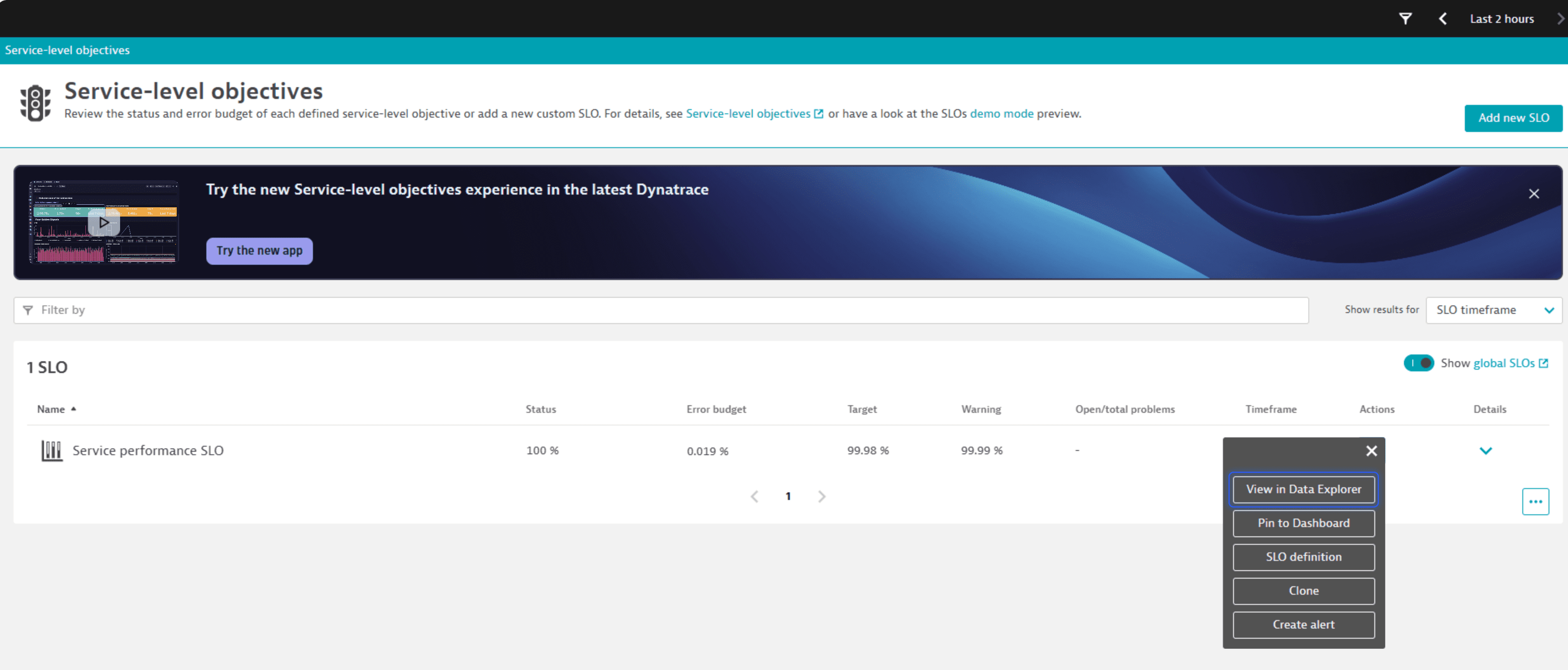

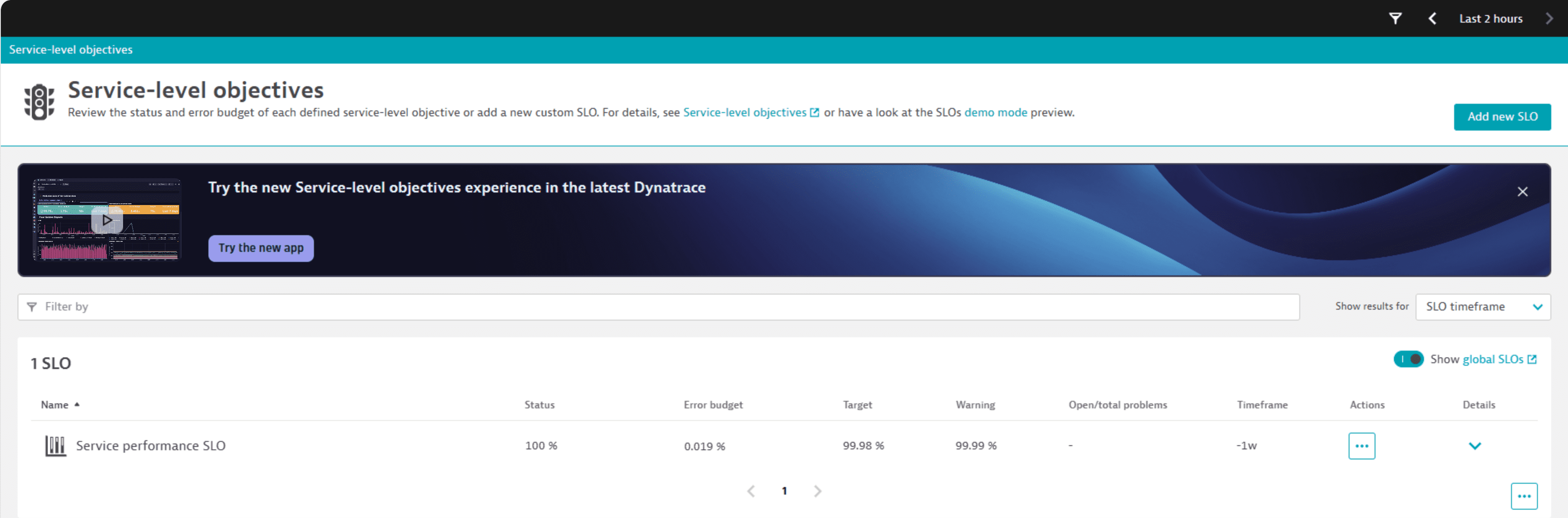

  1. Go to SLOs Classic Service-Level Objectives Classic.
    Service-Level Objectives Classic showing an SLO
  2. Select the SLO you want to upgrade.

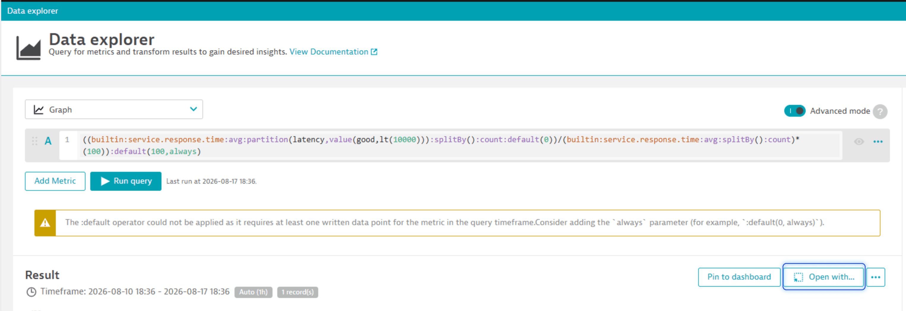

  3. From the Actions , select View in Data Explorer. The SLO opens in Data Explorer.
    Data Explorer opens with its own timeframe, so the Result value will not match the Classic SLO.
    	Data Explorer view after opening an SLO

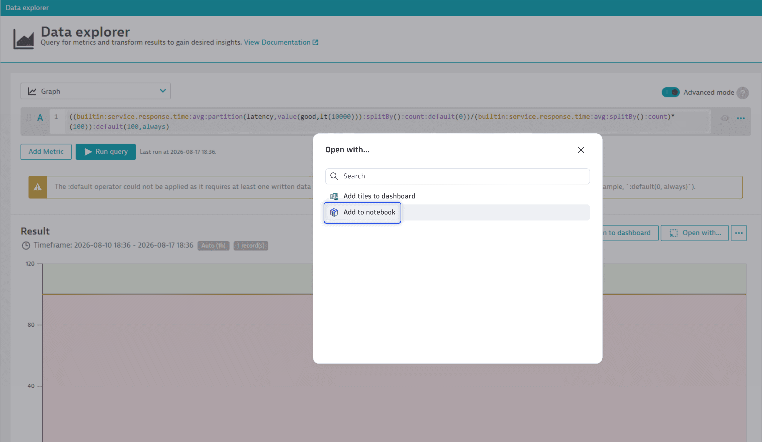

  4. Select Open with… > Add to notebook.
    Data Explorer showing the Open with options
    Data Explorer showing the Add to notebook option
    The SLO opens in Notebooks Notebooks.

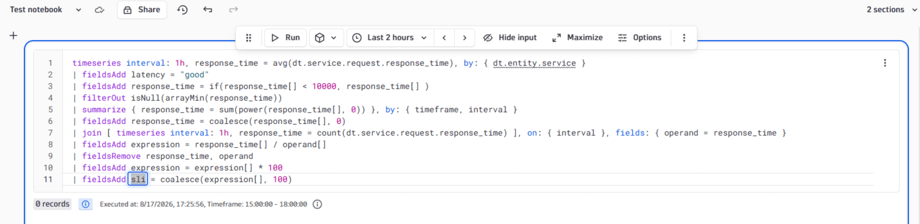

  7. Required In Notebooks Notebooks, go to the last line of the DQL query, and rename the result field to sli. The SLO requires the query to return a field named sli.
    Notebook with the DQL query, highlighting where expression was changed to sli
  8. Copy the DQL query from the notebook.

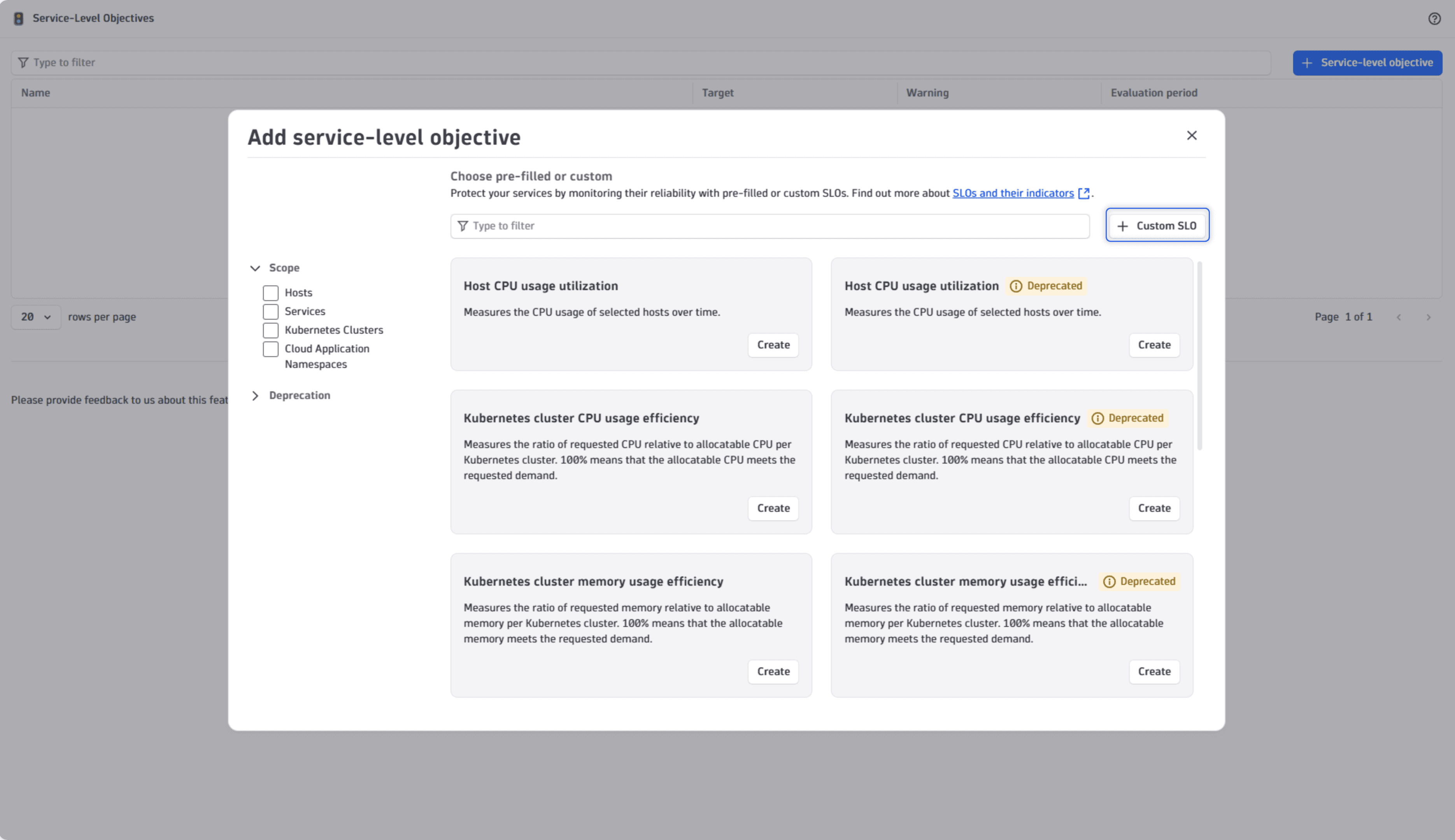

  9. Go to SLOs Service-Level Objectives.
  10. Select Service-level objective.
  11. Select Custom SLO.
    Service-Level Objectives showing the Custom SLO button
  12. In the Critical services or entities tab, paste the DQL query in the Custom DQL field. In this step, management zones become segments.
