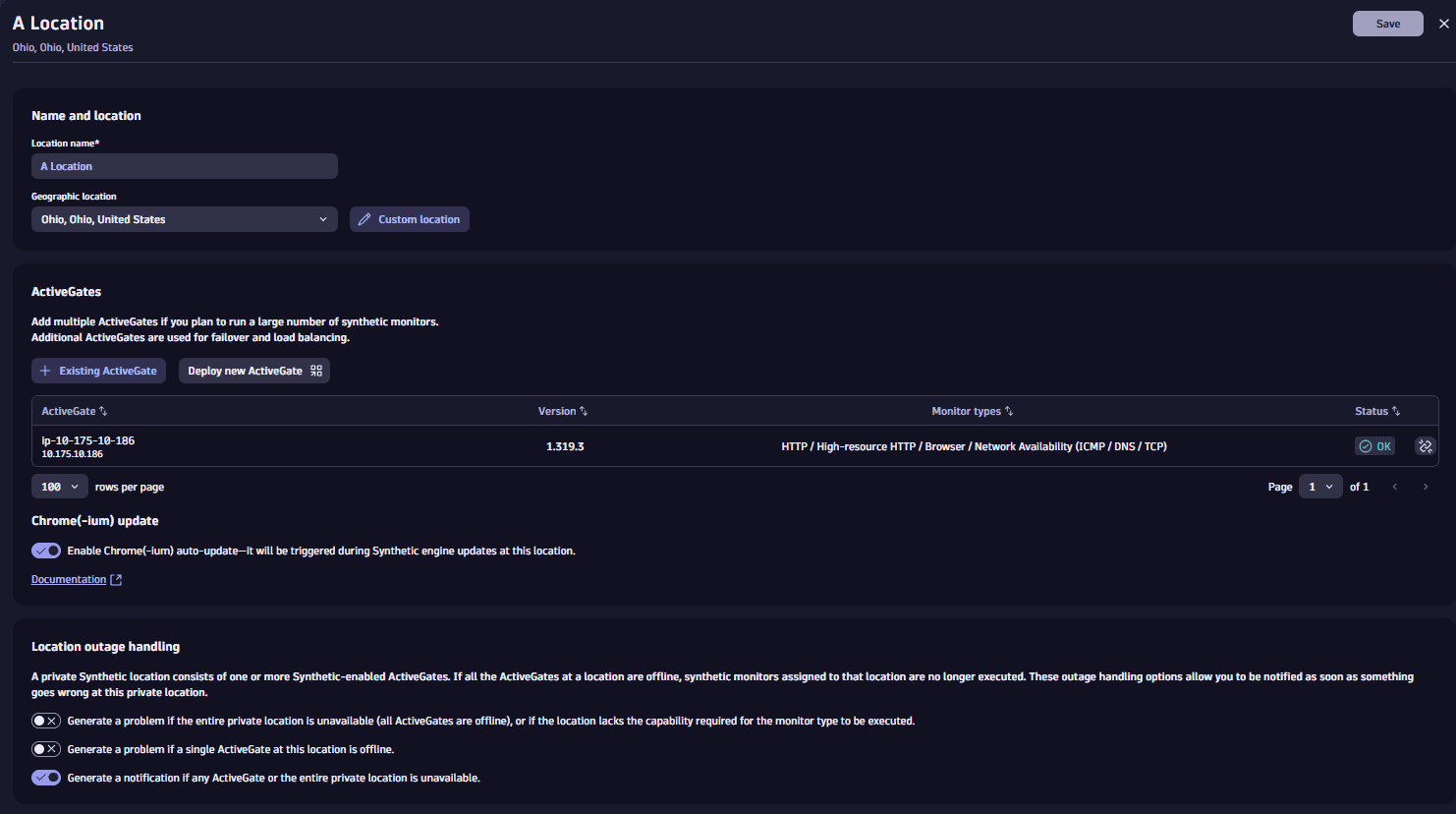

Create a private location
To add a classic private location
  1. Go to the Private locations tab in the upper-left corner of the Synthetic Classic Synthetic home page.
  2. Select New private locations > Classic.
  3. Name your location.
  4. Map it from an existing geographic location or add a custom location defined by Country, Region, City, Latitude, and Longitude.
  5. Select Existing ActiveGate to add an existing Synthetic-enabled Activegate to the location or Deploy new ActiveGate to deploy a new one (deploying a new ActiveGate will redirect you to Discovery & Coverage Discovery & Coverage from where you can install an ActiveGate).
    Add multiple ActiveGates if you plan to run a large number of synthetic monitors. Additional ActiveGates are used for failover and load balancing.
    • We recommend using at least two ActiveGates for a location.
    • You can't use one ActiveGate for multiple locations.
  1. Optional Turn on Enable Chromium auto-update—it will be triggered during the Synthetic engine updates at this location.
    You can Enable Chromium auto-update at the location level, that is, for all ActiveGates assigned to a private location. Chromium autoupdate takes place during manual as well as automatic ActiveGate and Synthetic engine updates.
    As we recommend using the latest supported Chromium version for the smooth and secure execution of browser monitors from your private location, Chromium autoupdate is turned on by default for locations with Linux-based ActiveGates. If you don't want Chromium to be updated automatically, for example, to use a specific version of Chromium, or if you have offline environments, turn off the switch before triggering an ActiveGate update.
    This setting only applies to Linux-based ActiveGates; on Windows-based ActiveGates, Chromium is always updated during Synthetic engine updates. If your location has only Windows-based ActiveGates, the toggle is turned on but grayed out.
    Successful Chromium autoupdate requires access to OS (system) repositories for Chromium dependencies and access to https://synthetic-packages.s3.amazonaws.com for Chromium components. If you've enabled a custom local repository, Chromium components (but not dependencies) need to be available at the specified HTTP server address. See Chromium autoupdate from a custom repository.
    You will see a message if Chromium autoupdate fails for this or other reasons—we recommend either meeting the requirements for autoupdate (such as access to repositories) or disabling Chromium autoupdate for your private location.
    Also, check our information on installing Chromium and other dependencies manually (Linux only).
  2. Optional If you have outage issues with your private location, use the Location outage handling options to receive related notifications. See the on-screen instructions for details.
    • You can configure the location to generate a problem when the entire private location is unavailable (all ActiveGates are offline), or if the location lacks the capability required for the monitor type to be executed.
    • You can configure the location to generate a problem when a single ActiveGate at this location is offline.
    For example, suppose your location has two ActiveGates, and you enable both problem switches. You will see three problems when your location is unavailable—one for the entire location and one for each ActiveGate that's offline.
    Containerized locations
    For containerized locations, you can only generate a problem when the entire private location is unavailable (all ActiveGates are offline), or if the location lacks the capability required for the monitor type to be executed.
  3. Select Save.
