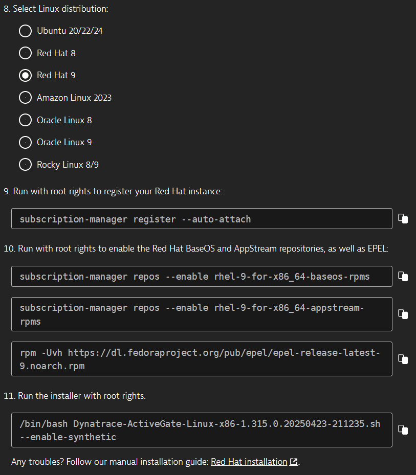

  11. Linux only Select a Linux distribution.
  12. Run the installer and any other commands—make sure you use the exact commands displayed in the UI.
    Linux only The installer automatically downloads the browser and dependencies required by the Synthetic engine. On Red Hat, Oracle Linux, and Rocky Linux you also need to enable repositories from which the installer downloads the dependencies. As a prerequisite for enabling proprietary repositories on Red Hat, you need to register your Red Hat instance. The web UI provides you with all the required commands for doing so, as shown in the example below.
    Commands to install ActiveGate on Red Hat 9
