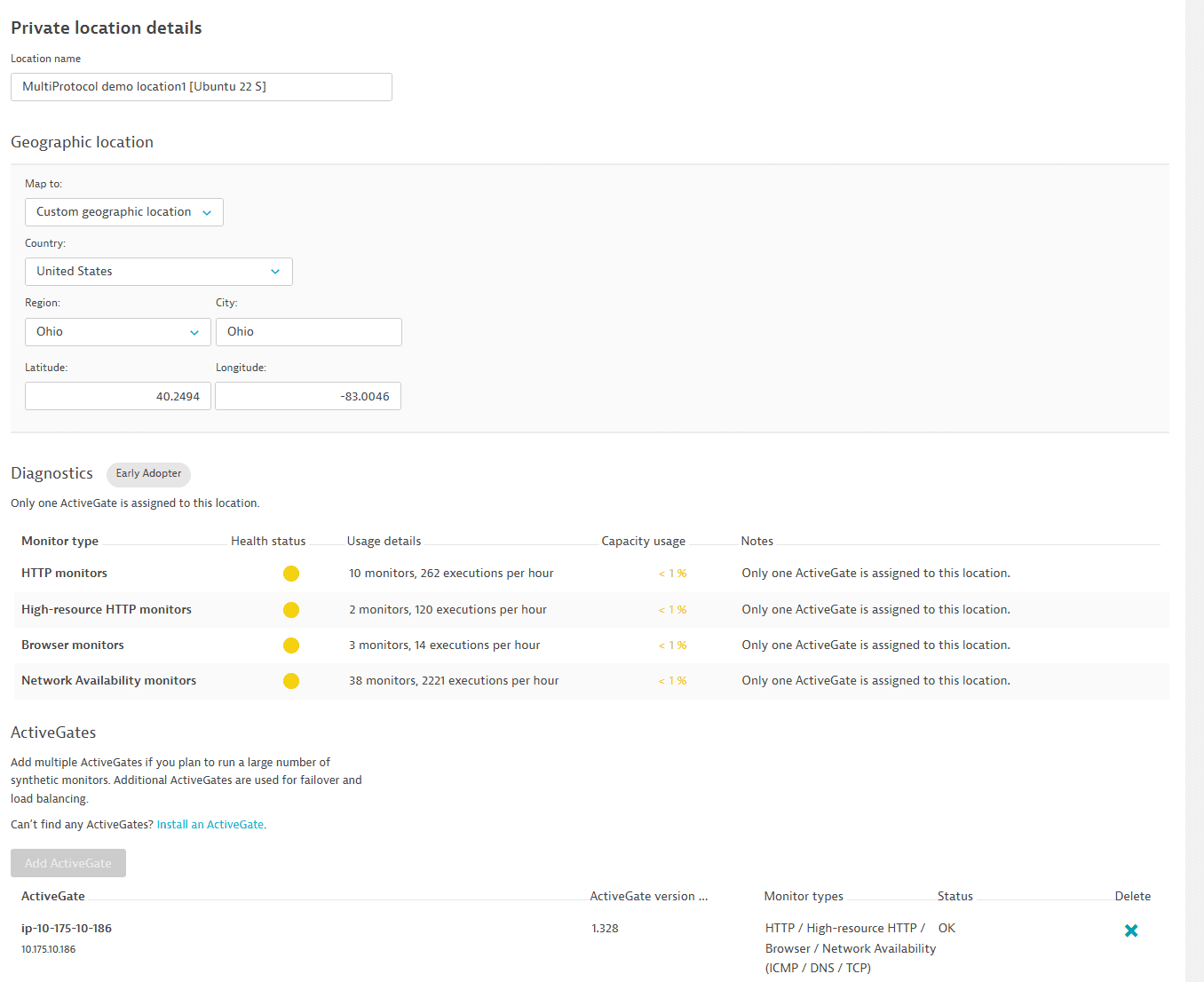

Select a location to see the breakdown of its overall status into capacity usage per monitor type. For each of these monitor types, you can see the number of monitors and hourly scheduled executions as well as the capacity use percentage.
  • HTTP monitors
  • High-resource HTTP monitors
  • Browser monitors
  • Network Availability monitors
You can't see usage data per monitor type when all ActiveGates or Synthetic engines at a location are down.
The ActiveGates assigned to the location are listed and displayed in red when a Synthetic engine or an ActiveGate itself is offline; the Status column shows a corresponding message. You can add or delete ActiveGates from here. Note that the Add ActiveGate button is disabled when no ActiveGates are available to be assigned to a location—you can check for this in Deployment Status.
Private location details in previous Dynatrace

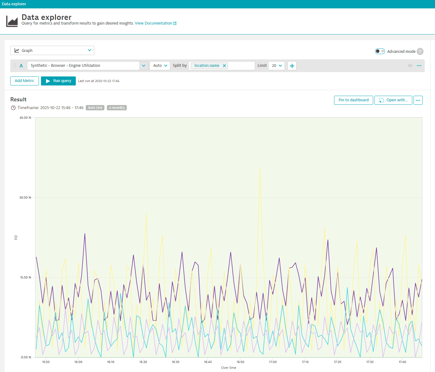

Metrics for the health status of each monitor type are available for charting and alerting. For example, choose the Synthetic - Browser - Engine Utilization metric in the Metrics browser or Data Explorer. We strongly recommend splitting these metrics by location to get an accurate view of location health.
Synthetic monitors metrics in Data Explorer Classic
