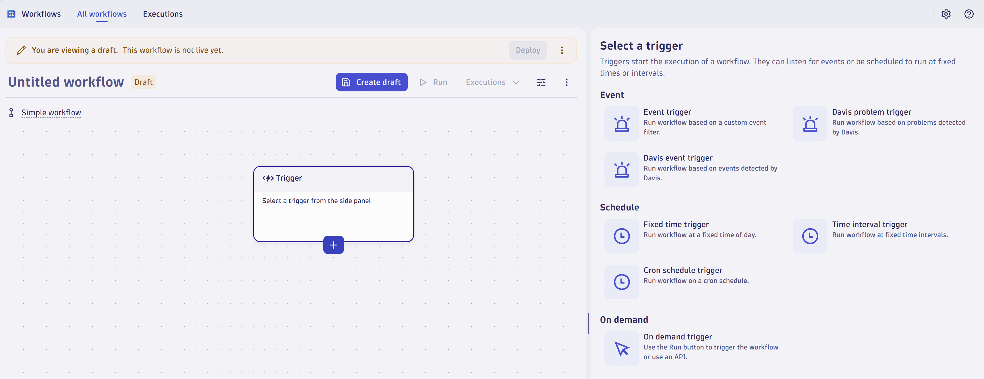

    The workflow editor opens.
    Screenshot of an Empty workflow editor.
  4. Select the workflow title. It is by default: Untitled workflow, and enter a custom name such as Quick Start.
    Rename workflow
    Rename workflow
  5. In the Select a trigger pane on the right, scroll down and select On demand trigger. We are going to create a workflow that you run manually via the web UI or REST API.
    Select "On demand trigger"

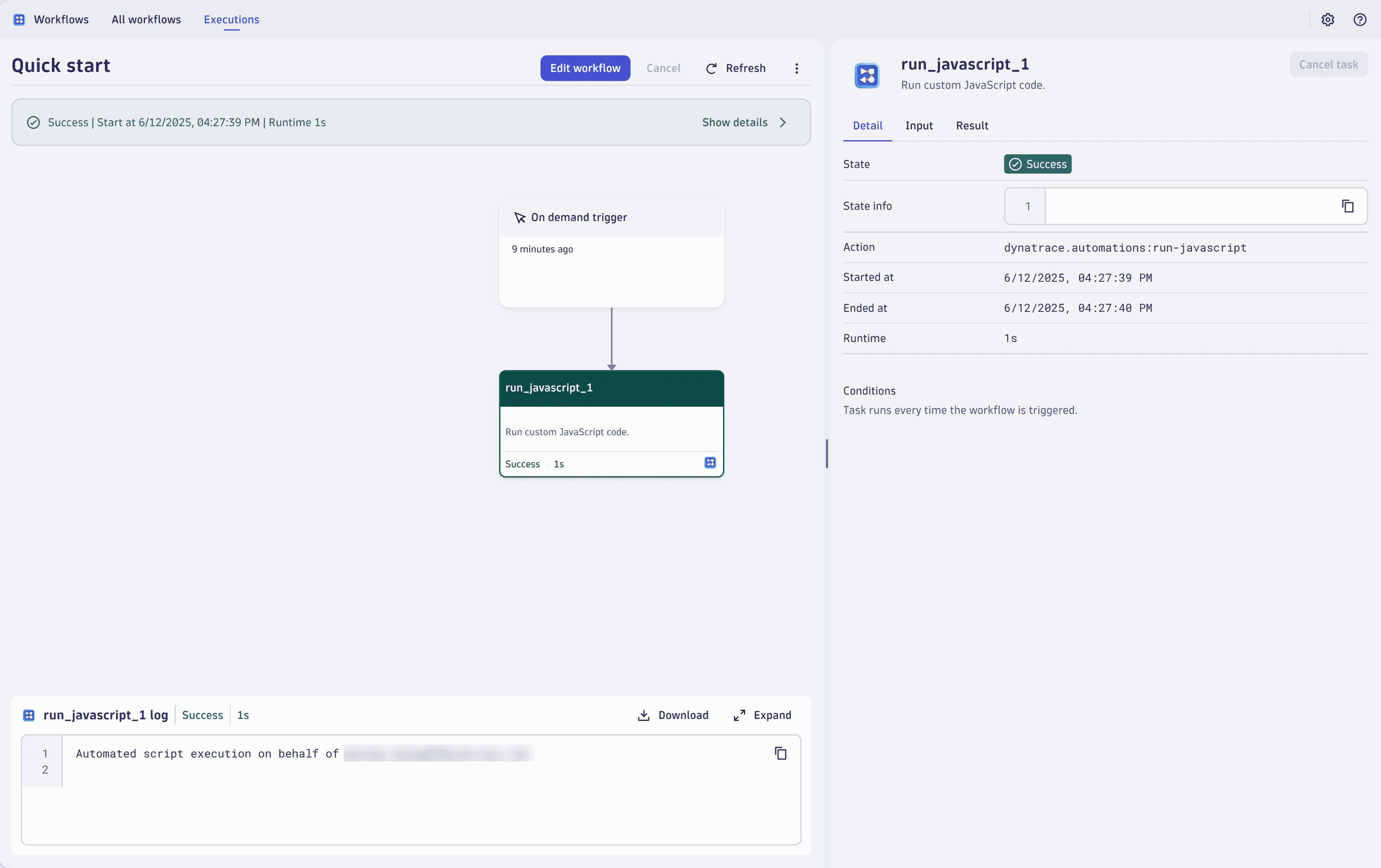

  8. Select Run to execute the draft workflow. This step also saves your draft.
    Run the current workflow
    The first time you run a workflow, you are prompted to authorize the automation service to run a workflow as your user. Select Allow and run if you agree with that. You can always restrain the configuration in the settings.
    Error?
    If you get a "forbidden" error when you run your workflow, check your authorization settings.
    1. In the upper-right corner, select Settings > Authorization settings.
    2. Verify that you have all required permissions.
    3. Run the workflow again.
    The app switches to the workflow monitor, which is a live view of the execution you just started.
    • This view automatically refreshes until the execution reaches a final state.
    • The right pane shows details of the execution.
      • While the workflow is executing, you should see State set to Running.
      • When the execution is finished, you should see State set to Success.
      • If you don't get Success, State info will tell you why.
    • You can inspect the details of individual tasks by selecting them in the graph as shown below in the screenshot.
      Screenshot of the Quick start workflow JavaScript task details.

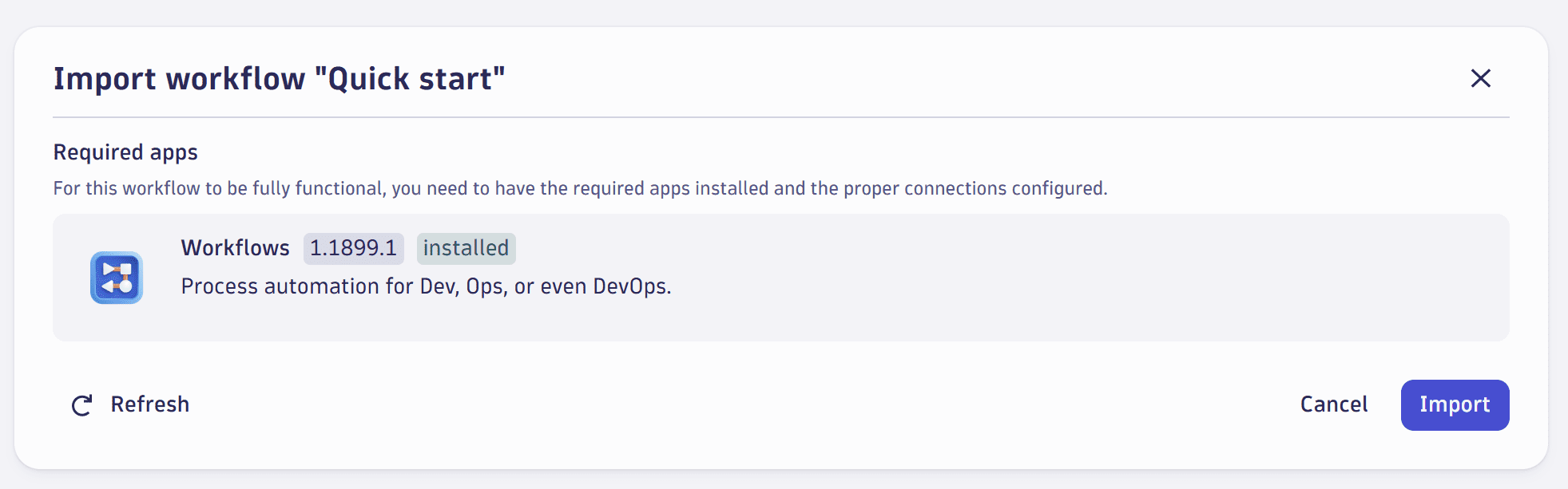

  5. In Dynatrace Workflows Workflows, select Upload.
  6. Select quickstart.yaml.
  7. Select Import.
    Screenshot of Import workflow dialog.
    You have uploaded the Quick Start workflow to your Dynatrace tenant. You can make edits, run it and deploy it.
