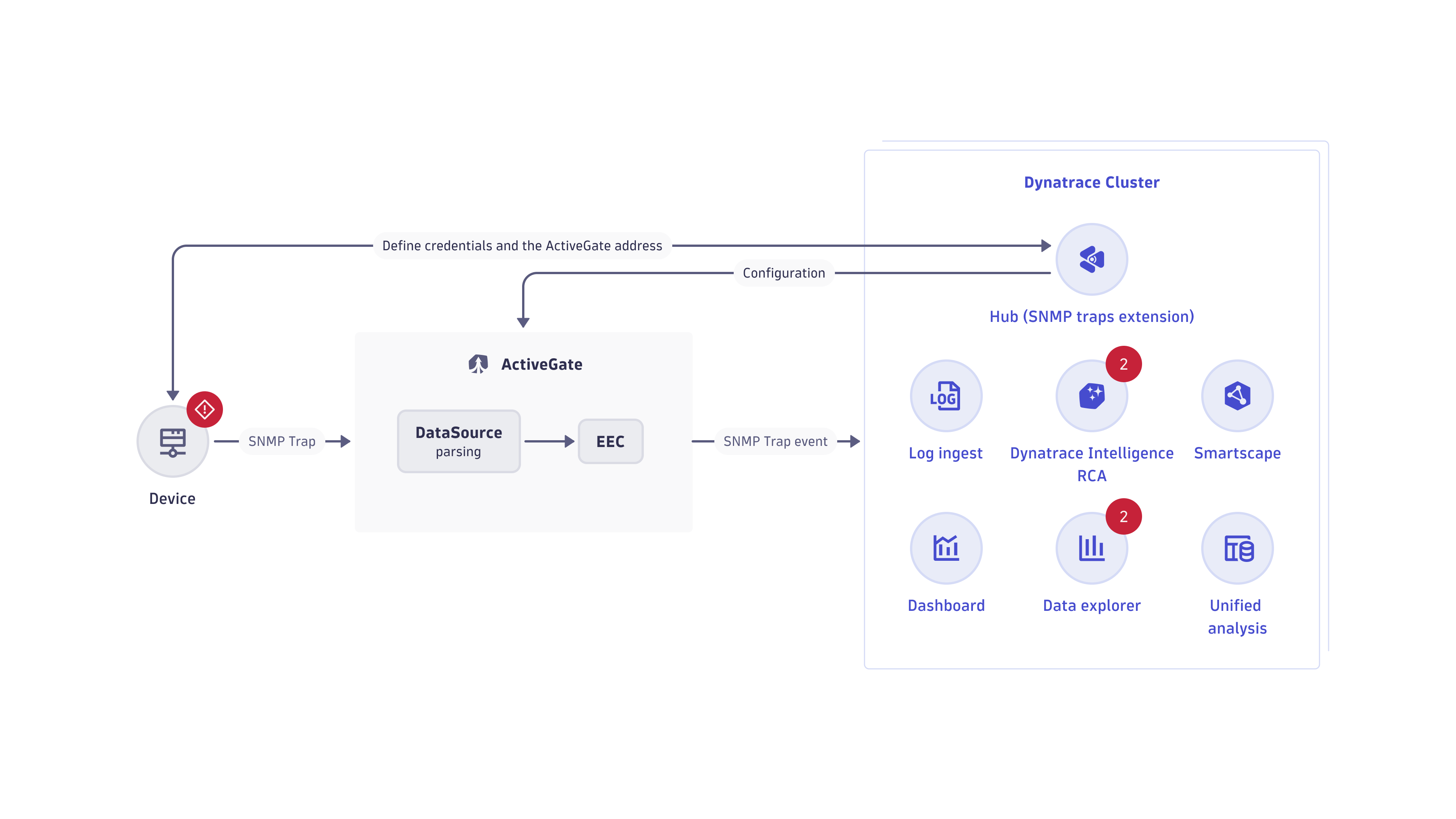

How SNMP Traps data source works

Events
Trap events send detailed information about each trap to the log ingest. The trap message contains the following information:
