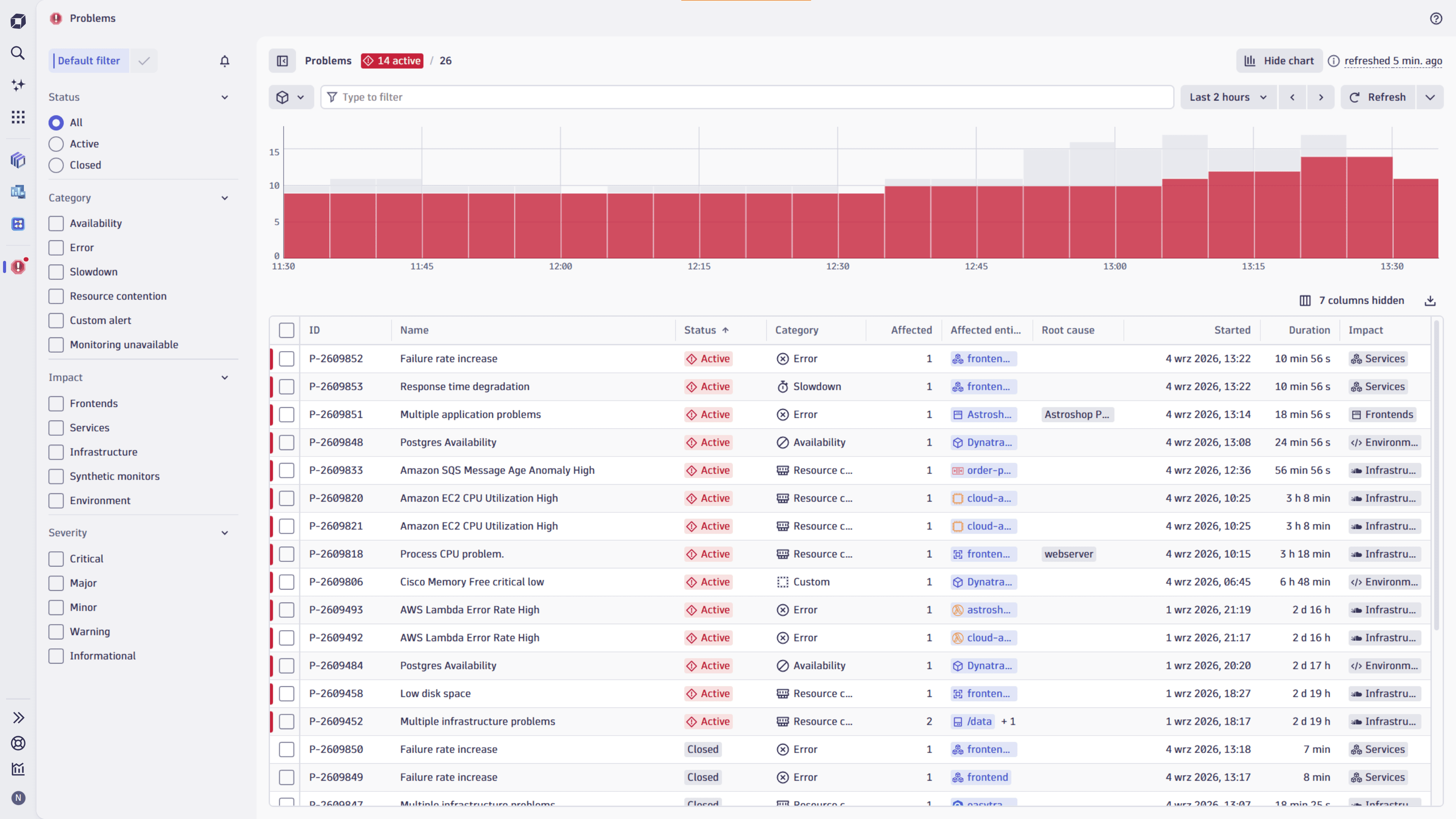

Investigate and remediate active problems
Set focus and triage
By default, Problems app - new Problems shows:
  • A feed of all problems in the last 2 hours. To help operation teams spot open problems regardless of which filter is set, open problems remain on top of the feed no matter how long they are open.
  • A problem chart at the top visualizes any abnormality with a high number of problems in the past. Select a peak on the chart to drill into it and investigate further.
An example of the Problems app problem feed view
Filtering
To focus on your domain and triage problems that affect it, set filters. The three most common filters—Status, Category, and Impact—have selectable settings to the left of the table for quick access. Your selections there automatically add the corresponding filters to the filter bar above the table.
To set other filters, enter them directly in the filter bar.
  • Status—Can be Active or Closed.
    • If this is not set, all problems (active or closed) are listed.
    • If you select a status in the controls on the left, the corresponding filter is also displayed in the filter bar.
  • Category—Indicates the nature of the incident, such as slowdowns, errors, resource-related issues, or availability incidents.
    • If you select one or more categories in the controls on the left, the corresponding filters are also displayed in the filter bar.
  • Impact—Indicates the type of the impacted area, such as frontends, services, infrastructure, or environments.
    • If you select one or more impact areas in the controls on the left, the corresponding filters are also displayed in the filter bar.
Problems are also classified by a severity level (Critical, Major, Minor, Warning, and Informational). You can filter by severity in the filter bar or select it in the left sidebar. To understand how Dynatrace assigns and manages severity levels, see Standardized event severity concept.
Filtering with the filter bar allows you to focus your feed on problems based on multiple criteria, such as status, number of affected entities, root cause entity, and more. Place your cursor in the input field to see all the available options. By default, filtering criteria are combined by the AND logic. For each criterion, Dynatrace Intelligence provides a list of suggested values, based on your problem feed.
For example, to see problems that are raised due to an increase of JavaScript errors and that persist for longer than 1 hour, use the following filter criteria:
