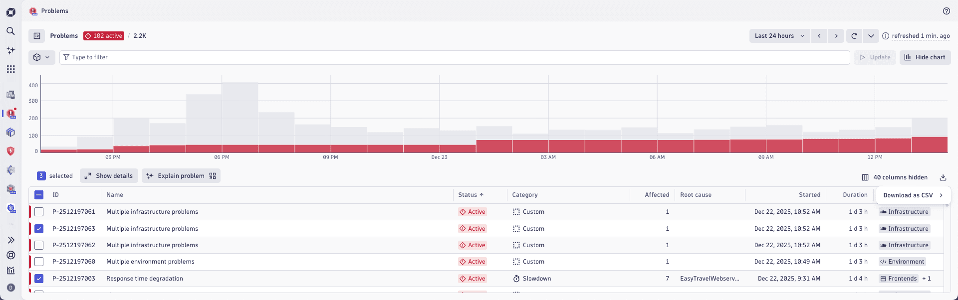

By default, Problems app - new Problems shows:
  • A feed of all problems in the last 2 hours. To help operation teams spot open problems regardless of which filter is set, open problems remain on top of the feed no matter how long they are open.
  • A problem chart at the top visualizes any abnormality with a high number of problems in the past. Select a peak on the chart to drill into it and investigate further.
Problems app - problem feed view

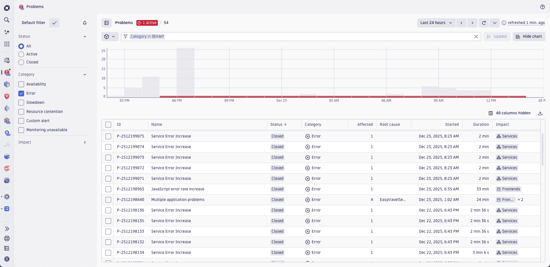

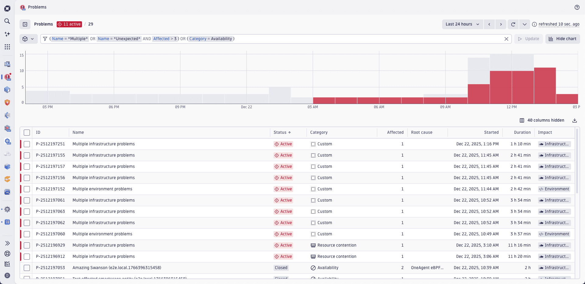

Filtering
To focus on your domain and triage problems that affect it, set filters. The two most common filters—Status and Category–have selectable settings to the left of the table for quick access. To set other filters, use the filter bar above the table.
  • Status—Can be Active or Closed.
    • If this is not set, all problems (active or closed) are listed.
    • If you select a status in the controls on the left, the corresponding filter is also displayed in the filter bar.
  • Category—Indicates the nature of the incident, such as slowdowns, errors, resource-related issues, or availability incidents.
    • If you select one or more categories in the controls on the left, the corresponding filters are also displayed in the filter bar.
Filtering with the filter bar allows you to focus your feed on problems based on multiple criteria, such as status, number of affected entities, root cause entity, and more. Place your cursor in the input field to see all the available options. By default, filtering criteria are combined by the AND logic. For each criterion, Dynatrace Intelligence provides a list of suggested values, based on your problem feed.
For example, to see problems that are raised due to an increase of JavaScript errors and that persist for longer than 1 hour, use the following filter criteria:
  • Status=ACTIVE
  • Duration>1h
  • Category=Error
  • Name=JavaScript error rate increase
The problem filter bar supports Boolean logic filters. This allows you to combine AND and OR criteria and create complex filters using parentheses to group Boolean terms. You can see a Boolean logic filter statement within Problems app - new Problems app in the example below.
Powerful Boolean Filters within the Problems Filter Bar.

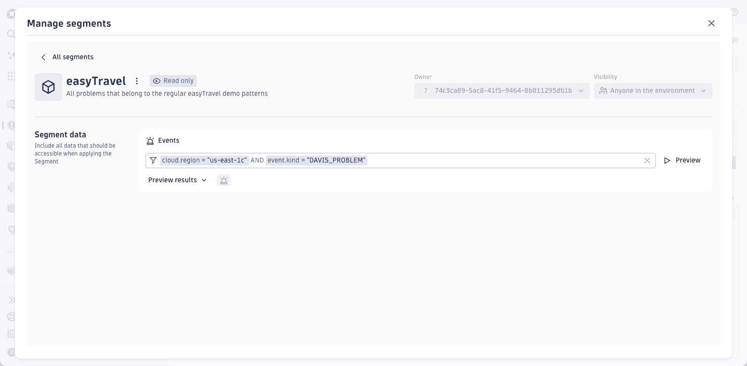

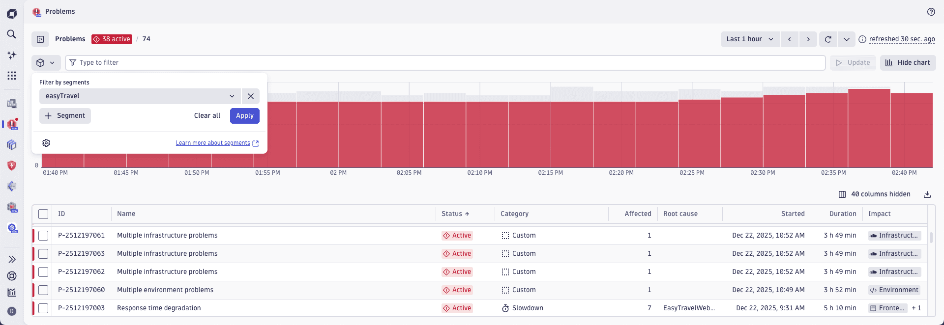

Leverage predefined Team Segments to increase operational productivity
Segments are predefined filters used for quickly filtering the data to include only the relevant entries. In the context of Problems app - new Problems, you or your team can utilize a predefined set of team-specific segments to filter your problem tables instead of having to create your own problem filters.
The following example shows how to use segments to filter problems connected to easyTravel.
Filter by segments in the Problems app.
In addition, using segments in Problems app - new Problems allows you to:
  • Create sets of filters that can be reused by you and shared to the whole team.
  • Save time on recreating filters applied during the previous sessions.
  • Increase productivity by quickly filtering relevant problems.
  • Quickly check the status of your service by creating and applying service-specific segments.
Since problems are stored as events in Grail, segments created for filtering problems must define an event filter. For example, if you want to filter problems that were raised in a specific cloud region, you can create a segment with the following event filter:
cloud.region = "us-east-1c" AND event.kind = "DAVIS_PROBLEM"
Screenshot example of defining a segment for Problems filtering
An example of defining a segment for filtering problems in the Problems app.
Segment filters are directly applied to the problem Grail records. Consequently, no entity filters are applied to the problem unless the entity ID is chosen as a primary field of the filtered problem.
For more information on segments and how they work, see Segments Segments.

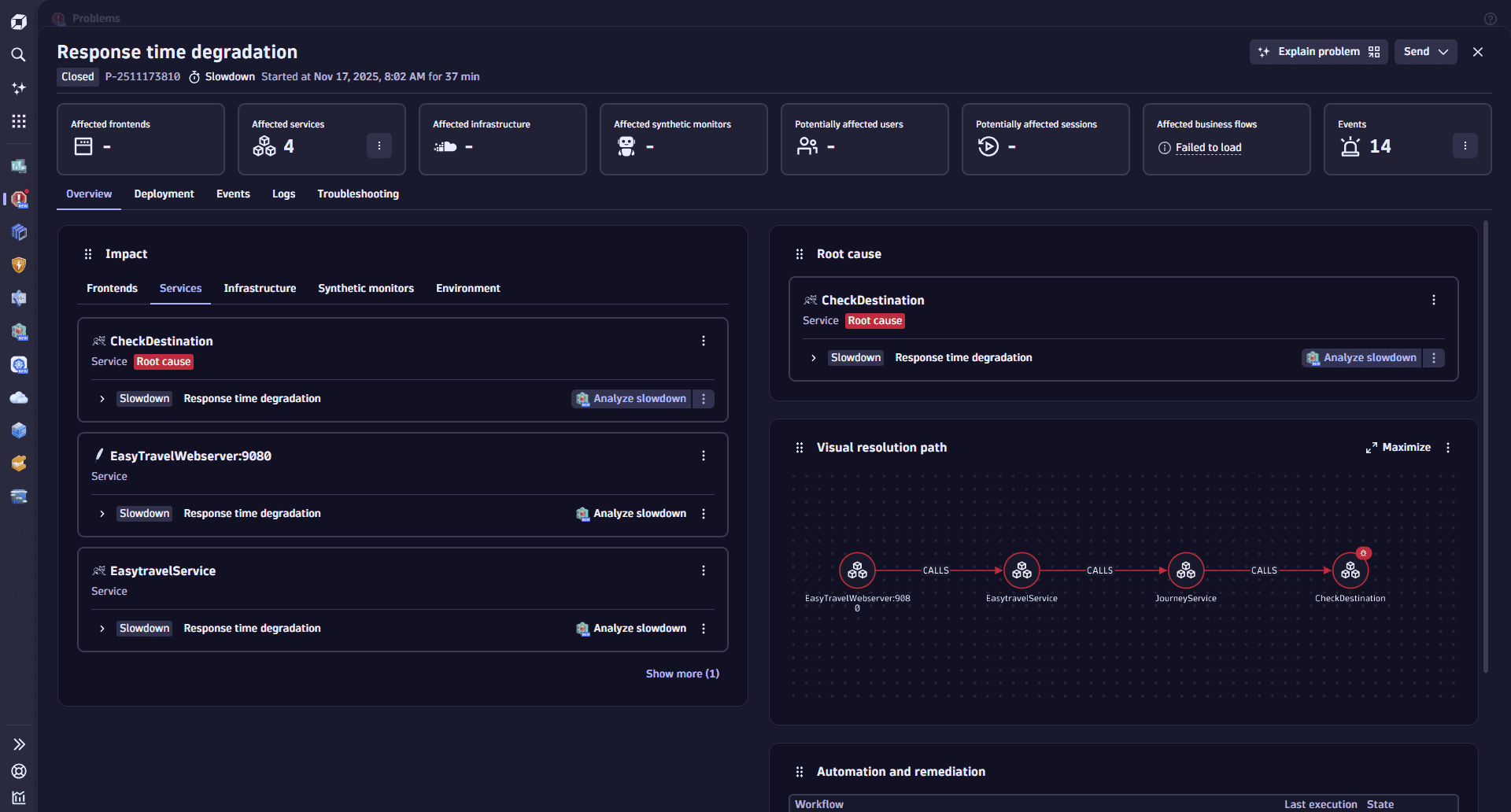

To see the details of a problem
  1. In the table, select the problem ID in the ID column.
  2. Review the details page.
The problems details page provides all available details about the problem, highlighting the root cause entity with a red mark, to guide your attention to the right things. The example below shows details of a problem with user action degradation—including the root cause entity (easyTravelBusiness service) and a chart of abnormal response time of that service.
Example of the problem detail view in the Problems app.
All entities affected by the problem are listed in the Affected entities section, along with information about entity type and the number of events, detected during the analysis.
  • As a suggestion for the starting point of the investigation, Dynatrace Intelligence marks the entity that it determined to be the root cause of the problem.
  • To review details about an affected entity, select it in the table.

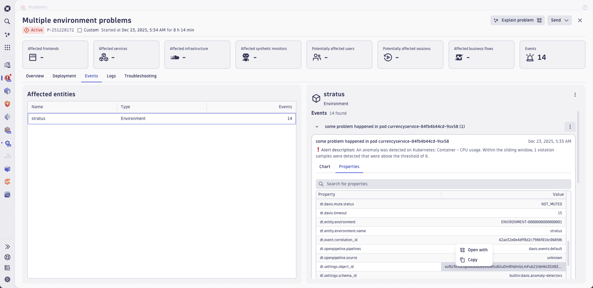

Read event properties for additional information
Dynatrace receives events from multiple event sources, such as OneAgent, Synthetic, extensions, and ingestion APIs. Dynatrace accepts and understands various properties (also referred to as fields) of those events that provide additional information about the event.
Event sources can be customized to provide the information you need to analyze and remediate problems caused by the events. For example, linking the configuration that detected the event (dt.settings.schema_id and dt.settings.object_id) helps you to quickly adapt the threshold or baseline if such action is necessary.
Another example is adjusting the sensitivity of the custom alert that triggered the event by modifying the detector's configuration in the settings.
Since available event properties depend on the event's source, events that are not generated by custom alerts don't contain links to relevant event settings. If you want an event to link to a settings object, you can do so by attaching a dt.settings.object_id property to events ingested via API and/or extensions.
Problems app - new Problems displays all event properties for each collected event in a table and provides intent links, such as direct navigation to a custom alert's configuration, as shown below.
Problems app offering a direct link to settings object.
Examples of powerful event properties include:
  • Event description (event.description). The event description supports Markdown-formatted text, enabling you to include links to resources that can help to remediate the problem.
  • DQL query (dt.query) allows you to rebuild the event's chart in a notebook or at a dashboard or to copy the raw value of a property.
  • Related entities (dt.entity.*) allow you to directly navigate to entities through the dt.entity.* properties.
  • Link to a settings object (dt.settings.object_id) and settings schema (dt.settings.schema_id).
To learn more about the semantics and syntax of event properties and how they can be used across Dynatrace, see Semantic Dictionary.
Analyze problems with your own tools by exporting CSV
For cases when your software tools create integration gaps preventing you from effective usage of Dynatrace data, we provide the ability to export problem feed data in the CSV format. You can later use this data in various tools, including spreadsheet programs, databases, and data analysis tools.
As illustrated below, you can export problem related-data from the problem feed table. You can also export it from Notebooks and Dashboards within all table visualizations.
Export selected problems as a CSV file.
You can export all loaded problems (up to a limit of 1000) or use the multi-select feature to choose specific problems. Additionally, the filter bar above the table allows you to filter through larger subsets of problems. The Select all checkbox helps you to export all problems in the filtered set of entries.

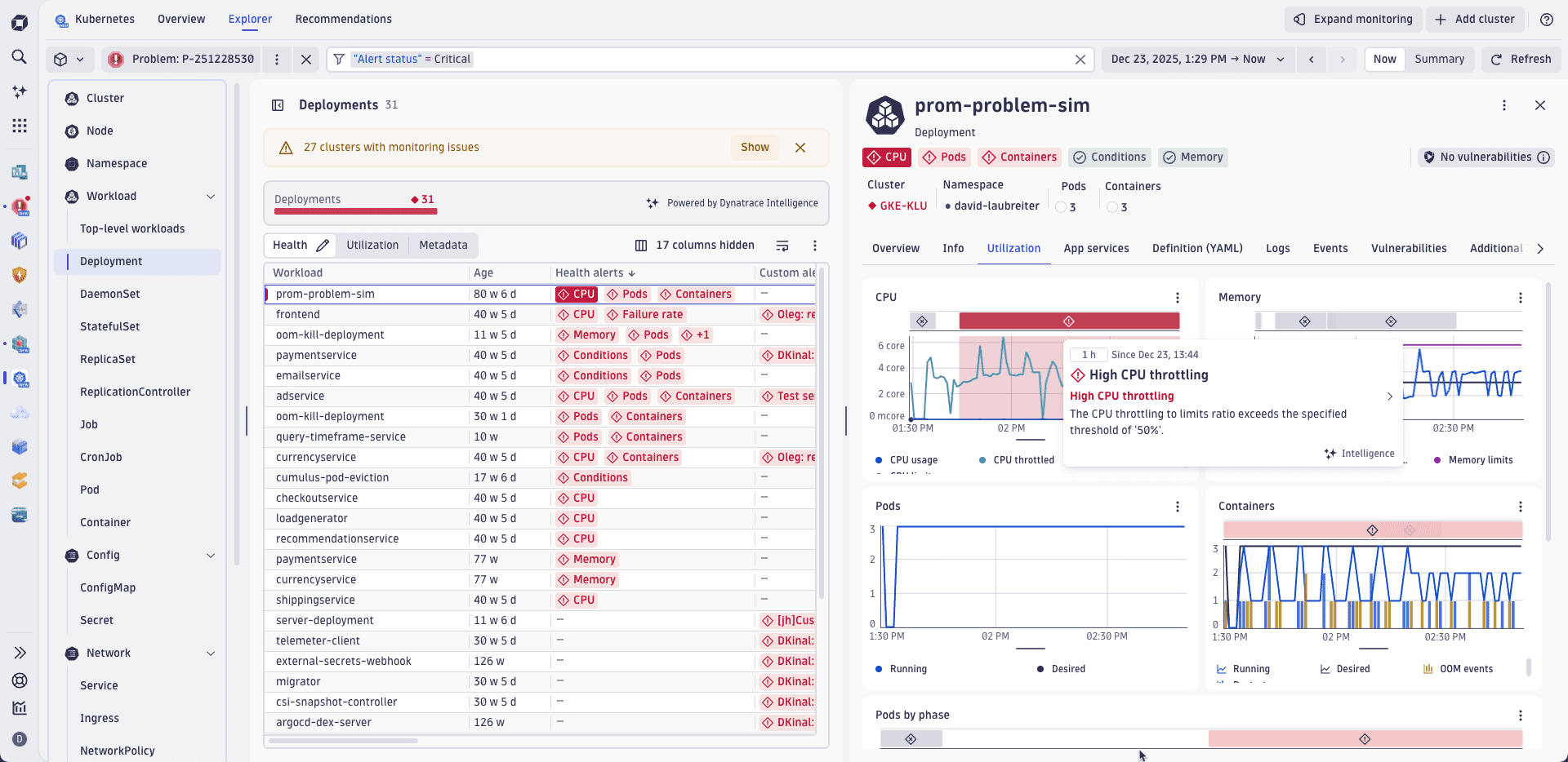

Check the root cause without leaving your context
Depending on your team's responsibility, you might want to focus your attention on Kubernetes clusters, cloud resources, and workloads of critical services. To minimize context switching, Dynatrace offers consistent root cause information across multiple apps. No matter where your investigation starts, you don't have to switch to Problems app - new Problems to see the root cause.
In the example below, the Kubernetes app displays information about a problem affecting a workload.
Problem information integrated into the Kubernetes app.

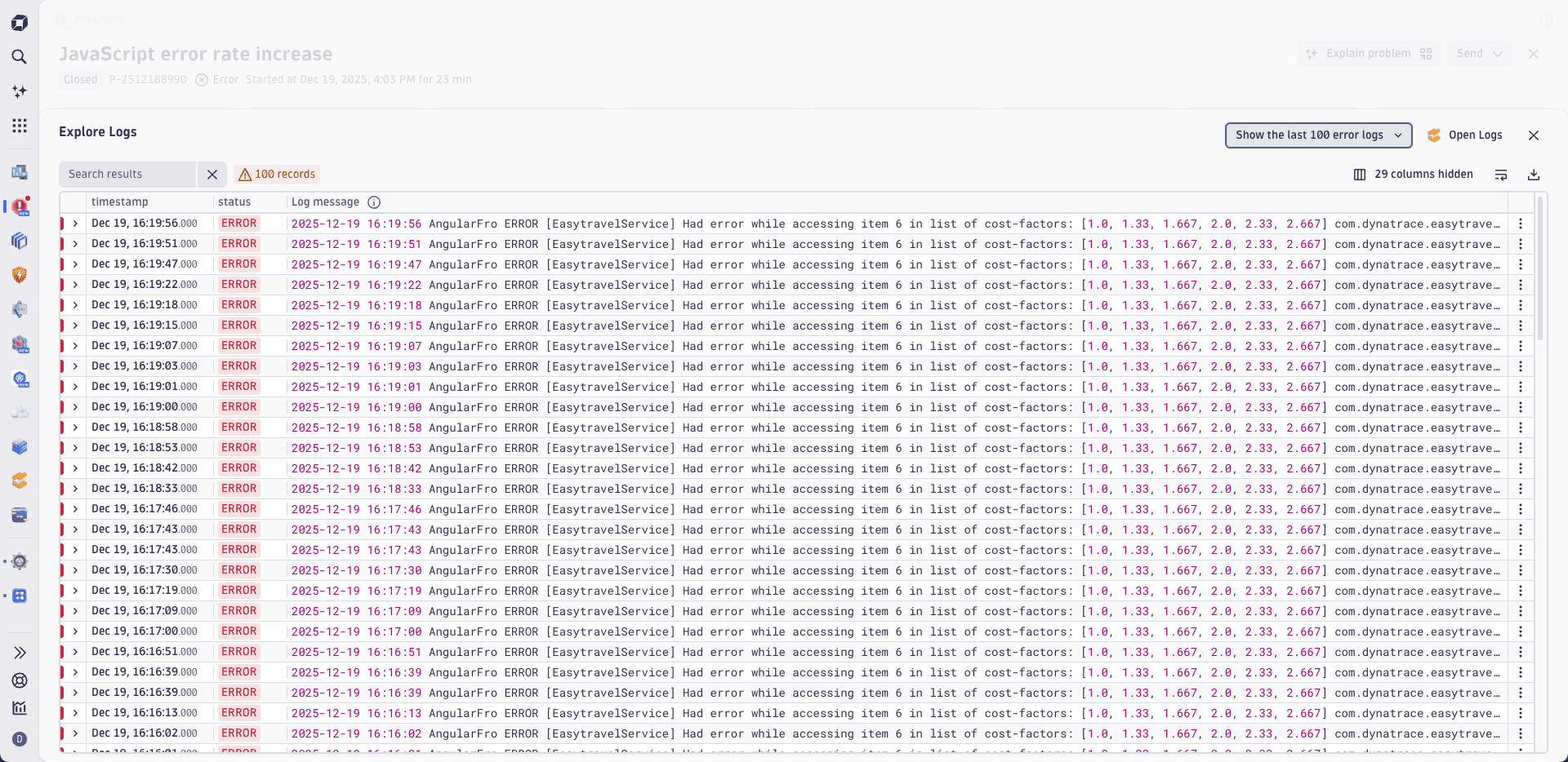

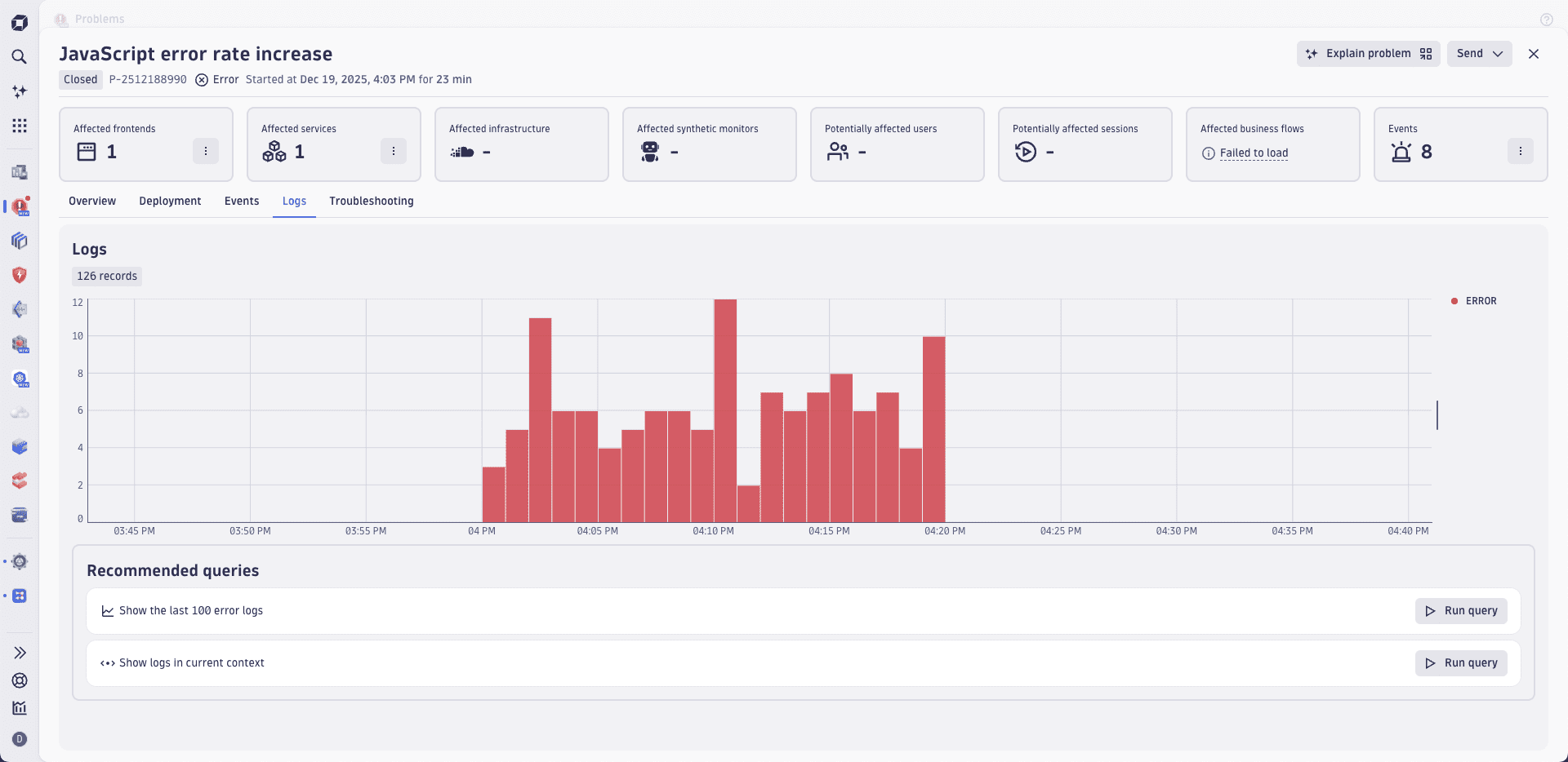

Investigate all problem relevant logs
A Davis-analyzed problem highlights the root cause of an incident and shows all the incident-relevant log lines across multiple entities in the problem details.
To access the log lines that were collected during the incident, select the Logs tab. Additionally, you're able to see their log level across all entities affected by the problem, allowing you to save time on manual investigations and filtering logs of relevant entities separately.
The Logs tab also includes references to the affected entities and information about all related entities, such as parent hosts. To verify which entities are affected by the problem event, you can refer to all the event properties that start with the dt.entity. prefix.
See how Logs tab summarizes all problem-relevant logs in the image below.
Dynatrace Intelligence Problems app log count.
The image below illustrates the further sorting of the log lines with the help of a DQL query.
Dynatrace Intelligence Problems app error log lines.

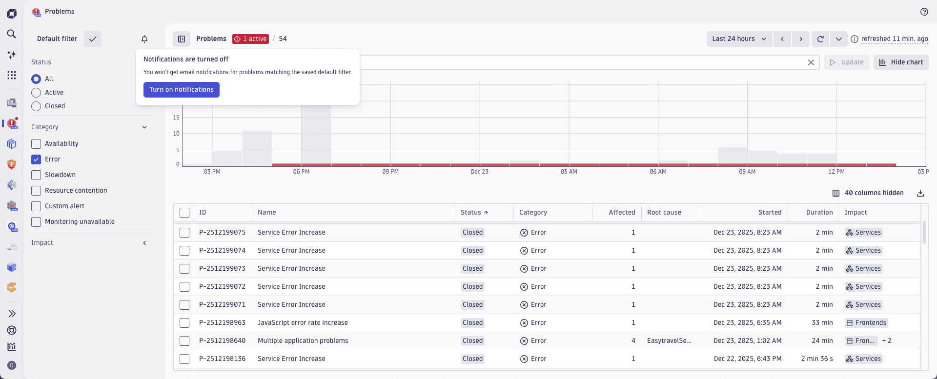

Problems app - new Problems features a global problem indicator that shows the number of active problems within the environment and is always visible in the Dock. When the Dock is collapsed, a red dot is displayed next to the app icon instead of a number.
To personalize the indicator and the number of the displayed active issues, select filters in Category and save the filter configuration by selecting the icon. The saved filter will automatically apply to the global problem indicator, reducing the number of problems counted for the user, as shown below. Selecting the Default filter button restores the last saved configuration.
Saving filter configuration in Problems app.
While a problem filter is active, the indicator number will only show active problems from your chosen categories. The indicator updates on a one-minute schedule, which means that after the filter is updated, it can take some time for the indicator to adapt.
You can also set up email notifications for filtered problems using your email address by selecting the icon, as shown below:
Turning on email notifications for the filters applied in the Problems app.

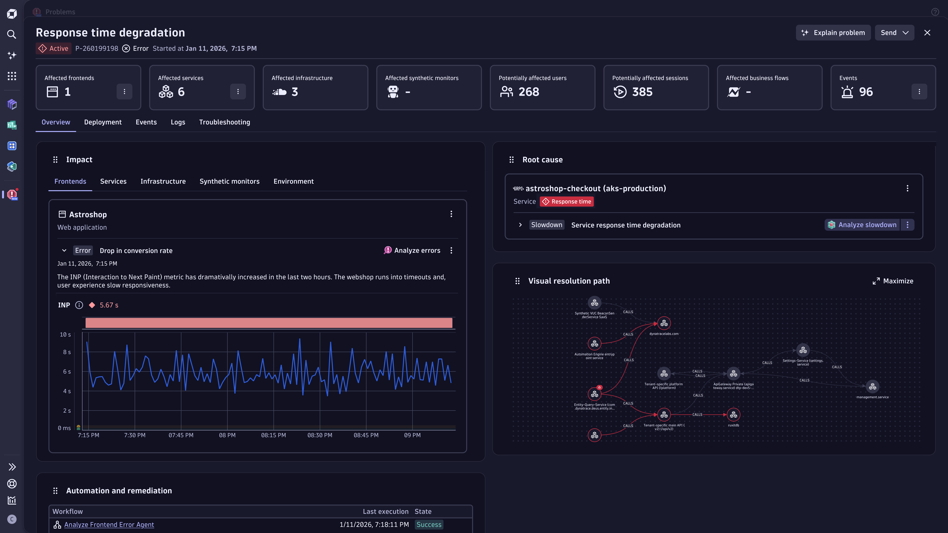

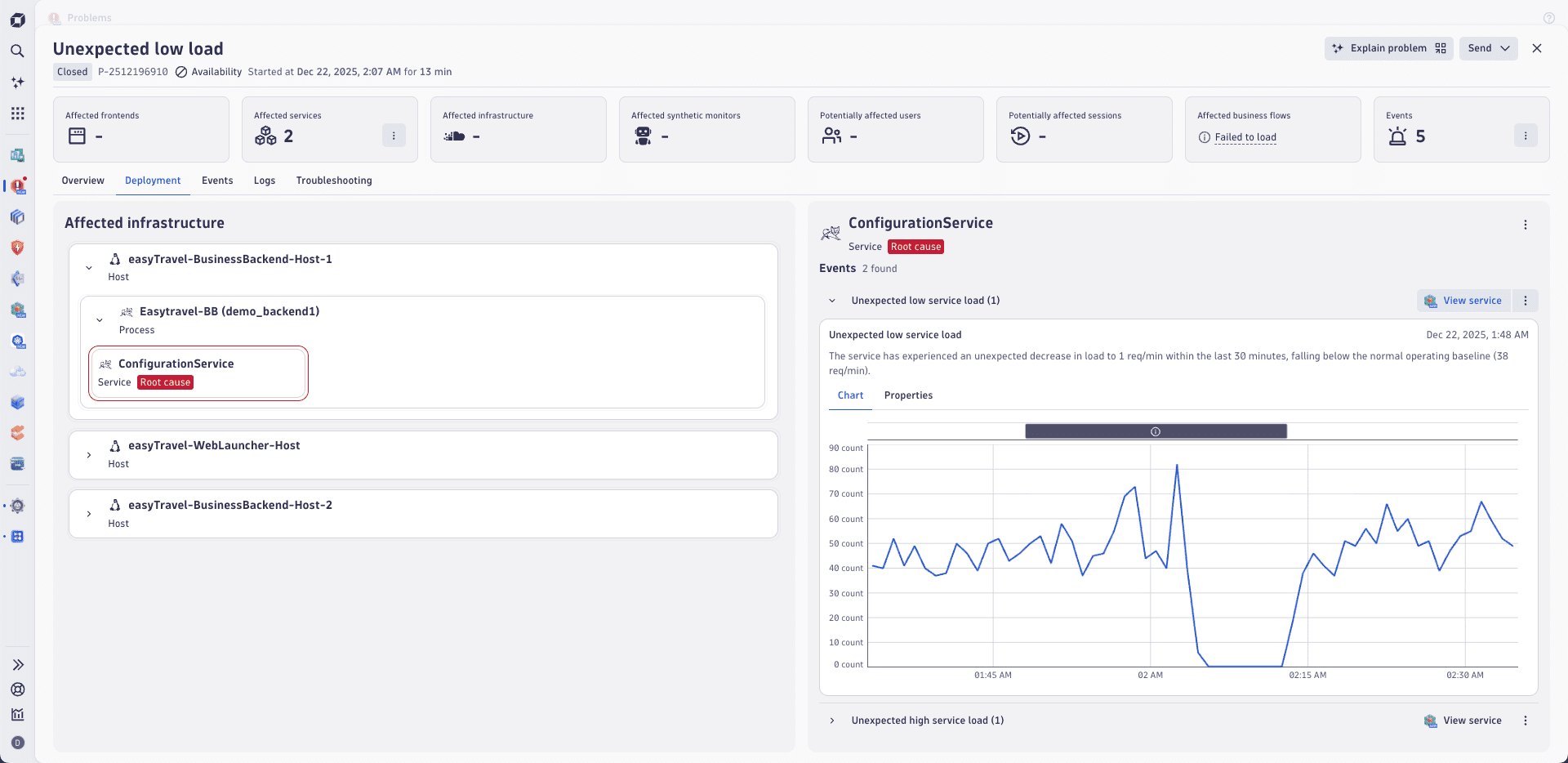

Visualize affected deployments to gather additional insights
The Deployment perspective equips operations teams with deeper insight into the infrastructure and cloud resources impacted by large-scale incidents. The root cause analysis feature automatically collects and visualizes affected deployments and related resources.
The additional context provided by related resources allows you to:
  • Quickly understand where an affected resource resides, for example, a specific cloud region or Kubernetes cluster.
  • Gather additional insight for multicloud deployments by showing an app's deployment across clouds, regions, and technology boundaries.
Deployment view uses a diagram similar to a Unified Modeling Language (UML) deployment diagram and follows a top-down approach, starting with the largest container element at the top and becoming more detailed as you drill down. The deployment structure is visualized as collapsible cards with horizontally overlapping elements, for example, services running in multiple regions. In this case, cards representing such services are duplicated and shown in multiple deployment stacks.
The deployment containing the root cause is automatically expanded and tagged with a red root cause badge, while all other deployments are collapsed by default. The deployment hierarchy is focused on a maximum of 5 levels, starting with the hierarchy leaf nodes at the bottom of the diagram upwards, seen in the example below:
Dynatrace Intelligence Problems Deployment view with highlighted root cause.
Interactivity is a crucial feature of the deployment view. On the right side, you can click on any element to visualize findings, such as events related to the problem, along with a direct link to the selected entity. This structured approach allows you and your operations team to reduce the time needed to respond to incidents by navigating a familiar visual representation.
Not all incident-relevant related elements may show information on the right. Some elements, like the cloud region, are displayed for better context but may not necessarily show problem-relevant events.

Streamline problem resolution with problems-specific drill-down options
Problems app - new Problems provides drill-down options that are designed to guide you toward the most relevant actions for resolving detected problems and help you streamline problem resolution.
Drill-down options available to you are displayed within the problem details view and depend on the type of the affected entity (such as service, Kubernetes workload, host, or AWS availability zone).
Some of the available drill-down options are:
  • Analyze failures: Perform a focused failure analysis to identify the root cause of failure rates, error patterns, or performance issues.
  • View related logs: Investigate relevant log entries directly within Problems app - new Problems.
  • View failed traces: Analyze failed traces in Distributed Tracing Distributed Tracing to understand the root cause of failures.
  • View app: Navigate to the associated app's details page. The exact name is specific to the affected entity (such as View service, View Kubernetes workload, or View host).
To access drill-down options
  1. In Dynatrace, go to Problems app - new Problems.
  2. Select the problem you want to investigate from the Problems app - new Problems overview. This opens a problem details page.
  3. Optional On the left side of the problem details page, select the affected entity or infrastructure you want to investigate further. Usually, when you open the problem details page, the affected entity is pre-selected for you.
  4. From the affected entity details on the right, select the preferred option for further investigation.
    • Select > View related logs to continue the investigation without leaving Problems app - new Problems.
    • Select > View failed traces to continue the investigation in the Distributed Tracing Distributed Tracing.
    • Select > View app to continue the investigation in one of the available Dynatrace apps.
    • Select > Open with to see all available investigation options.
Drill-down options provide you with seamless navigation between Problems app - new Problems and other Dynatrace apps to ensure focus and continuity in problem resolution.
Review problem overview
The Overview is a concise, executive summary of a detected problem.
To view a problem overview
  1. Go to Problems app - new Problems and open the problem you need to resolve.
  2. On the problem details page, select Overview.
    Example:
    Example problem details Overview tab
The Overview has four sections:
Section
Description
Displays all impacted Smartscape entities (for example, services, processes, and hosts) along with brief issue details for each entity.
Focuses on the root cause of the issue, including detailed information about the affected deployment stack.
Graphically illustrates the relationships between frontends, services, and backends involved in the issue.
Lists all automation workflows triggered by the problem, such as notifications, remediations, and external integrations.
Customize the layout
You can move these sections around to personalize your view of the Overview.
  1. In the header of the section you want to move, select and drag the section.
  2. Drop the section where you want it to appear in the layout.
These changes are saved per user. Your layout changes don't affect how others see the overview.
Impact
The Impact section displays all impacted Smartscape entities (for example, services, processes, and hosts) along with brief issue details for each entity.
The Impact section is categorized by:
  • Frontends
  • Services
  • Infrastructure
  • Synthetic monitoring
  • Environment
Root cause
The Root cause section focuses on the root cause of the issue, including detailed information about the affected deployment stack. This may include:
  • The process and host where the root-cause service is running.
  • The Kubernetes workload serving the impacted service.
To ensure consistency, the root-cause entity is also listed in the Impact table.
Visual resolution path
The Visual resolution path section graphically illustrates the relationships between frontends, services, and backends involved in the issue.
  • Each node represents a Smartscape entity (frontend, service, or backend) where a health issue was detected.
  • Gray nodes indicate related entities used in the analysis but not directly impacted.
This graph helps explain how Dynatrace AI identified the root-cause backend service.

Automation and remediation
The Automation and remediation section lists all automation workflows triggered by the problem. These workflows may include:
  • Alert notifications sent to response teams.
  • Remediation flows and runbooks for auto-remediation.
  • External AI agent triggers, such as cloud platform SRE agents, to gather further insights or resolve issues within cloud vendor infrastructure.
The table provides key details for each workflow, including:
  • The last trigger time (as workflows may run multiple times during problem updates).
  • The execution state (for example, success or failure).
Workflow execution details are based on standard workflow execution events, which can also be queried using DQL in Notebooks Notebooks and Dashboards Dashboards.
Note:
  • Only users with system event read permissions can view workflow executions. Without these permissions, the table is empty and a message indicates the missing access.
  • Workflows not shared with your user are listed but shown in gray without direct links, indicating restricted access.
