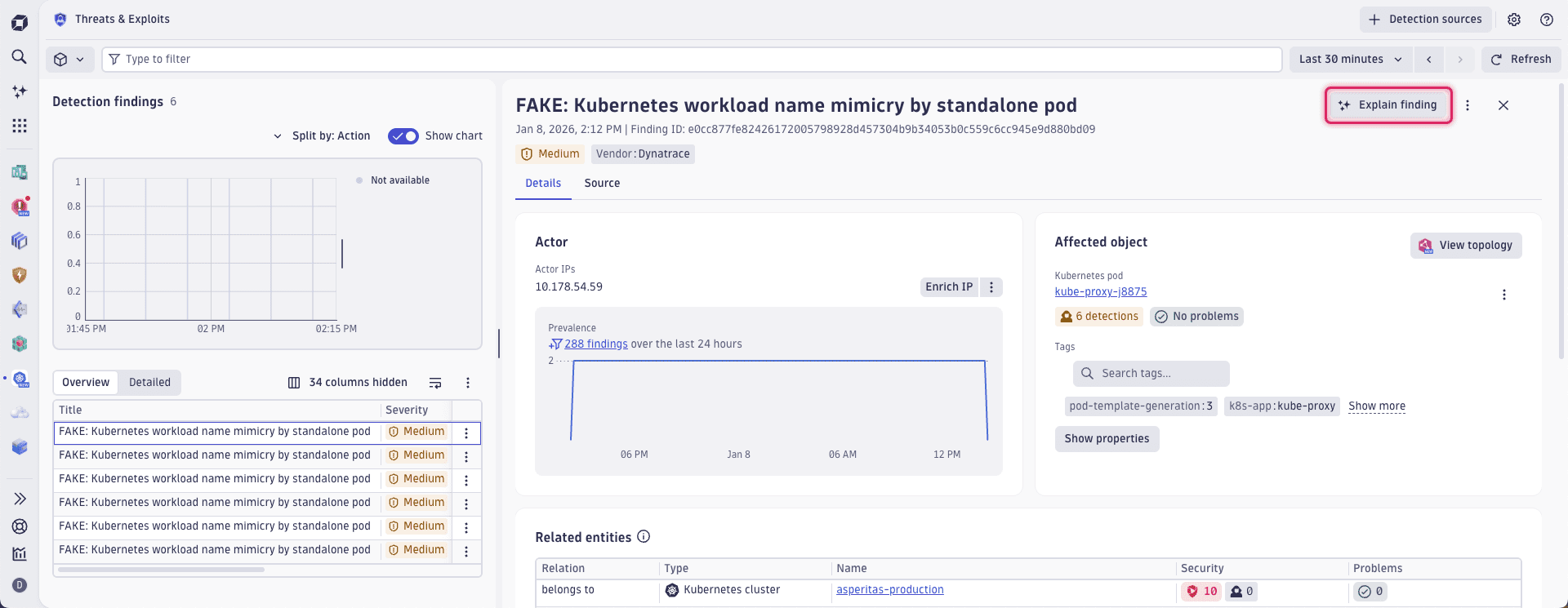

Dynatrace Assist in Threats & Exploits
Dynatrace Intelligence generative AI can provide contextual, plain-language explanations of detection findings to accelerate understanding and response.
To access the functionality
  1. In Threats & Exploits Threats & Exploits, select a finding.
  2. In the upper-right corner of the finding details pane, select Explain finding.
Generative AI will provide a response that details:
  • A description of the threat or exploit and its underlying conditions
  • The potential impact and likelihood of exploitation
  • The affected entities and relevant attack paths
  • Indicators that contribute to the threat assessment
  • Recommended actions to reduce exposure or validate the finding
The structure and level of detail vary depending on the threat type, available context, and the nature of the exploit. Explanations are tailored to the characteristics of each insight to support evaluation and response.
