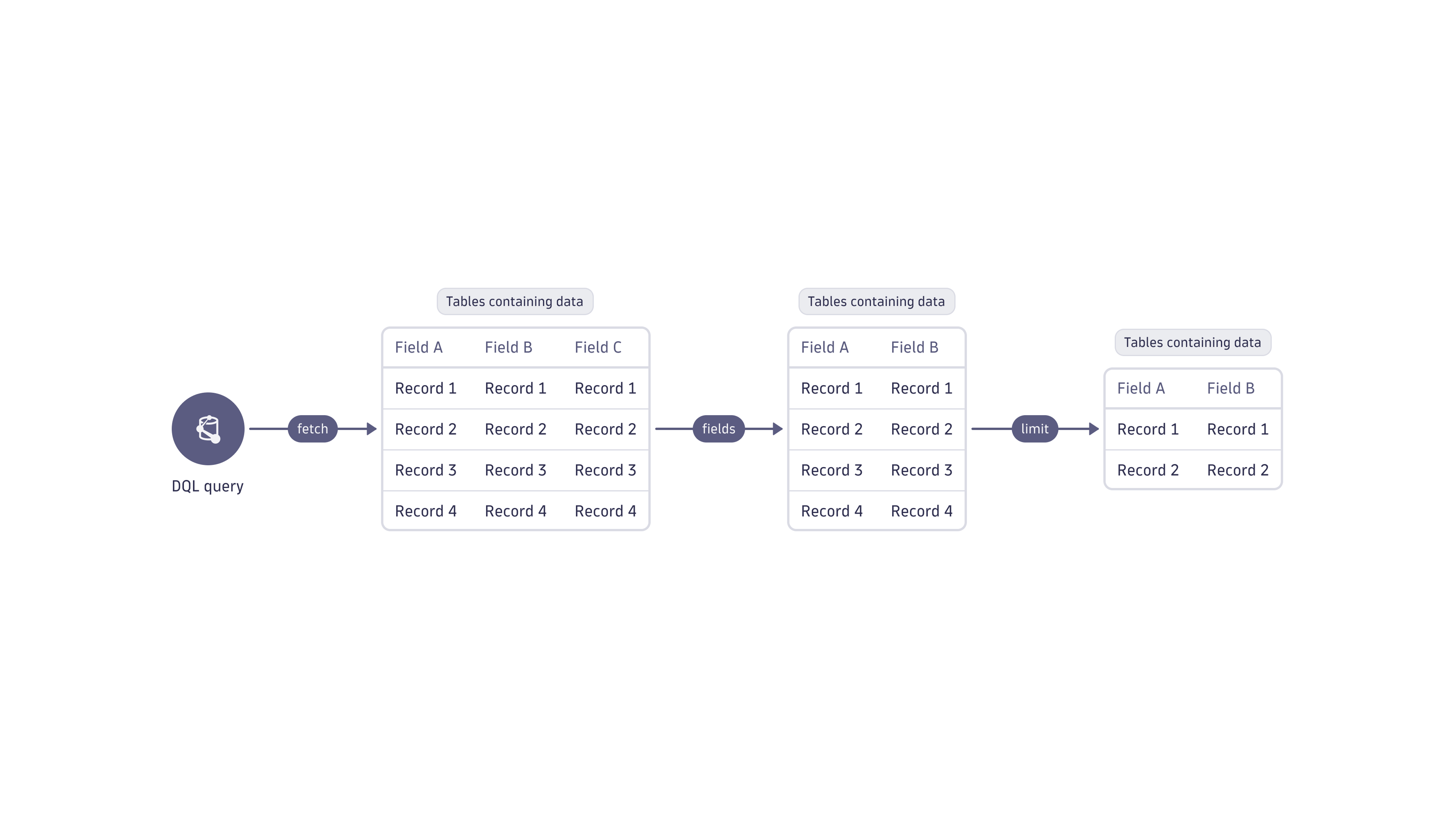

Chaining commands with the pipe operator
A DQL query contains at least one or more commands, each of which returns tabular output containing records (lines or rows) and fields (columns). All commands are sequenced by a | (pipe). The data flows or is funneled from one command to the next. The data is filtered or manipulated at each step and then streamed into the following step.
After each operation, DQL returns a table or collection of tables containing data. The pipe operator funnels those tables into the next operation, where they're further processed or manipulated. This makes it easy to incrementally chain operations until the final, intended result is achieved.
Because the channeling of information from one operator to another is sequential, the query operator order is important and can affect both results and performance.
