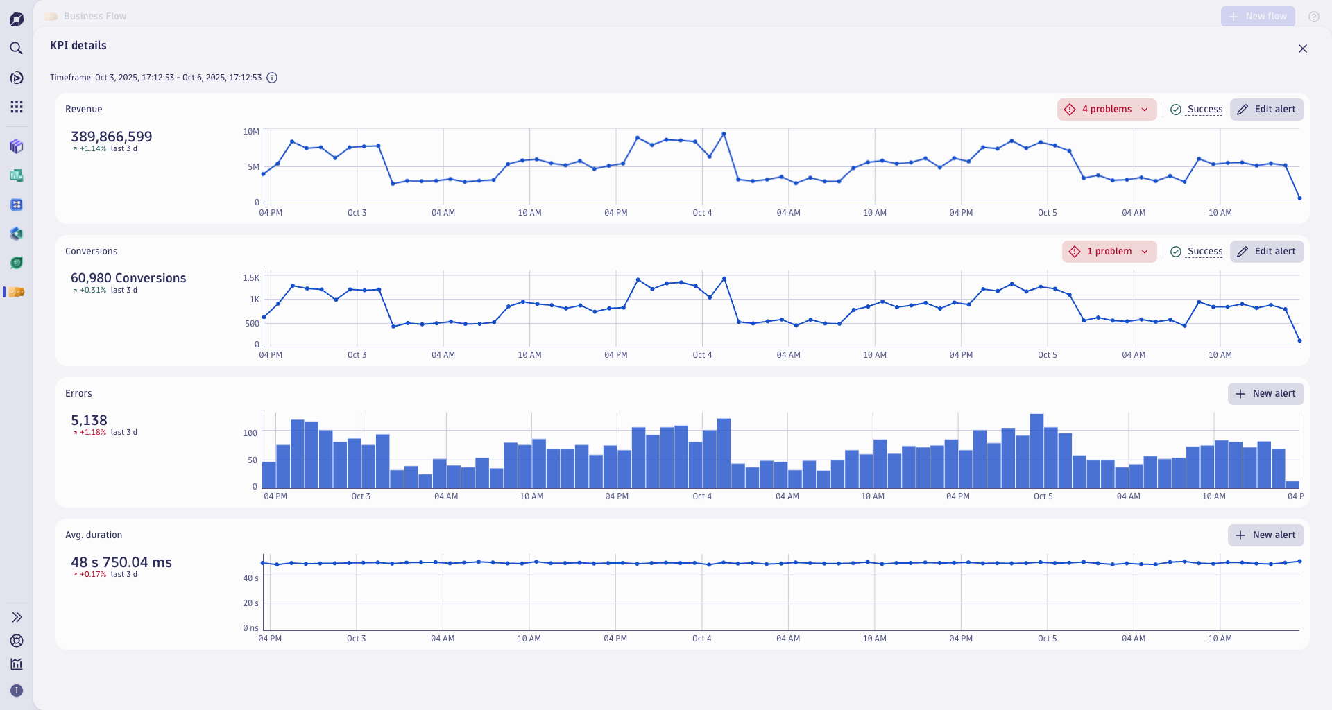

The Business Flow dashboard provides a real-time view into process and business KPI health.
Errors and business exceptions are displayed for the selected step.View your business flow KPIs over time and define alerts based on anomaly detection analyzers
1 of 2The Business Flow dashboard provides a real-time view into process and business KPI health. Errors and business exceptions are displayed for the selected step.

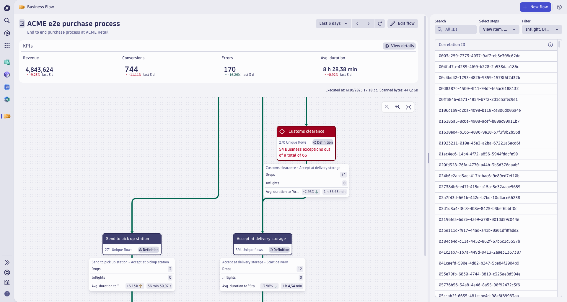

The Overview tab serves as the landing page, where you can start discovering Business Flow Business Flow and explore a demo business flow configuration or the last one accessed in a single view.
From here, you can:
  • Analyze your configured business flows. It contains all the user interface elements for analyzing your critical business processes.
  • Explore the entire tree of your processes, planning and zooming in the central main area, select steps to understand the flows, and search for specific groups of flows based on filters in the right panel.
  • Drill down into the top business KPIs to see them evolving over time and create alerts based on anomaly detection.

Filter correlation IDs
On the landing page in the right panel, you can use several filtering options to focus on the matching business flows.
  • Search for specific values of the correlation IDs.
  • Filter by a step to find all the business flows that may have reached or are in transit/dropped to that step and by the status of the business flow.

  • Report business process KPIs, including flows completed (conversions), average flow completion time, business exceptions, and a business KPI of your choice.
  • Visualize and analyze individual process flows from start to finish.
  • Detect and explore uncompleted or dropped process flows to determine the cause, such as an IT error, a business exception, or abnormal inter-step transit time.
  • Visualize process errors and business exceptions at each step.
