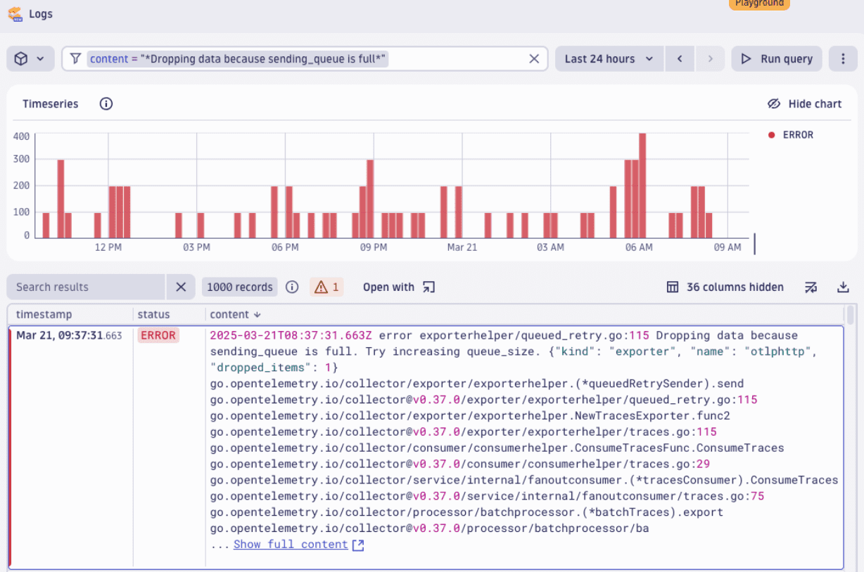

1. Find logs you want to trigger alerts
You can find alerts by opening Logs Logs and using the following DQL query.
fetch logs
| filter matchesPhrase(content, "Dropping data because sending_queue is full")
| sort timestamp desc
Log results
If your DQL query uses parse, fieldAdd, or other transformations, you should add a processing rule to set those fields on ingest.

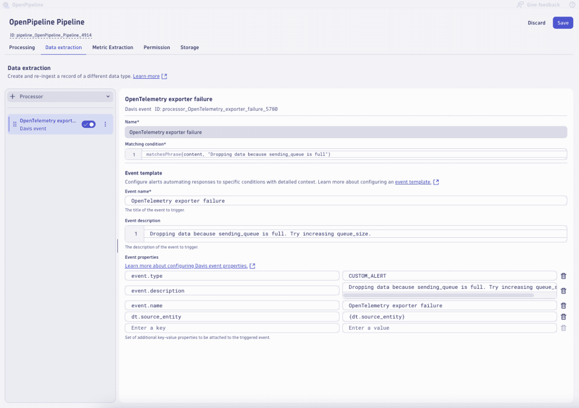

2. Extract Davis event in OpenPipeline
  1. Add Davis event data extraction configuration in OpenPipeline.
    1. Open Settings Settings > Process and contextualize > OpenPipeline > Logs and select the Pipelines tab.
    2. Find the pipeline you want to modify, or add a new pipeline.
    3. Select > Edit. The pipeline configuration page appears.
    4. Select Data extraction tab and add a Davis event processor.
  2. Set the DQL matcher. A matcher sets the condition for the event that is to be extracted. It is a subset of filtering conditions in a single DQL statement.
    In Matching condition, use the matcher as shown below.
    If you use segments or your permissions are set at the record level, you should include those conditions in the matcher.
    There are situations when a matcher can't be easily extracted from a DQL statement. In these cases, you can create log alerts for a log event or summary of log data.
  3. Set event properties.
    Event properties are metadata that your event will contain when it is triggered. You can remap any field from the log record.
    In our example, we will remap the dt.source_entity field to have the alerts connected to entities for Dynatrace Intelligence root cause analysis.
    In Event template, set the following key/value pairs.
    • Set event.type to CUSTOM_ALERT.
    • Set event.description to Dropping data because sending_queue is full. Try increasing queue_size..
    • Set event.name to OpenTelemetry exporter failure.
    • Set dt.source_entity to {dt.source_entity}.
    Pipeline data extraction

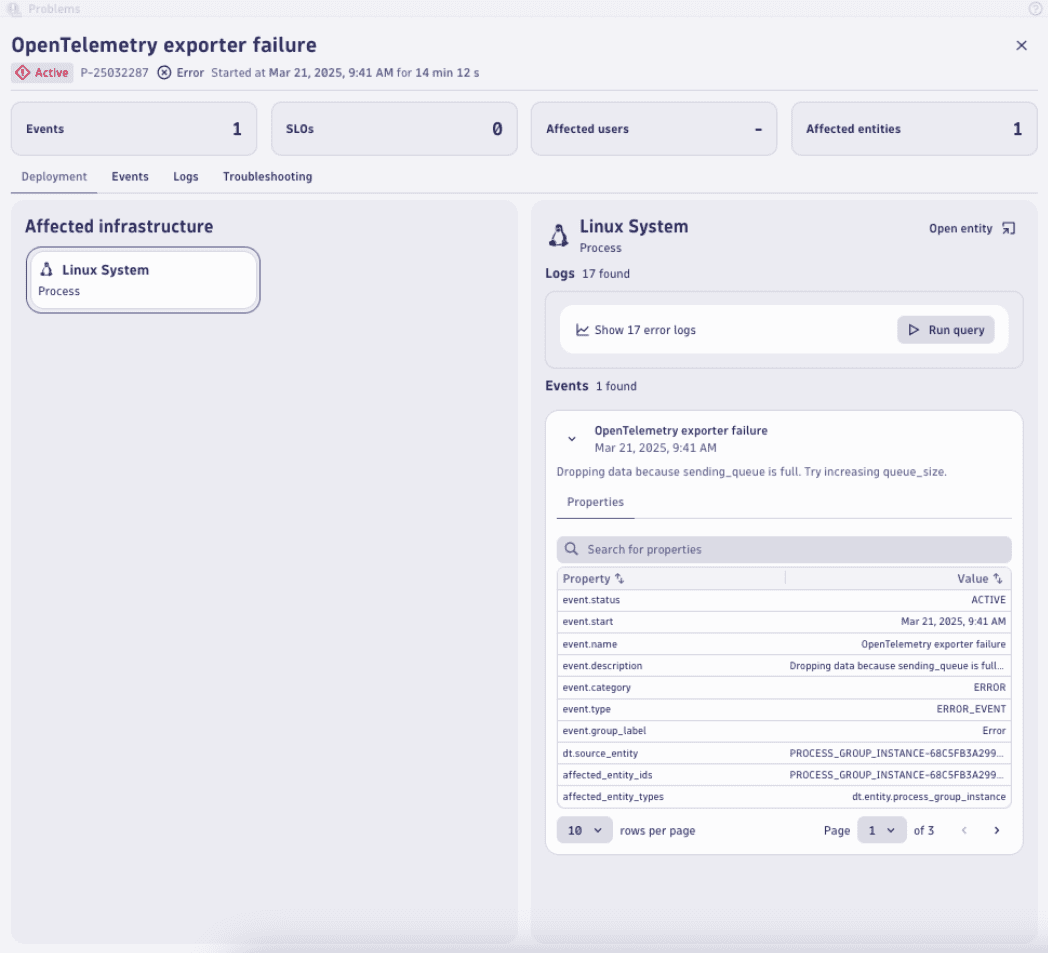

3. Open problem in Problems
When the first Davis event is extracted, a new problem will be opened. If there are no new events within the timeout period as defined in dt.davis.event_timeout, the problem will be closed automatically.
The default timeout is 15 minutes.
Problem in Problems app
