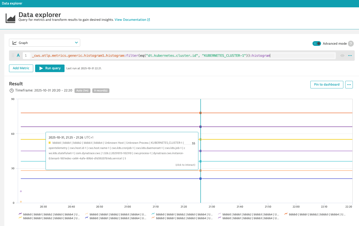

Turn advanced mode on
You can start building a simple query through the web UI and then turn on Advanced mode to see the underlying query.
For example, if you start with this query with Advanced mode off:
Data Explorer: Advanced mode: Off
you will see this when you turn Advanced mode on:
Data Explorer: Advanced mode: On
The underlying query code is displayed in the form in which it is passed to the Metrics API v2:
builtin:host.cpu.usage:splitBy("dt.entity.host"):avg:auto:sort(value(avg,descending)):limit(20)

Learn how to analyze an explicit histogram metric in the Data Explorer using the histogram transformation and how to extract percentiles from it.
In this example, we:
  • Start with metric _cws.otlp.metrics.generic.histogram1.histogram. Please note the .histogram suffix.
  • Apply an equals filter for the Kubernetes cluster like dt.kubernetes.cluster.id.
  • Use the histogram transformation to expose the buckets of the histogram metric as dimensions.
The final query looks like this:
_cws.otlp.metrics.generic.histogram1.histogram:filter(eq("dt.kubernetes.cluster.id", "KUBERNETES_CLUSTER-1")):histogram
Histogram transformation in Data Explorer
The value of the 'le' dimension denotes the upper boundary (less than or equal to) of each bucket. In this example, the upper boundary of bucket 55 is 5.

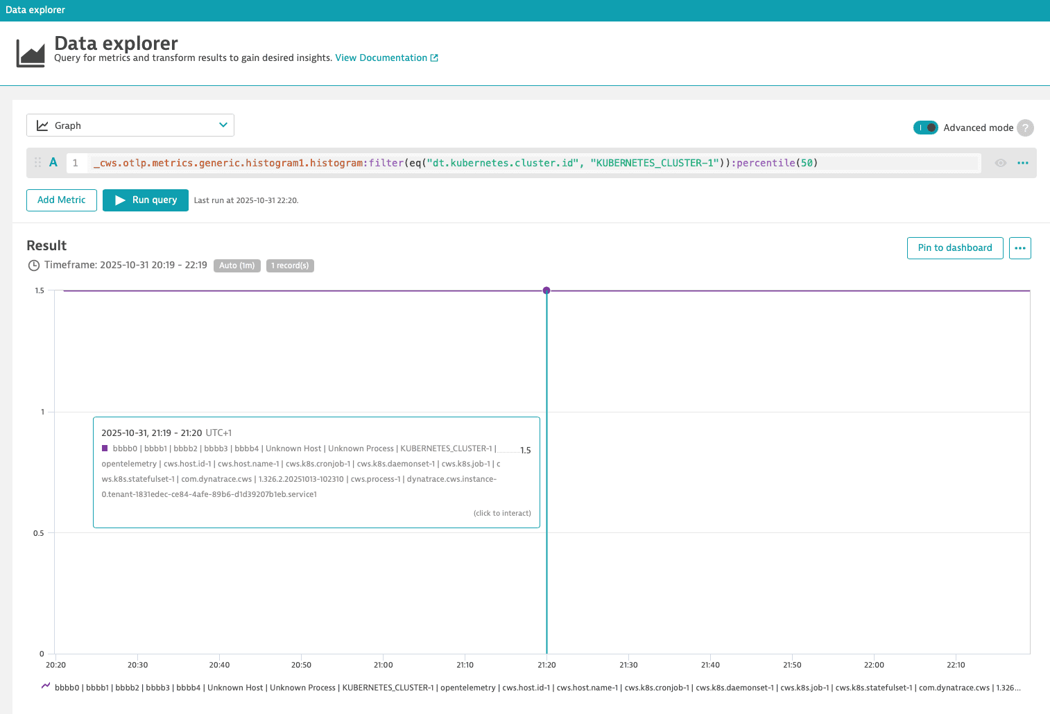

Percentiles
You can use the percentile transformation to extract a percentile from a histogram metric. For example, you can extract the median using percentile(50).
_cws.otlp.metrics.generic.histogram1.histogram:filter(eq("dt.kubernetes.cluster.id", "KUBERNETES_CLUSTER-1")):percentile(50)
Percentile transformation in the Data Explorer
