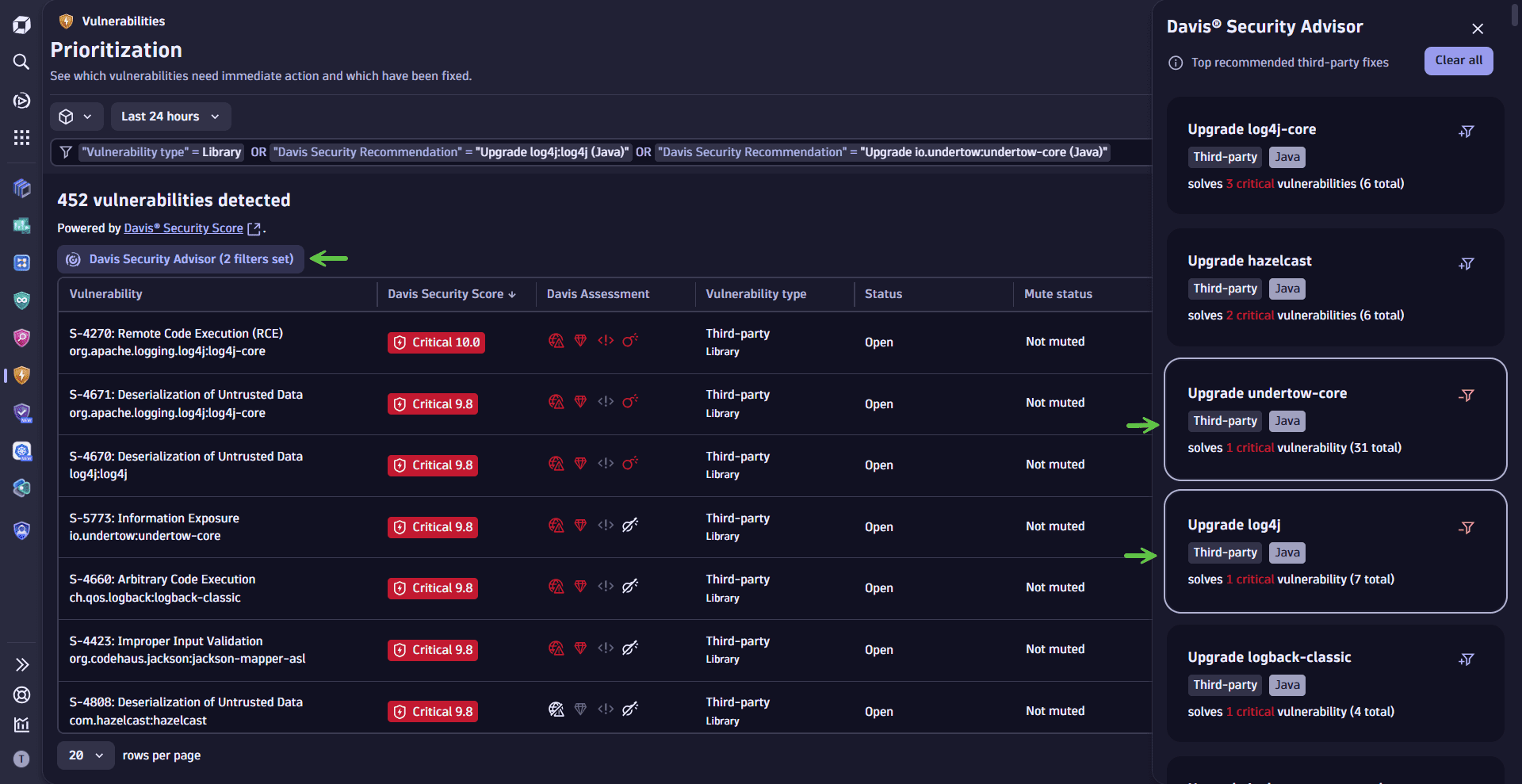

With Security Advisor, you can determine
  • Which patches and upgrades in the monitored technologies to apply for maximum remediation impact
  • How many vulnerabilities you can solve by updating a specific library
  • How many of the total solvable vulnerabilities are the most severe
To filter by Security Advisor fixes
  1. On the Prioritization page, on the upper-left of the vulnerabilities table, select Security Advisor. This opens a side window with a list of fixes.
  2. Select for the desired library. This filters the vulnerabilities table by the total number of vulnerabilities for a selected library that would be fixed by upgrading the library.
Make sure to restart processes after upgrading a library.
  • You can add as many Security Advisor filters as you want.
  • To remove a filter, select next to the desired library.
  • To remove all filters, select Clear all.

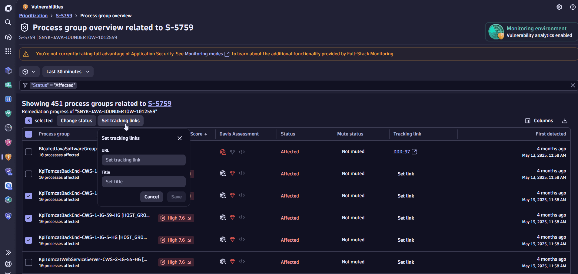

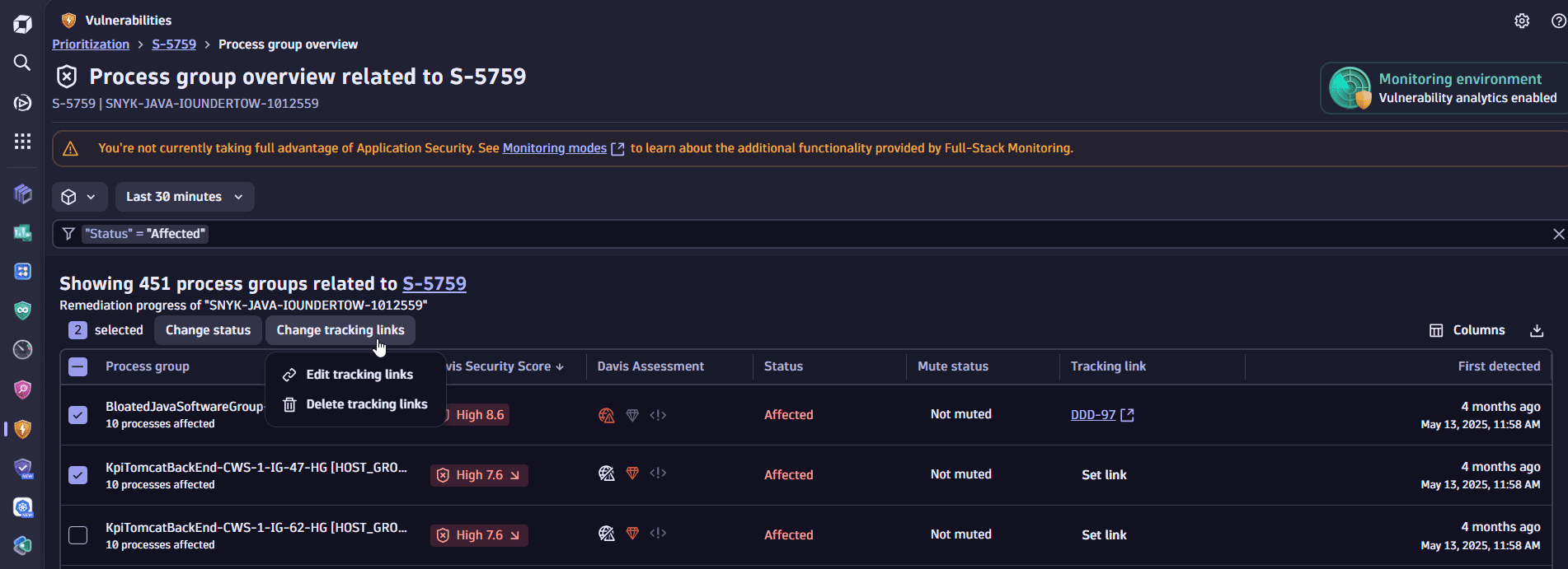

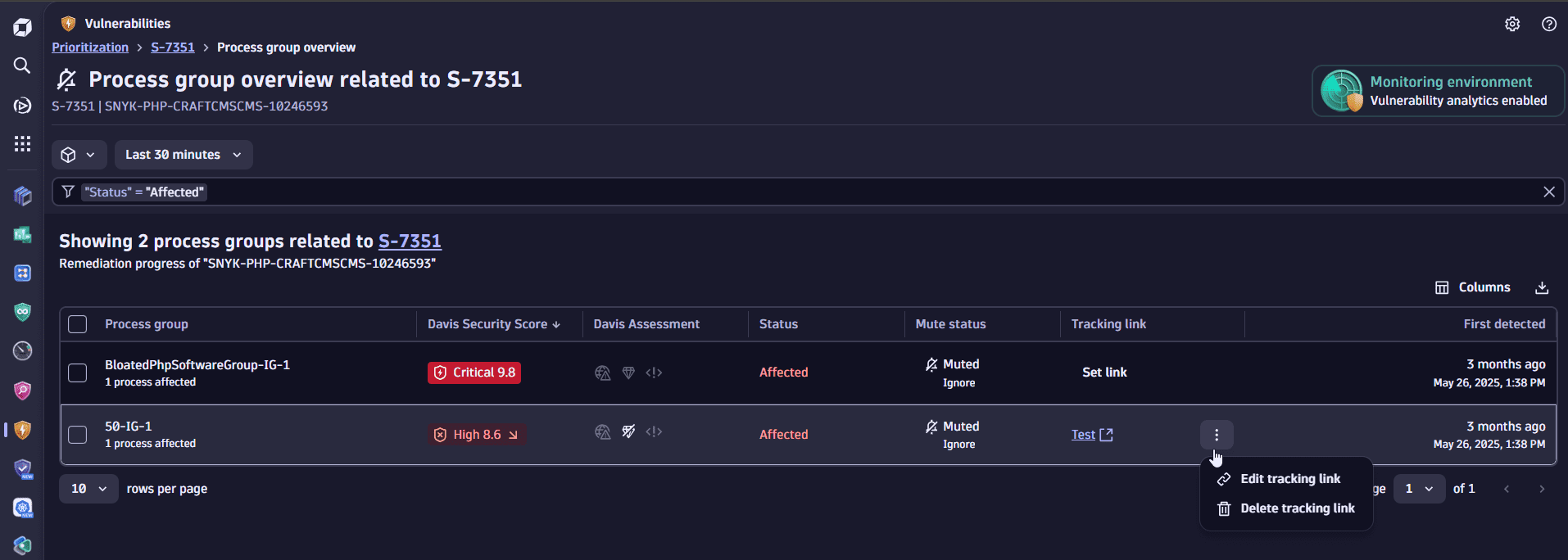

Set up tracking links
You can add, edit, or delete tracking links individually or in bulk.
  1. On the Prioritization page, select a vulnerability.
  2. In the side panel, go to Affected entities.
  3. Select View all process groups (View all Kubernetes nodes) to navigate to the process group (or Kubernetes node) overview page related to the vulnerability.

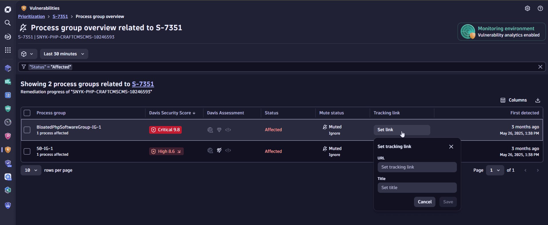

  4. You have the following options:
    • To add a tracking link, in the Tracking link column, select Set link for the desired entity.
    • To edit or delete a link, in the Tracking link column, select next to the tracking link for the desired entity, and then select Edit tracking link or Delete tracking link.
    • To add a tracking link, select the desired entities, and then select Set tracking links.
    • To edit or delete a tracking link, select the desired entities, and then select Change tracking links > Edit tracking links or Delete tracking links.

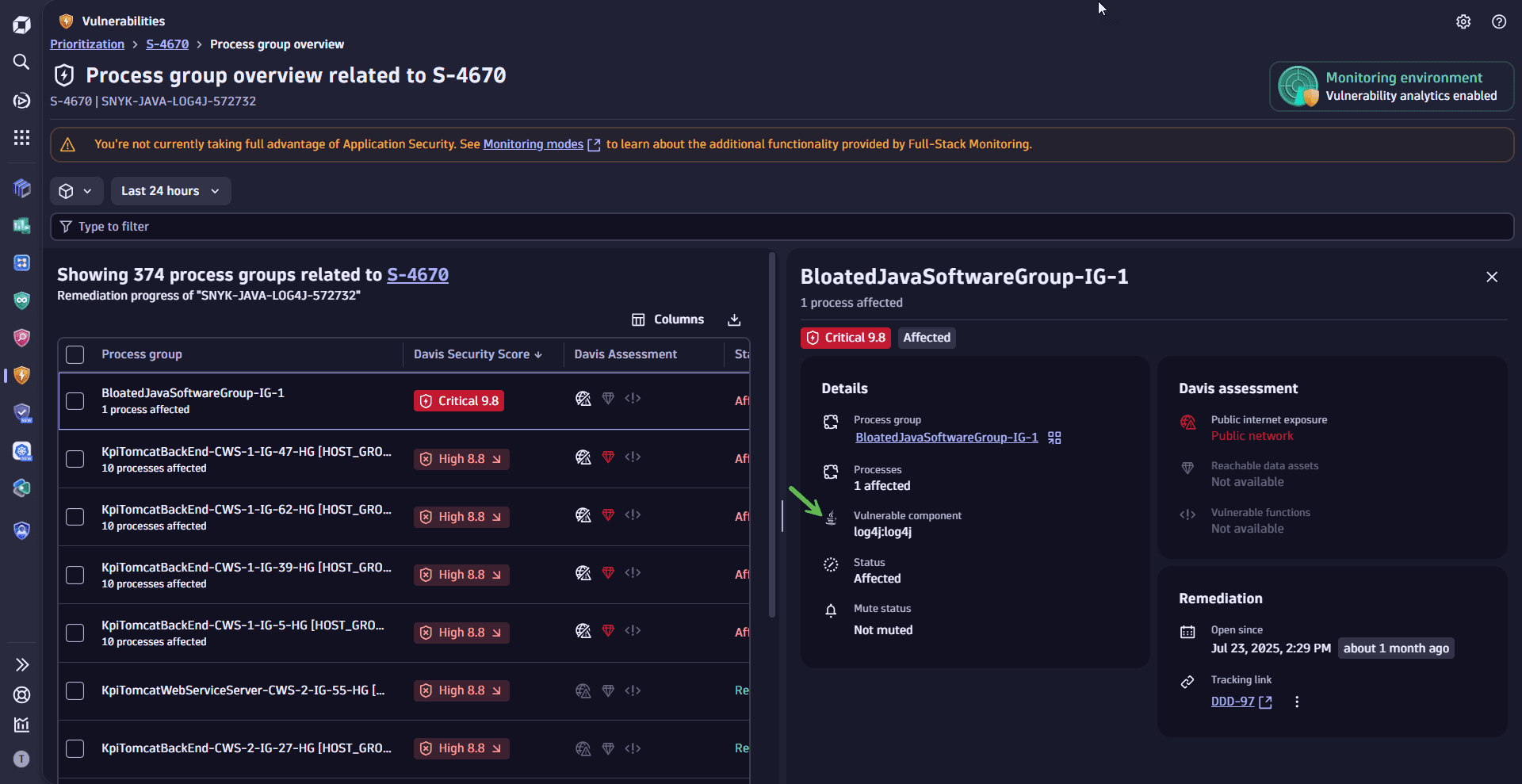

Identify which libraries contain the vulnerability and how many affected process groups (or Kubernetes nodes) are impacted.
  2. In the side panel, go to Affected entities and look for Vulnerable components.
You can also view vulnerable components on the overview page of process groups or Kubernetes nodes:
  3. Under Process group overview (or Kubernetes node overview), either select a specific process group (or Kubernetes node), or select View all process groups (View all Kubernetes nodes) to open the related overview page.
  4. From there, select an affected entity to view details, including the name of the vulnerable component.

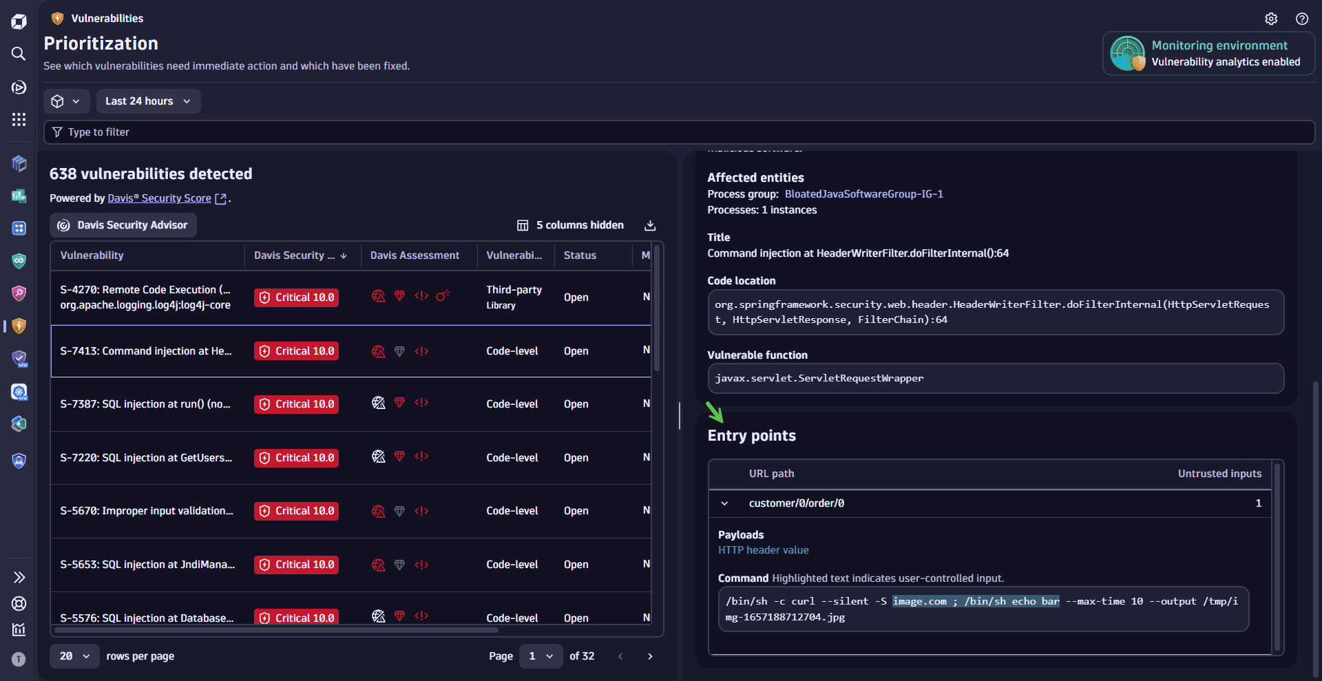

Examine entry points
Code-level vulnerabilities
Analyze entry points to determine how the vulnerability could be exploited and identify potential attack paths.
  2. In the side panel, go to Details and look for Entry points.
If the same vulnerability is reachable by multiple HTTP paths, multiple entry point entries are listed. To save memory and network traffic, a limited number of entries is displayed.
If a code-level vulnerability is resolved or is about to be resolved in the next 30 minutes, the entry points are no longer open (vulnerable).
Further reading
  • Concepts: Entry points

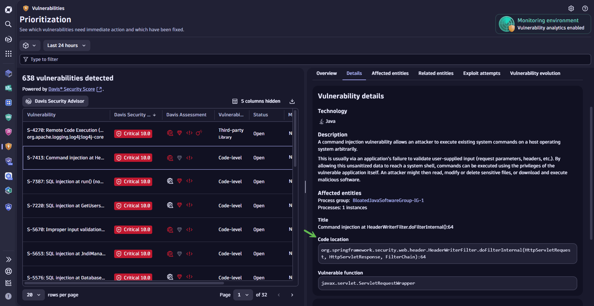

Examine code location
View the source of the vulnerable function call to quickly assess its impact and origin.
  2. In the side panel, go to Details and look for Code location.

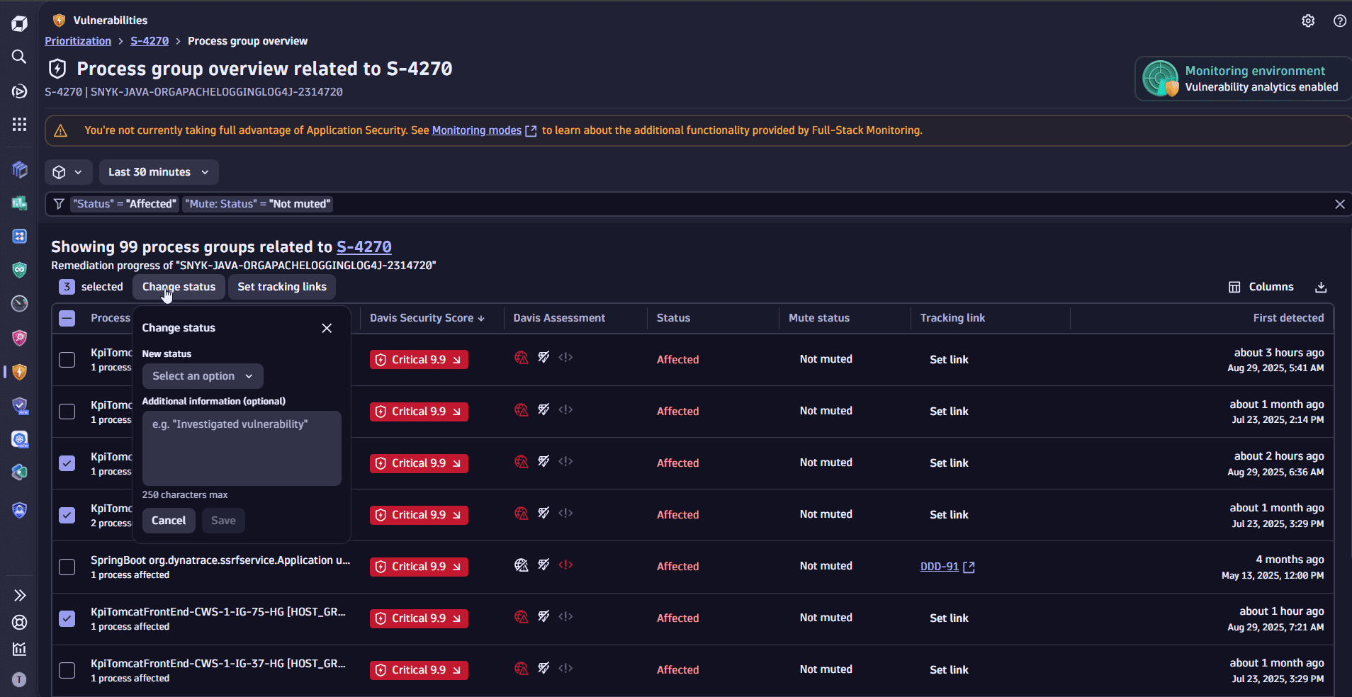

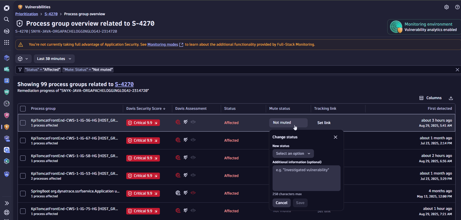

Change the mute status of affected entities
You can change the mute status of affected entities according to your findings and needs. For example, you can set the status of an affected entity to Muted (...) if you wish to ignore the vulnerability for this particular entity:
  • It could be a false flag, meeting some additional conditions that make the vulnerability irrelevant.
  • Or maybe there's no remediation available and a workaround has been applied.
Muting all affected entities of a vulnerability sets the vulnerability status to Muted. For details, see Vulnerability status.
You can change the status of affected entities individually or in bulk.
  4. In the Mute status column, select the current value for the desired entity.
  5. Enter the new status and select Save.
  4. Select the desired entities.
  5. Select Change status.
  6. Enter the new status and select Save.
