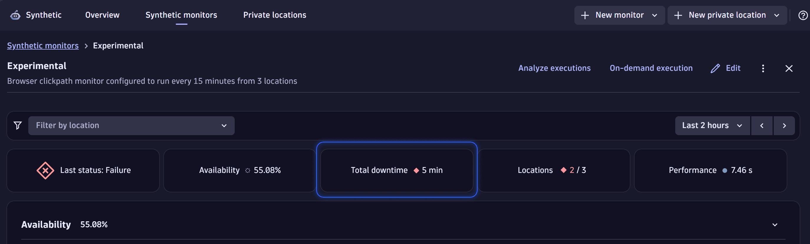

Browser monitor landing page
Metric visualizations
The top panel shows overall monitor availability and performance for the selected timeframe.
Use the filter bar at the top of the page to filter browser monitor executions by one or more locations.
Under the filter bar, you can see tiles for important information:
  • Outage/Available/No data—the monitor availability status at the moment of the last executed test.
  • Active issues—the number of issues being observed at the moment.
  • Affected locations—the number of locations where outages happened in a specific timeframe.
  • Availability—the monitors availability rate in percent in a specific timeframe.
  • Total downtime—the total outage time for all locations in a specific timeframe.
  • Duration—the average response time for all locations in a specific timeframe.
