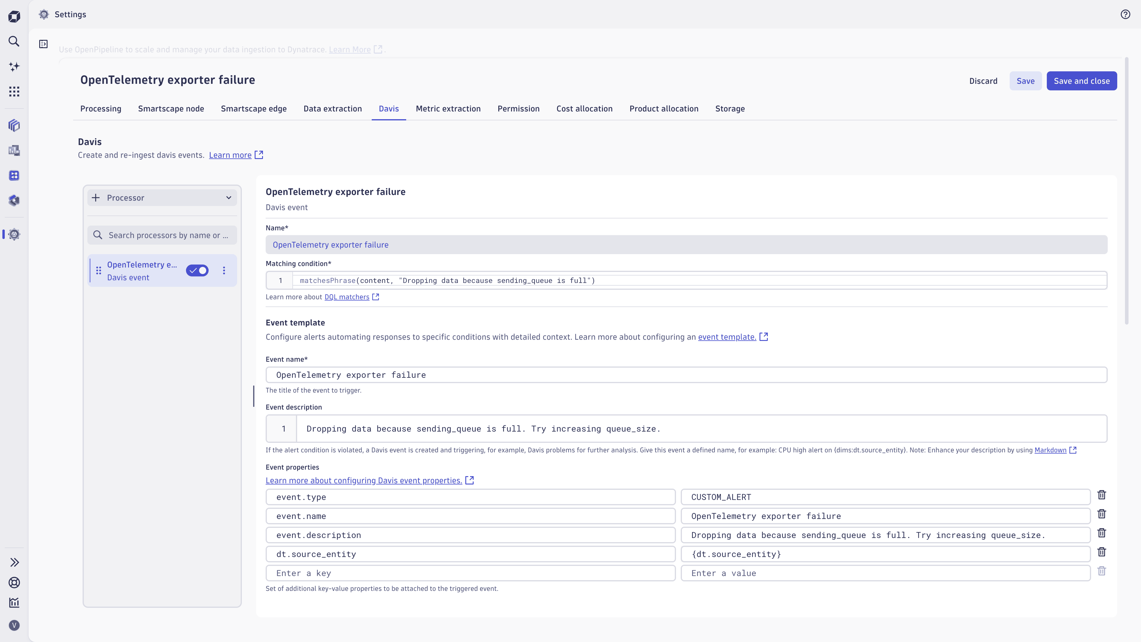

2. Extract Davis event in OpenPipeline
  1. Add Davis event extraction configuration in OpenPipeline.
    1. Open Settings Settings > Process and contextualize > OpenPipeline > Logs and select the Pipelines tab.
    2. Find the pipeline you want to modify, or add a new pipeline.
    3. Select > Edit. The pipeline configuration page appears.
    4. Select Davis tab and add a Davis event processor.
  2. Set the DQL matcher. A matcher sets the condition for the event that is to be extracted. It is a subset of filtering conditions in a single DQL statement.
    In Matching condition, use the matcher as shown below.
    matchesPhrase(content, "Dropping data because sending_queue is full")
    If you use segments or your permissions are set at the record level, you should include those conditions in the matcher.
    There are situations when a matcher can't be easily extracted from a DQL statement. In these cases, you can create log alerts for a log event or summary of log data.
  3. Set event properties.
    Event properties are metadata that your event will contain when it is triggered. You can remap any field from the log record.
    In our example, we will remap the dt.source_entity field to have the alerts connected to entities for Dynatrace Intelligence root cause analysis.
    In Event template, set the following key/value pairs.
    • Set event.type to CUSTOM_ALERT.
    • Set event.description to Dropping data because sending_queue is full. Try increasing queue_size..
    • Set event.name to OpenTelemetry exporter failure.
    • Set dt.source_entity to {dt.source_entity}.
