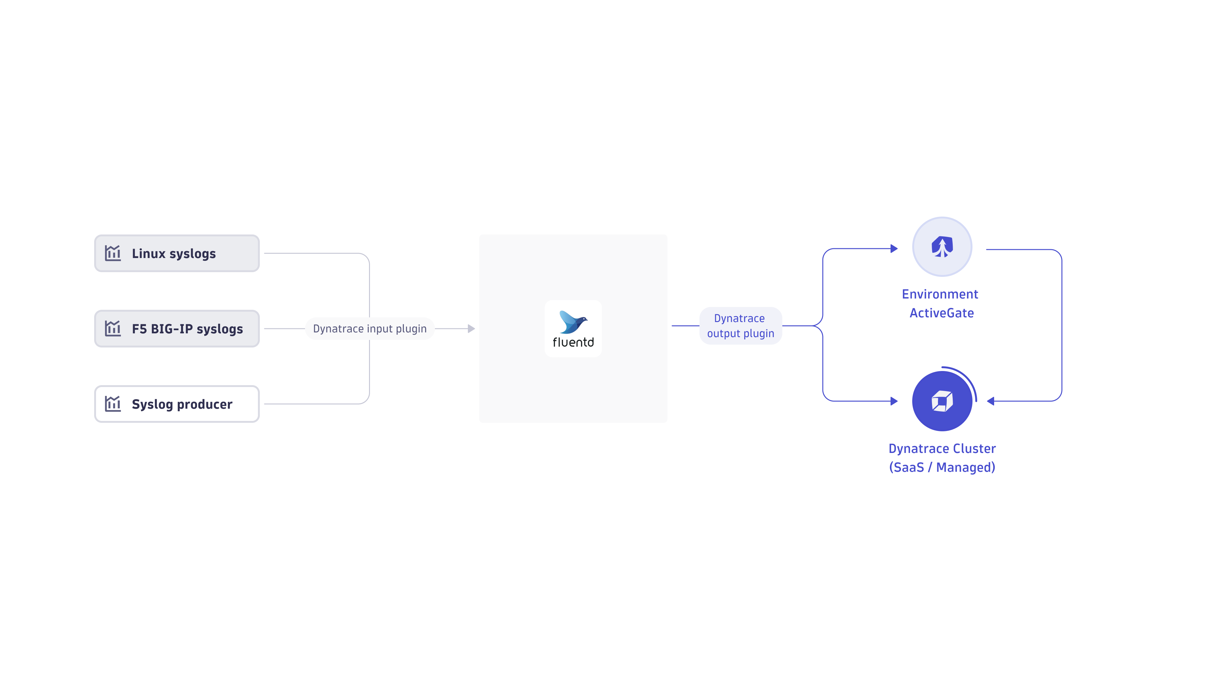

You can send Syslog to Dynatrace using Fluentd. Configure Fluentd to send Syslog to Dynatrace Log ingestion API.
Capabilities
  • Syslog is a standard protocol for message logging and system logs management. Routers, printers, hosts, switches and other devices across platforms use Syslog to log users' activity, system and software lifecycle events, status, or diagnostics.
  • During network monitoring, the remote Syslog server listens to the client's log messages and consolidates the logging data that can be then processed using the capabilities of Dynatrace Log Management and Analytics powered by Grail and Dynatrace AI-driven root cause analysis.
Configuration
Set up the flow from Syslog producer over Fluentd to Dynatrace with the following steps:
  1. Get a Dynatrace API token with the logs.ingest (Ingest Logs) scope.
  2. Deploy Fluentd according to your preferences.
  3. Enable Fluentd to accept incoming Syslog messages.
    • The in_syslog input plugin enables Fluentd to retrieve records via the Syslog protocol on UDP or TCP. It is included in Fluentd's core so no additional installation is needed in this step.
  4. Use the Dynatrace Fluentd plugin to stream logs to the Dynatrace cluster. The open-source Dynatrace Fluentd plugin uses Log ingestion API to send logs to Dynatrace.
  5. Point your devices to send syslogs to Fluentd.
