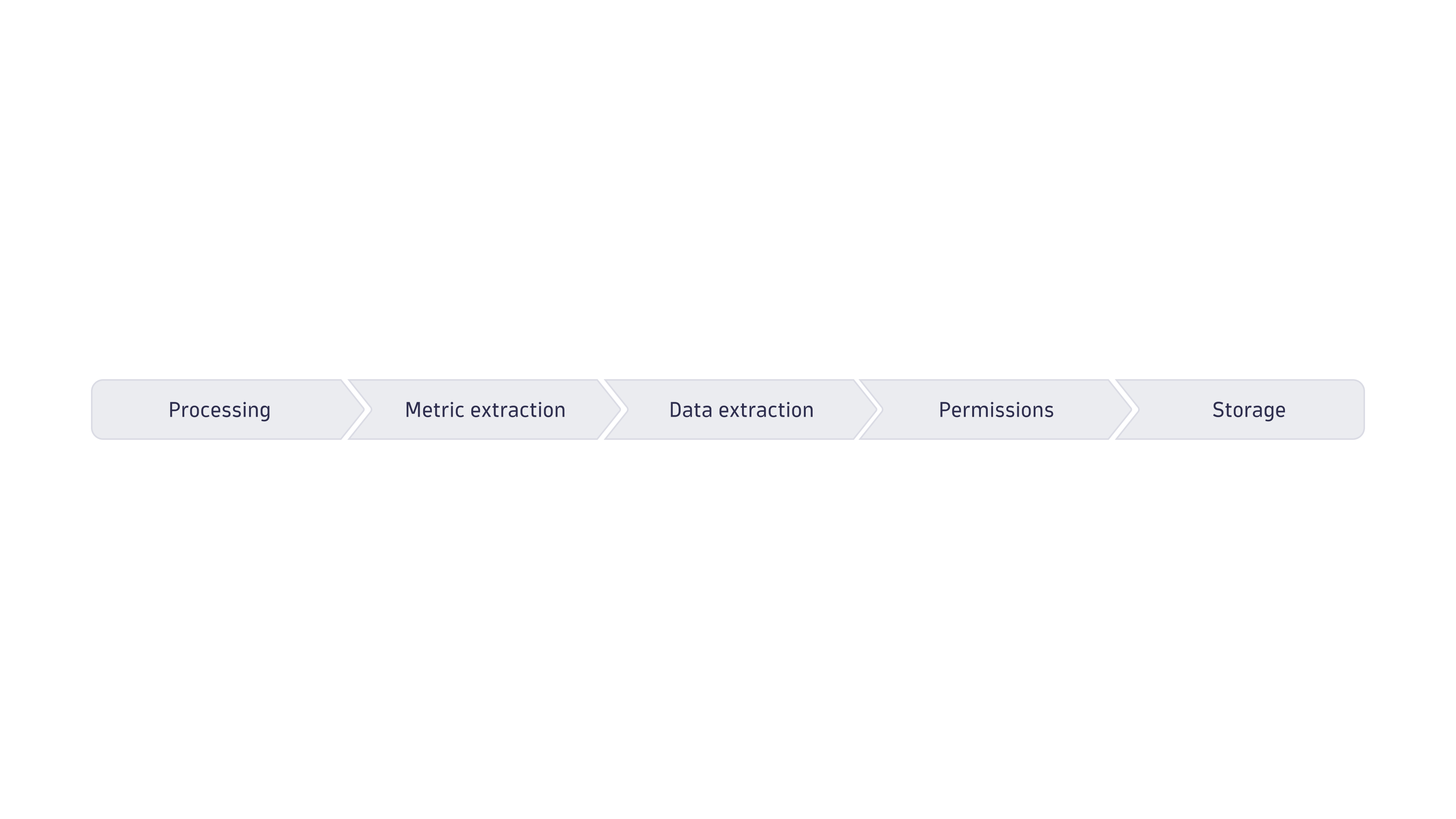

Stage
A stage is a phase in a pipeline sequence that focuses on a task, such as masking, filtering, processing, or extraction. The sequence of stages is fixed for all pipelines and cannot be modified. Stages contain a predefined list of configurable processors, which define the task of the stage. Each stage can execute one or multiple processors.
The following table is a comprehensive list of stages, ordered in the pipeline sequence of execution, specifying which processors are available and executed for each stage, for the supported configuration scopes.
Specific fields are excluded from matching and processing or restricted. To learn more, see Limits specific to fields.
StageDescriptionProcessors in the stageExecuted processorsSupported data types
