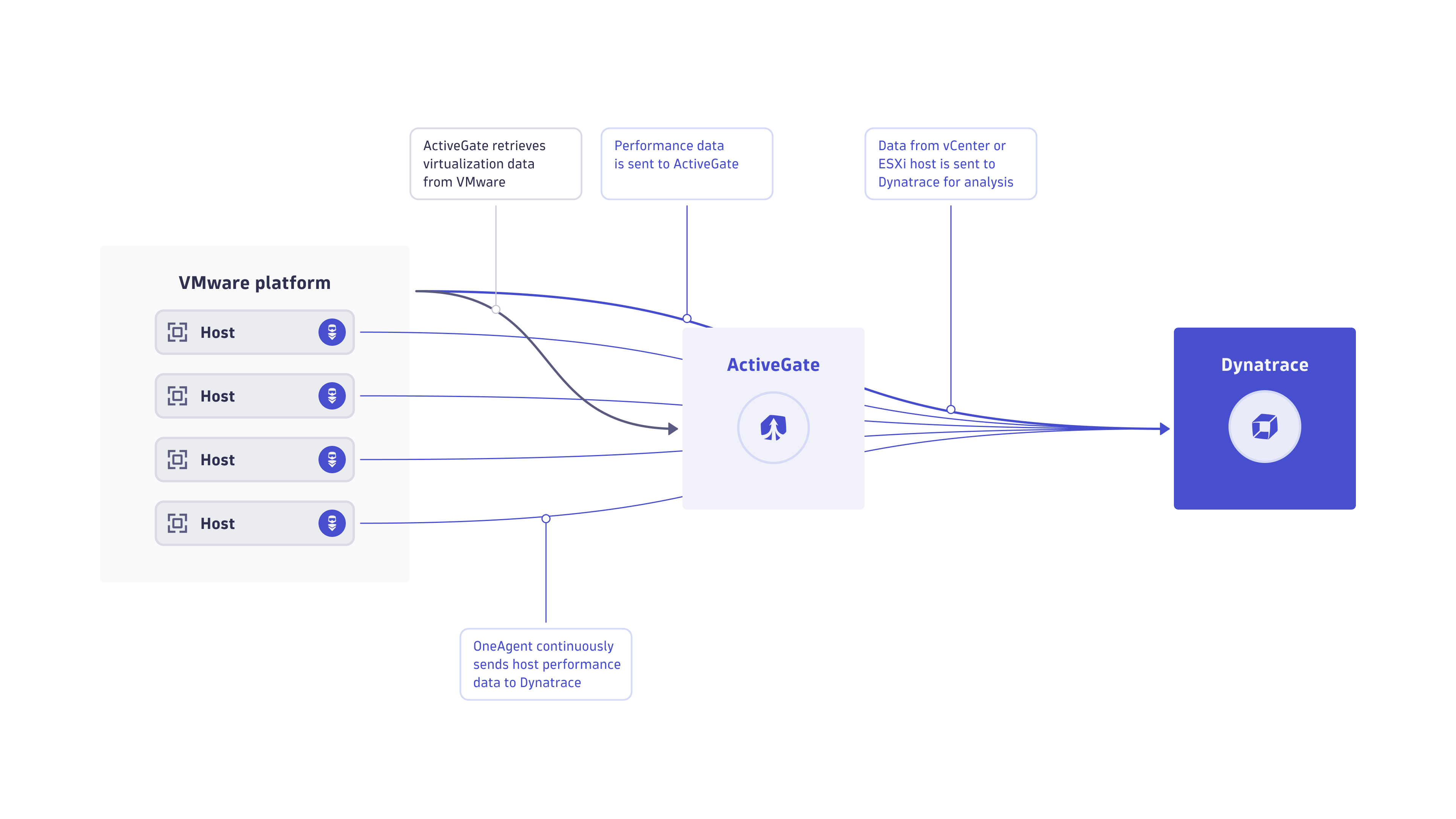

Setting up Dynatrace monitoring of a VMware platform is easy using ActiveGate as a communication gateway.
  • ActiveGate receives the data from VMware and sends it to the Dynatrace Cluster.
  • OneAgent, which is installed on each virtual machine, provides complementary data about your infrastructure health.
Flow of monitoring data from your VMware platform to Dynatrace:
The following applies to VMware only. For other virtualization platforms, you only need to install OneAgent for virtualized host monitoring, as the monitoring of virtualization management layers is supported only for VMware.
