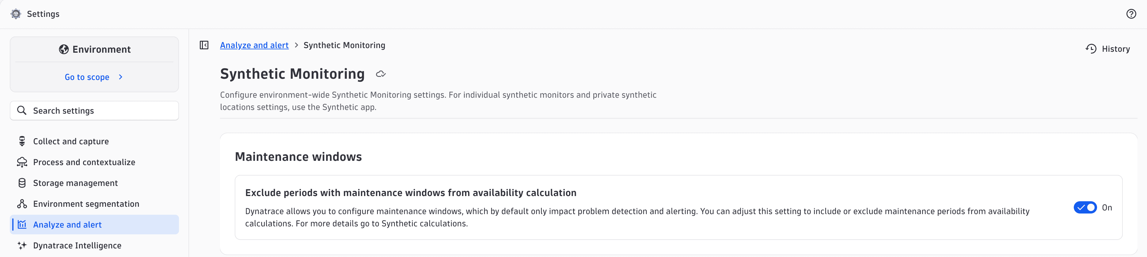

Exclude maintenance period executions from metrics calculations
You can exclude maintenance window periods from availability metrics in two ways:
  • Settings toggle (recommended)—go to Settings > Analyze and alert > Synthetic Monitoring, and turn on Exclude periods with maintenance windows from availability calculation. This applies globally to all synthetic monitors and covers both legacy and current-generation maintenance windows.
  • DQL filter—add the maintenance window dimensions to your query and filter them out manually.
    Current-generation maintenance windows use the maintenance.is_under_maintenance dimension. Legacy maintenance windows use the dt.maintenance_window_ids dimension. To cover both, filter on both dimensions:

Maintenance windows
You can exclude maintenance windows from the availability calculation for synthetic monitors. To always exclude maintenance windows from availability calculations, go to Settings Settings > Analyze and alert > Synthetic Monitoring and turn on Exclude periods with maintenance windows from availability calculation.
Availability calculation
Outages that occur within excluded maintenance windows are still visible in Synthetic Synthetic. The Availability card marks maintenance windows and outages with notifications over the availability chart, and you can still analyze the failed executions, for example, in the Requests waterfall chart. However, failed executions within maintenance periods aren't included in availability calculations.
This setting also applies to retroactive maintenance windows. That is, you can exclude a retroactive maintenance window from synthetic availability calculations for the same period.
