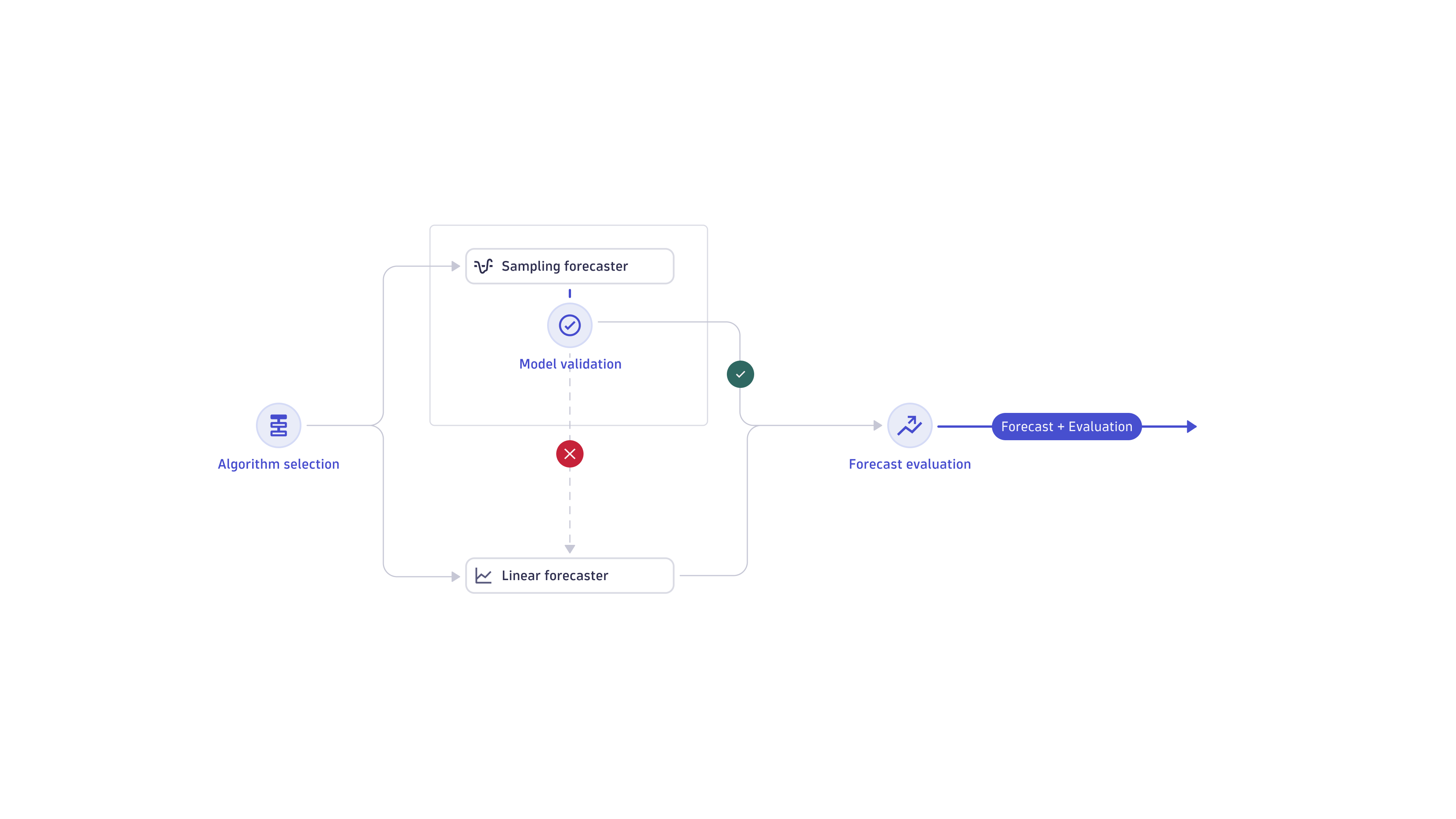

Algorithm selection
The analysis uses one of the two forecasters:
The sampling forecaster is used if the variance of the linear history timeframe is larger than the maximum value of the 0.1 and 0.001 × input time series variance pair. The linear history timeframe is the X most recent data points, with X being in the range from 14 to 20.
In any other case (including the case when training of the sampling forecaster fails), the linear extrapolation forecaster is used.

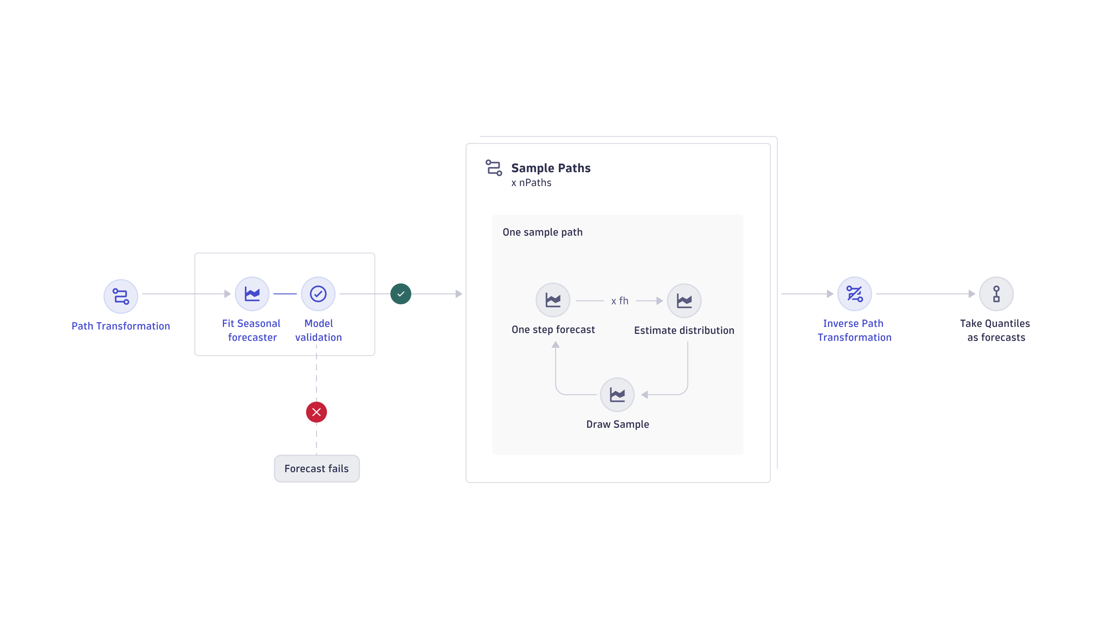

Sampling forecaster
The sampling forecaster provides multi-step forecasts based on seasonal patterns. Its architecture is shown in the image below.
First, the path transformer is applied to the input time series, and then the forecaster is trained on it. If the resulting model is invalid, the linear extrapolation forecaster is used instead. If the model is valid, sampling paths are created by the seasonal forecaster. Those paths are then inverse transformed before applying the quantiles on each time step.
Seasonal patterns
The forecaster always looks for various seasonal patterns in the input time series. The input time series must contain enough data to detect seasonality reliably.
Seasonal patternRequired time series duration
1 hour
2+ hours
1 day (24 hours)
7+ days
1 week (7 days)
14+ days
Day of week
7+ days
Time of day
2+ days
Minute of hour
2+ hours
Apart from those natural patterns, the forecaster looks for any repetitive patterns in the time series by breaking them based on a certain time window.
Forecast step-by-step
  1. The seasonal forecaster estimates quartiles of the time series distribution at the time stamp of the next data point.
  2. The distribution for the value at the next time step is estimated from the quartiles. The bell curve in the image is for illustrative purposes and doesn't represent the distribution used in the sampling forecaster.
  3. The value for the next time step is sampled from the distribution obtained in step 2.
  4. The value obtained in step 3 is now considered a part of the time series, and the forecaster repeats steps 1 to 4 until it reaches the forecast horizon.
  5. The predicted data points form a single sampling path (shown in red in the image below).
  6. The forecaster repeats this process N times, creating multiple sampling paths.
  7. The forecaster takes the sought-after quantile at each time step, forming the prediction interval (shown in light purple in the image below).

Forecast quality assessment
After the predictions are generated, we assess their quality to spot potential numerical problems. To assess the forecast quality, the analyzer compares the standard deviation of the prediction to the standard deviation of the input time series (SDinput).
The standard deviation of the predictions (SDprediction) is calculated as the maximum standard deviation of the lower and upper bounds of the prediction interval as well as the standard deviation of the point prediction.
To account for acceptable trends in the predictions, the analyzer uses a scaling factor (SCF). When the length of the prediction data (Nprediction) is large compared to the input time series (Ninput), we allow a larger standard deviation of the prediction than for a small prediction.
Additional input into the scale factor is the Standard deviation factor (SDfactor), with a default value of 100. The scale factor is calculated as follows:
The forecast is evaluated by the following condition:
If the condition is satisfied, the forecast is assessed as valid. Otherwise, the forecast is invalid.
