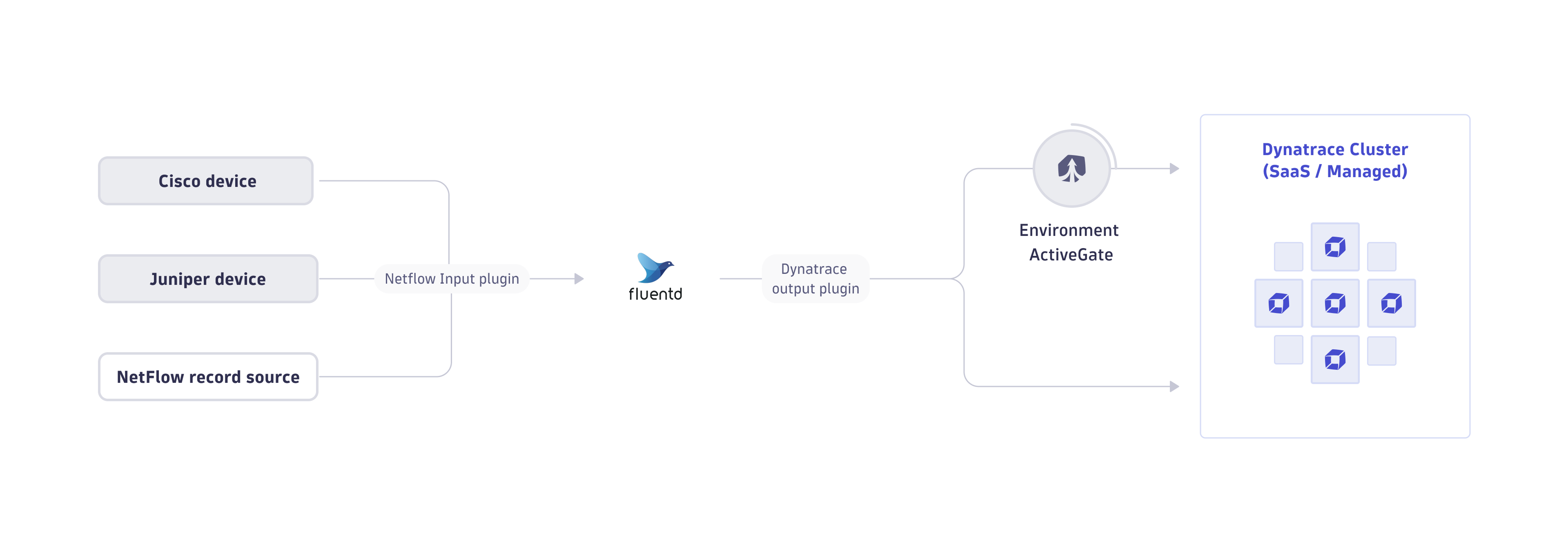

You can send network flows to Dynatrace using Fluentd. Configure the Fluentd plugin to send NetFlow records to Dynatrace generic ingest API. Other Fluentd plugins, which offer support for other NetFlow protocols like IPFIX or sFlow, are available as well.
Streaming NetFlow to Dynatrace with Fluentd

Set up the pipeline from NetFlow records producer over Fluentd to Dynatrace with the following steps:
  1. Get a Dynatrace API token with the logs.ingest (Ingest Logs) scope.
  2. Deploy Fluentd according to your preferences.
    • Deploy Fluentd. Fluentd can also run as a DaemonSet in a Kubernetes cluster. Built-in resiliency ensures data completeness and consistency even if Fluentd or an endpoint service temporarily goes down.
  3. Install a NetFlow Fluentd plugin, for example, repeatedly.
  4. Configure the NetFlow plugin:
    <source>
    @type netflow
    tag netflow.event
    By default, the plugin is configured to receive NetFlow v9 packets from any source (0.0.0.0) on port 5140, with a 4000-second cache refresh timeout. If these parameters meet the requirements, nothing else is needed. However, the following parameters can be modified to fit specific needs:
    # optional parameters
    bind 0.0.0.0
    port 5140
    cache_ttl 4000
    versions 9
    definitions /path/to/custom_fields.yaml
    </source>
  5. Use the Dynatrace Fluentd plugin to stream logs created by the NetFlow Fluentd plugin to Dynatrace. The open-source Dynatrace Fluentd plugin uses generic log ingestion via Log Monitoring API v2 - POST ingest logs.
  6. Point your network devices to send NetFlow records to Fluentd.
