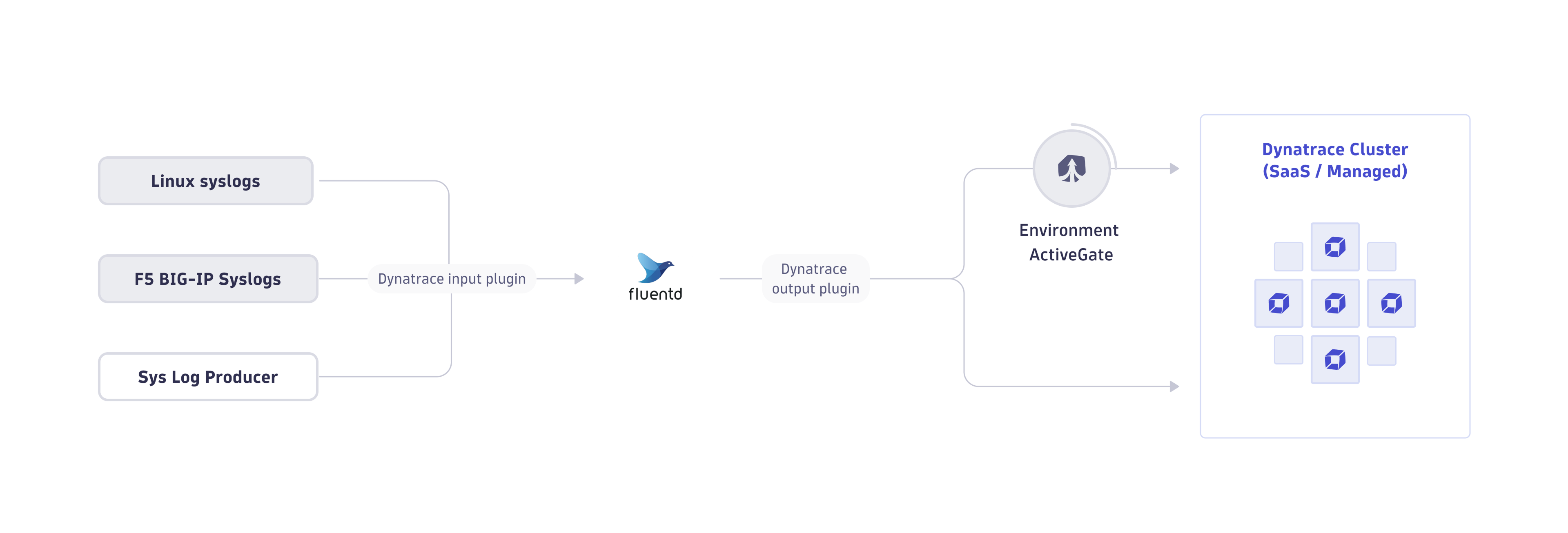

You can send Syslog to Dynatrace using Fluentd. Configure Fluentd to send Syslog to Dynatrace Log ingestion API.
Diagram showing the flow of Syslog ingest via Fluentd

Set up the flow from Syslog producer over Fluentd to Dynatrace with the following steps:
  1. Get a Dynatrace API token with the logs.ingest (Ingest Logs) scope.
  2. Deploy Fluentd according to your preferences.
    • Deploy Fluentd. Fluentd can also run as a DaemonSet in a Kubernetes cluster. Built-in resiliency ensures data completeness and consistency even if Fluentd or an endpoint service temporarily goes down.
  3. Enable Fluentd to accept incoming Syslog messages.
    • The in_syslog input plugin enables Fluentd to retrieve records via the Syslog protocol on UDP or TCP. It is included in Fluentd's core so no additional installation is needed in this step.
  4. Use the Dynatrace Fluentd plugin to stream logs to the Dynatrace cluster. The open-source Dynatrace Fluentd plugin uses Log ingestion API to send logs to Dynatrace.
  5. Point your devices to send syslogs to Fluentd.
