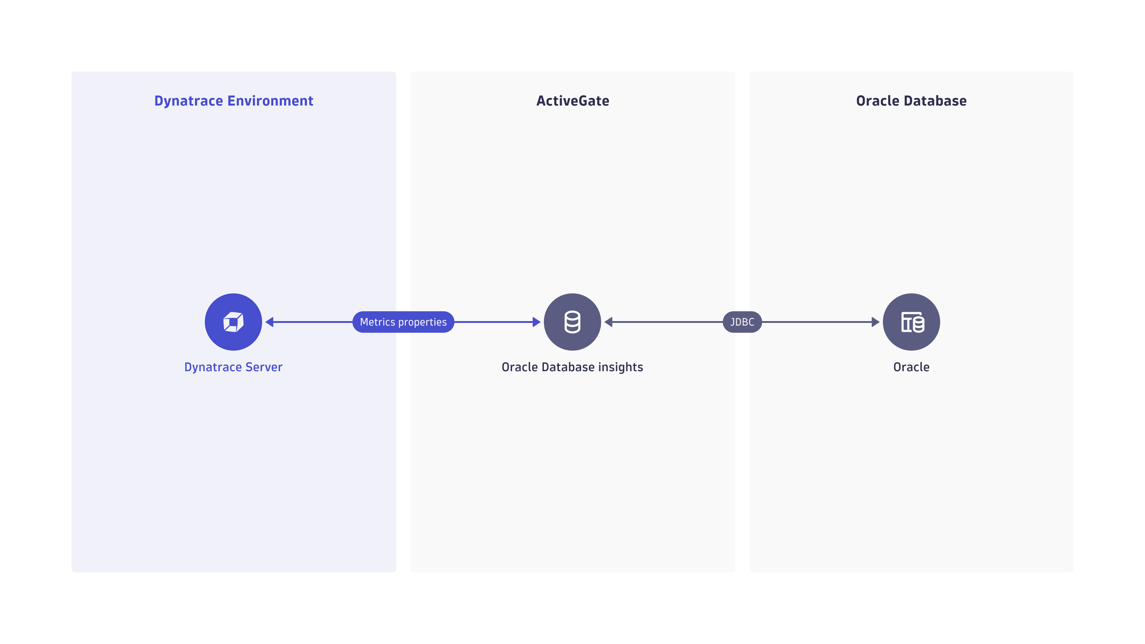

How it works
Database insights runs on an Environment ActiveGate and connects remotely to Oracle databases. With this approach, the database system platform can be of any type—Dynatrace supports all operating systems using the JDBC driver to connect to databases.
Oracle insights architecture
