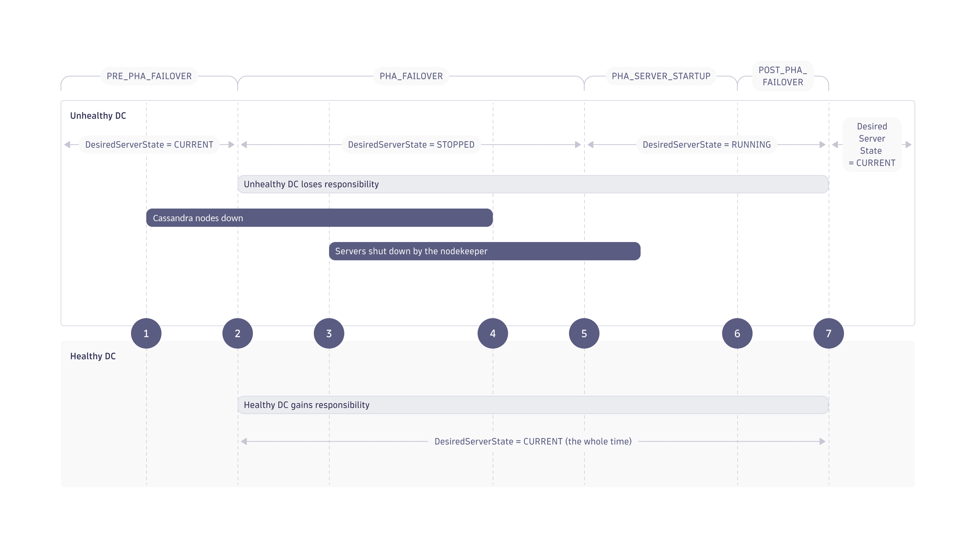

Cassandra failover mechanism
The following graphic illustrates the PHA failover mechanism when two or more Cassandra nodes in a DC are down.
  1. Mission Control detects that two or more Cassandra nodes in a DC are down (this is later referred to as an unhealthy DC).
  2. After 15 minutes, Mission Control informs all Nodekeepers that one DC is unhealthy and requests a change of the responsibility override to the healthy DC. Mission Control also requests Nodekeepers to stop all server processes in the unhealthy DC.
  3. Nodekeepers stop server processes in the unhealthy DC, switch responsibility override, and ask a healthy server to generate an event and an email.
  4. After you start the Cassandra processes on the nodes that were down, Mission Control requests that Nodekeepers start all server processes.
  5. MC initiates server startup (sending the desired server state to RUNNING). If Cassandra was down for three hours or more, Nodekeepers also run Cassandra repairs, one by one, on all nodes in the unhealthy DC.
  6. Thirty minutes after all Cassandra nodes are repaired, Mission Control requests the Nodekeepers to change the responsibility override, and the Managed Cluster is fully operational.
