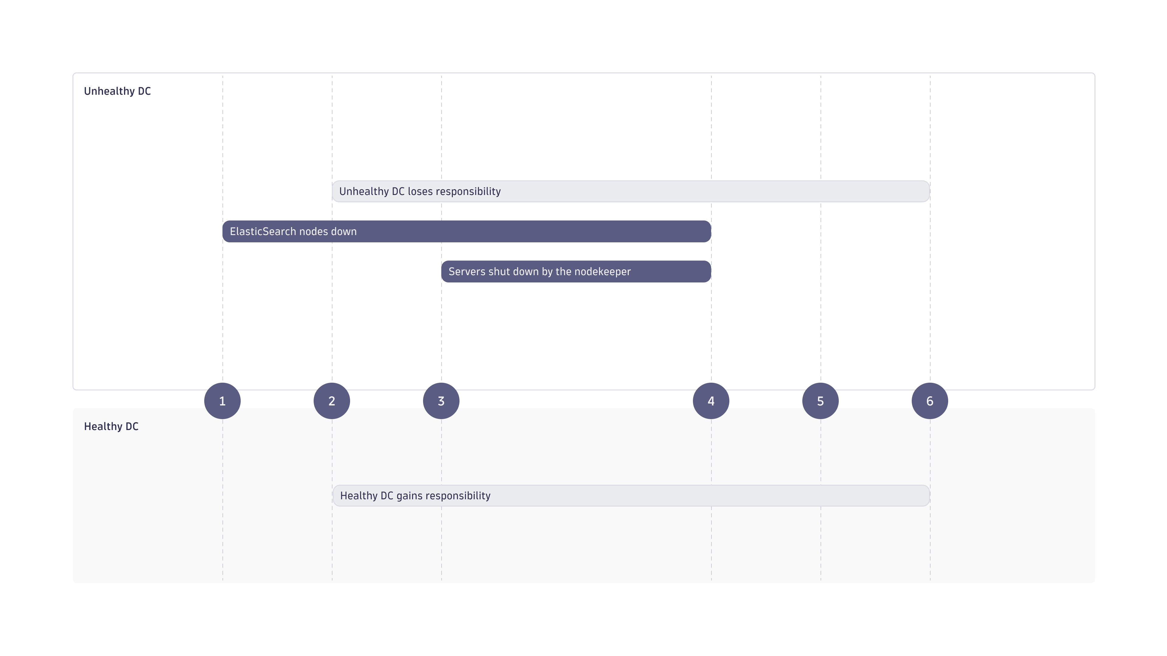

Premium HA failover triggered by Elasticsearch downtime
The following graphic illustrates the Premium HA failover mechanism when two or more Elasticsearch nodes in a DC are down.
Elasticsearch failover mechanism
  1. Mission Control detects that two or more Elasticsearch nodes in a DC are down (this is later referred to as an unhealthy DC).
  2. After 15 minutes, Mission Control informs all Nodekeepers that one DC is unhealthy, requests to change the responsibility override (to the healthy DC), and requests Nodekeepers to stop all server processes in the unhealthy DC.
  3. Nodekeepers stop server processes in the unhealthy DC, switch responsibility override, and ask a healthy server to generate an event and an email.
  4. After you start the Elasticsearch processes on the nodes that were down, Mission Control requests that Nodekeepers start all server processes.
  5. All servers are up and running.
  6. After 30 minutes, Mission Control requests the Nodekeepers to change the responsibility override—the cluster is fully operational.

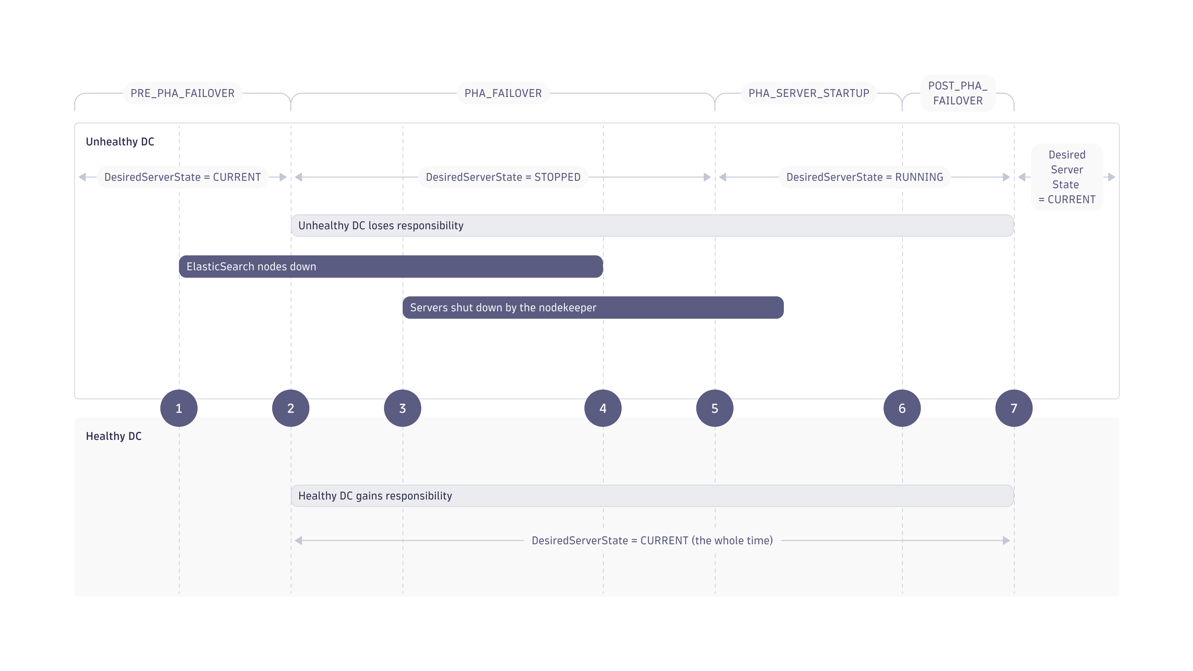

Premium HA failover triggered by Cassandra downtime
The following graphic illustrates the Premium HA failover mechanism when two or more Cassandra nodes in a DC are down.
Cassandra failover mechanism
  1. Mission Control detects that two or more Cassandra nodes in a DC are down (this is later referred to as an unhealthy DC).
  4. After you start the Cassandra processes on the nodes that were down, Mission Control requests that Nodekeepers start all server processes.
  5. Nodekeepers run Cassandra repairs, one by one, on all nodes in the unhealthy DC. At the same time server start up is initiated (MC sends desired server state to RUNNING).
  6. 30 minutes after all Cassandra nodes are repaired, Mission Control requests the Nodekeepers to change the responsibility override—the cluster is fully operational.
