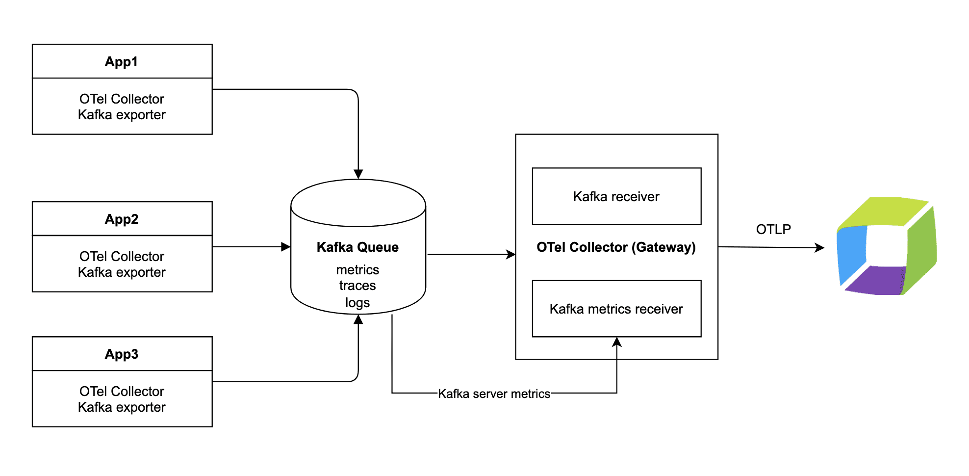

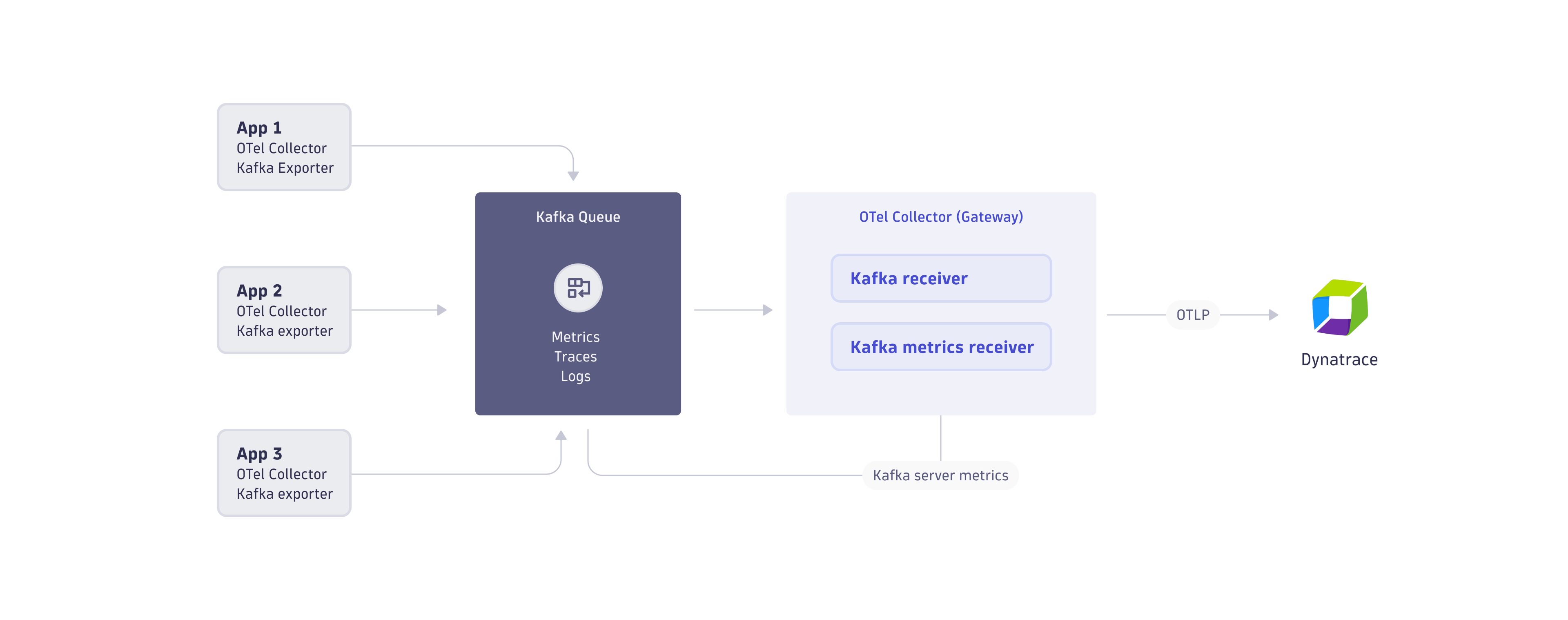

Overview
You can configure Kafka exporter, Kafka receiver, and Kafka Metrics receiver components, as shown in the figure below.
  • Exporter: Write OTLP data as Kafka messages on a per-signal basis (otlp_logs, otlp_metrics, otlp_spans).
  • Receiver: Consume traces, metrics, and logs from Apache Kafka topics, and then forward these to backends such as Dynatrace.
  • Kafka metrics receiver: Collect Kafka’s own operational metrics (for example, broker count) via OTLP and export them to Dynatrace.
Note that running Kafka may introduce additional end-to-end latencies, operational overhead, and potential bottlenecks.
