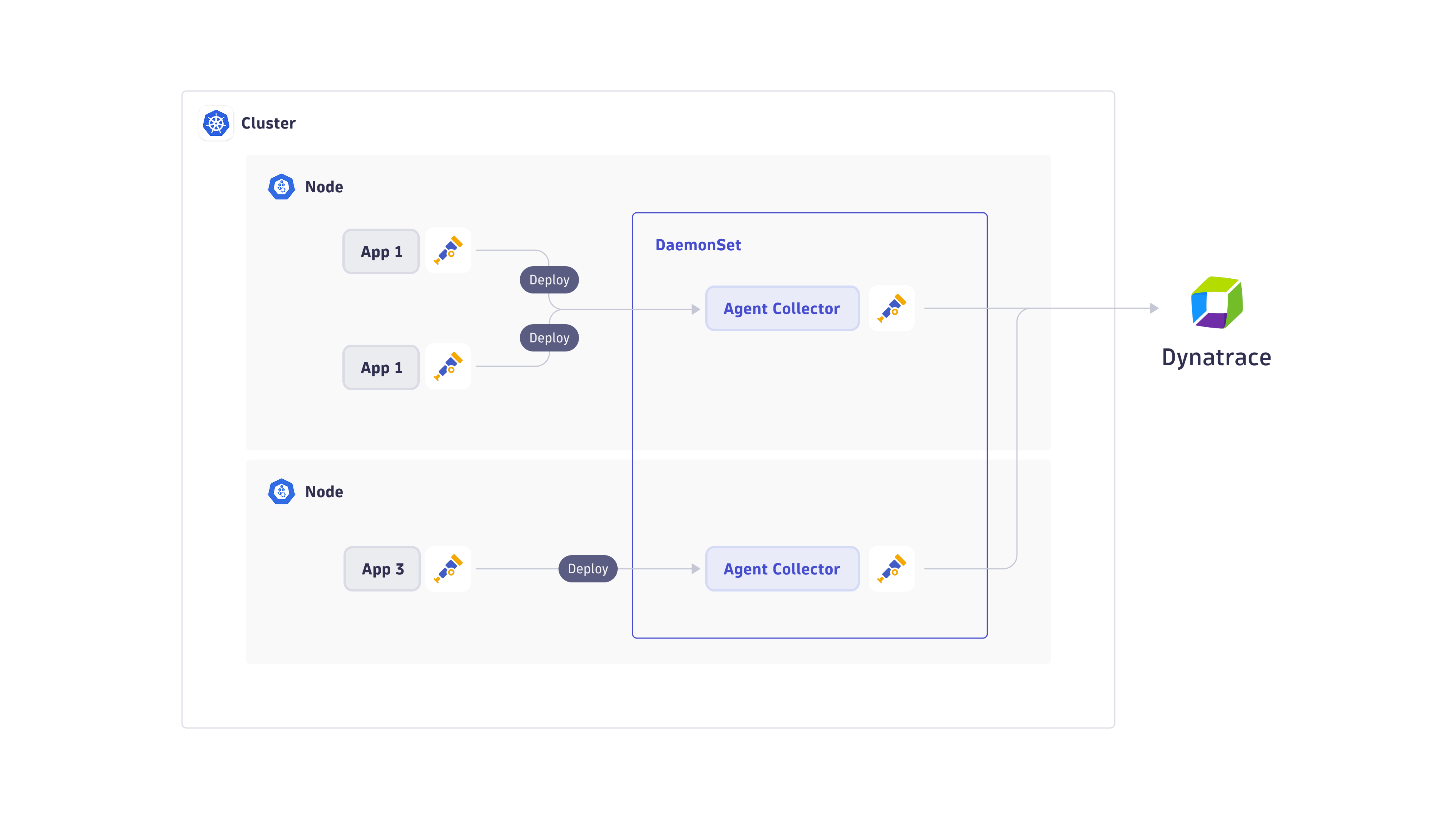

As an agent, the Dynatrace OTel Collector is deployed either with the application or on the same host as the application. This Dynatrace OTel Collector can receive telemetry data and enhance it with, for example, tags or infrastructure information.
OTel Collector as agent

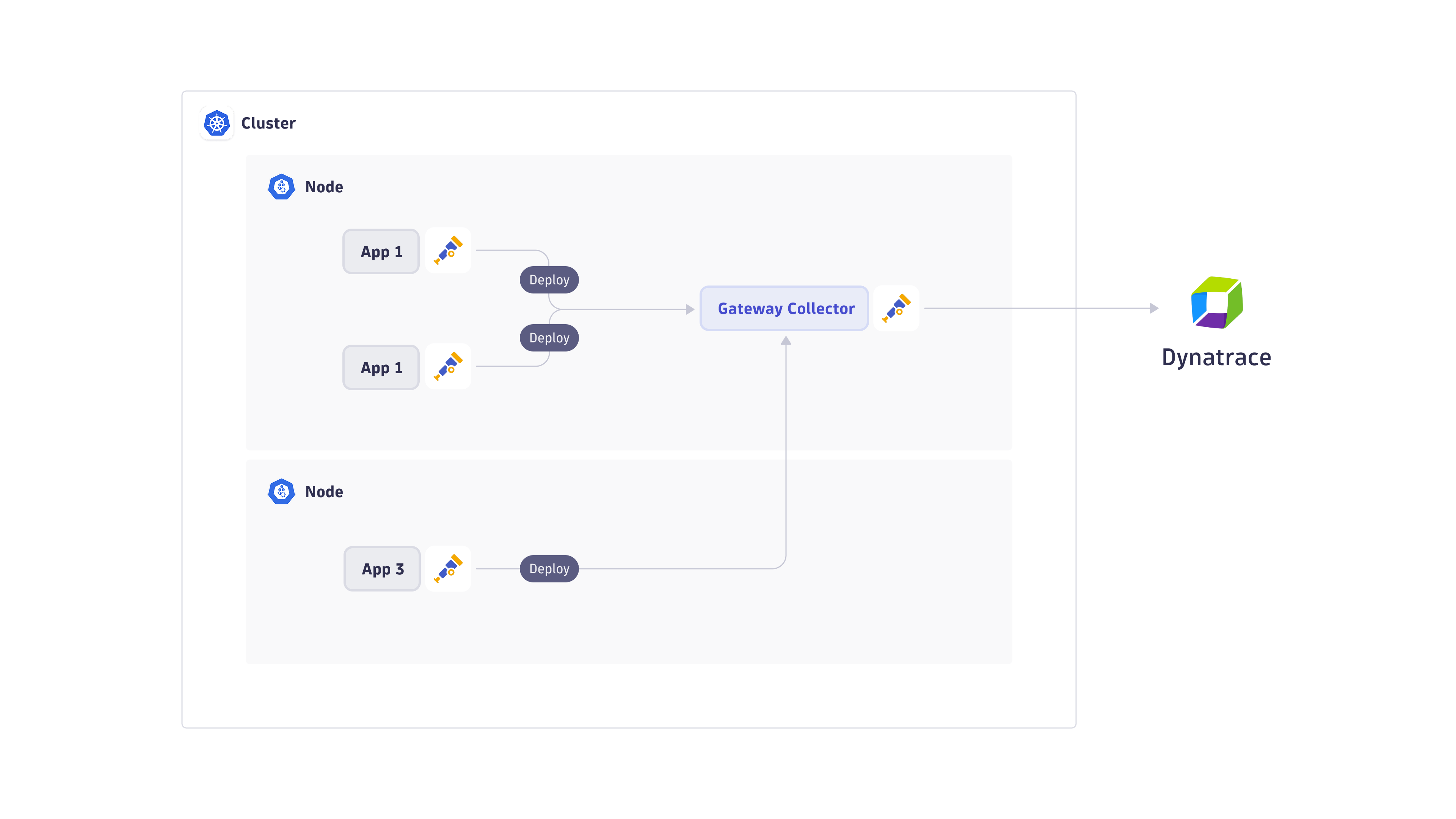

As a gateway, one or more Dynatrace OTel Collector instances can be deployed as standalone services. This Dynatrace OTel Collector can be deployed additionally, for example, per cluster, region, or data center. A load balancer can help scale the independently operating Dynatrace OTel Collector instances.
OTel Collector as gateway
