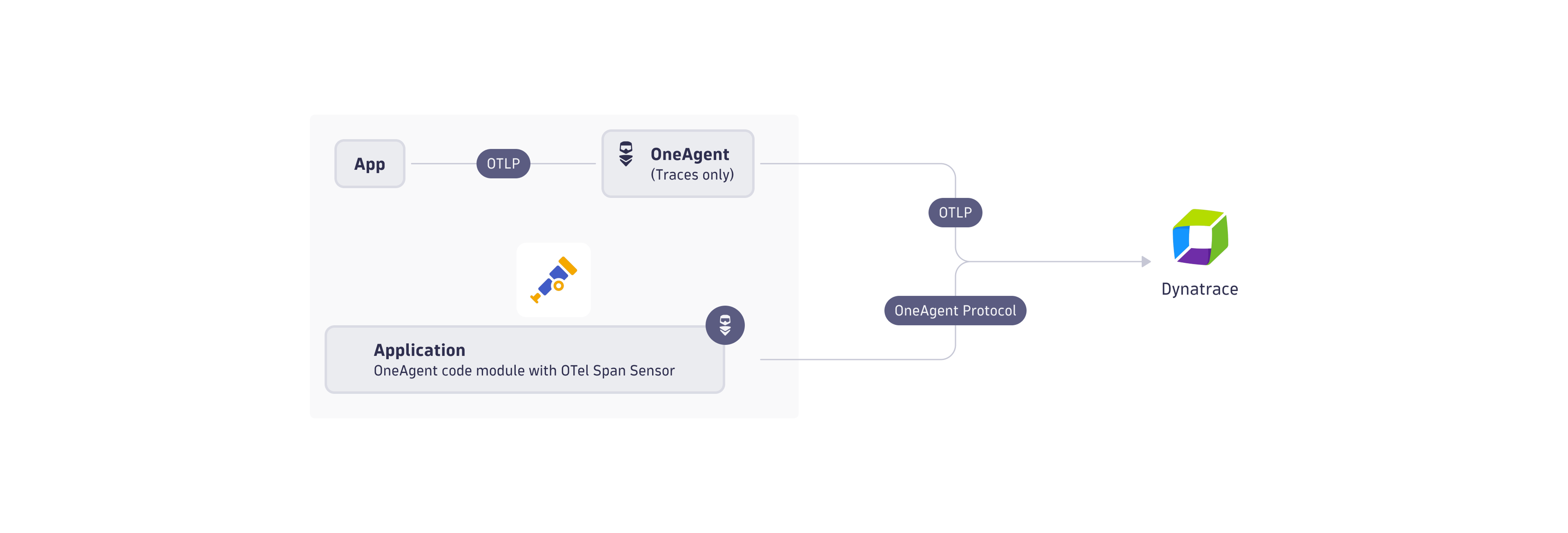

OneAgent send data to Dynatrace
For most use cases, Dynatrace recommends exporting OTLP directly to Dynatrace without deploying a OneAgent.
Send OpenTelemetry traces to the OTLP endpoint exposed by OneAgent
Dynatrace OneAgent offers a local-only OTLP endpoint for traces. This is shown in the figure above, where the application uses the local-only OTLP endpoint.

Detect OpenTelemetry spans using the OneAgent code module's OpenTelemetry Span Sensor
The OneAgent code module includes an OpenTelemetry Span Sensor which can create new spans based on OpenTelemetry API calls. This is shown in the figure above, where the code module (with the OpenTelemetry Span Sensor) sends data via the OpenTelemetry protocol.
