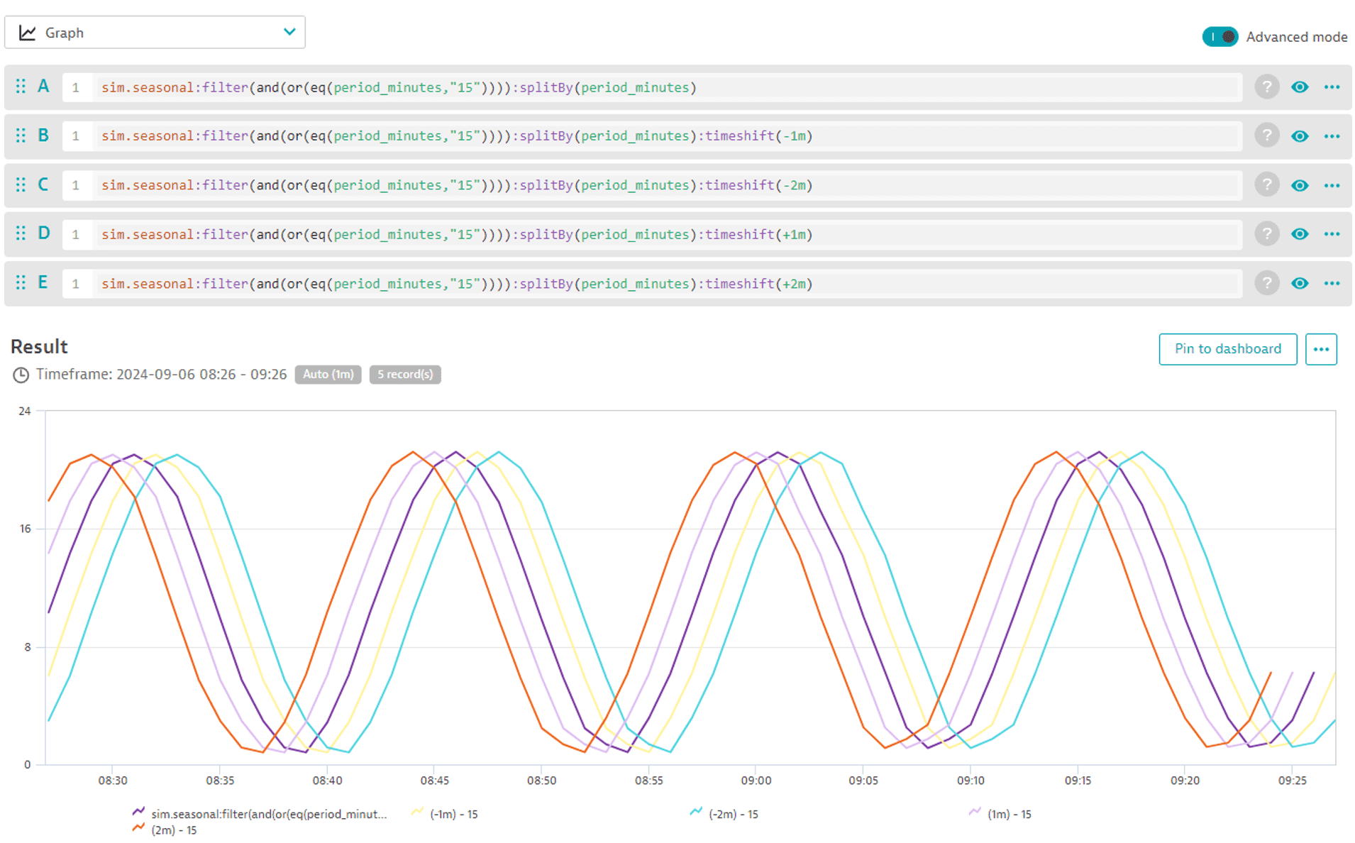

The time shift transformation aims to cope with signals that are similar in behavior but shifted in time. Possible reasons for such a shift include signal source delays or differences in the measurement cycles used by sensors.
The analysis automatically includes positive and negative shifts of up to 2 resolution steps to the candidates set. The image below illustrates this subset of candidates: an original time series in one-minute resolution plus one- and two-minute shifts in each direction.
Timeshift tranformation data explorer
A penalty of 0.004 is deducted from the score per shift in either direction. For example, the time series shifted two steps into the past receives the penalty of 0.008 and the one shifted one step into the future receives the penalty of 0.004.

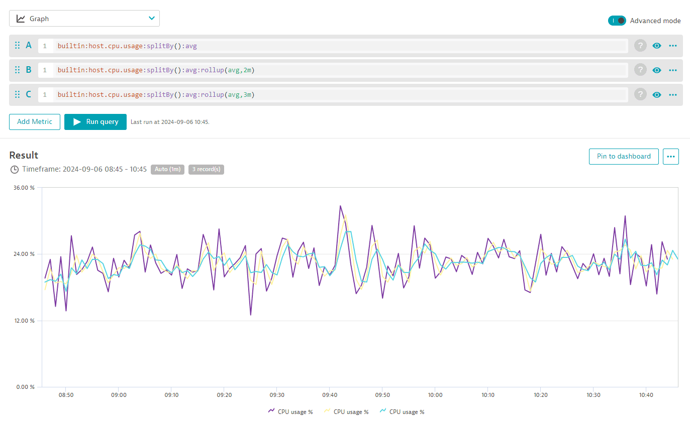

Casual correlation analysis automatically includes smoothing transformations of moving averages of two and three resolution steps to the candidates set. The image below illustrates this subset of candidates: an original time series in one-minute resolution plus two- and three-minute moving averages.
Smoothing transformation data explorer
The penalty for the smoothing transformation is calculated using the following formula: 0.01 × (window width − 1).
