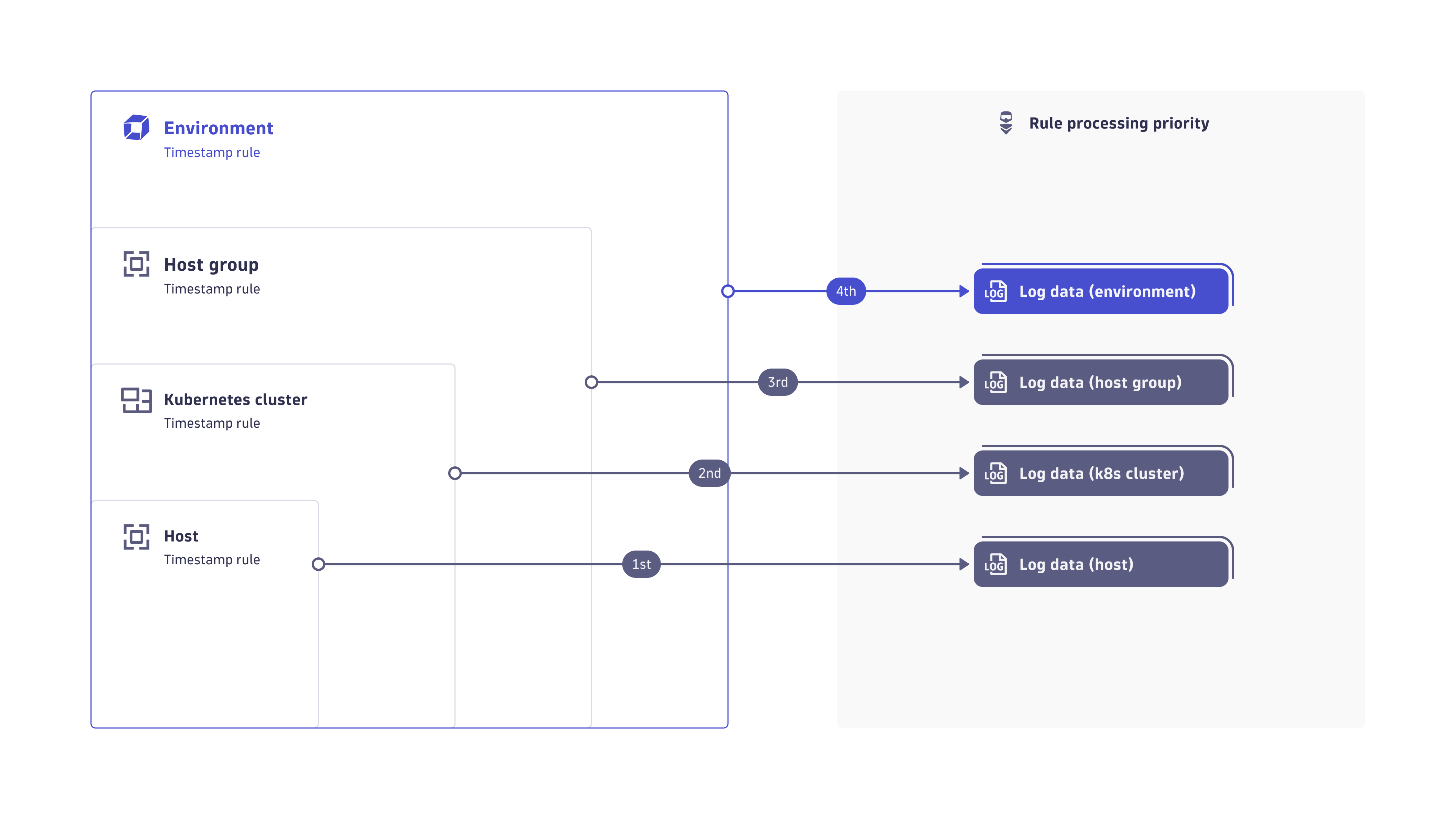

Supported scopes
Three hierarchy scopes are supported: host, host group, and environment.
The hierarchy scopes are merged into one list in the following order:
  1. Host rules
  2. Host group rules
  3. Environment rules
The priority of timestamp configuration rules
The OneAgent receives the merged list (merged lists from its respective hosts, host groups, and environments) with no indication of which scopes are defined.
