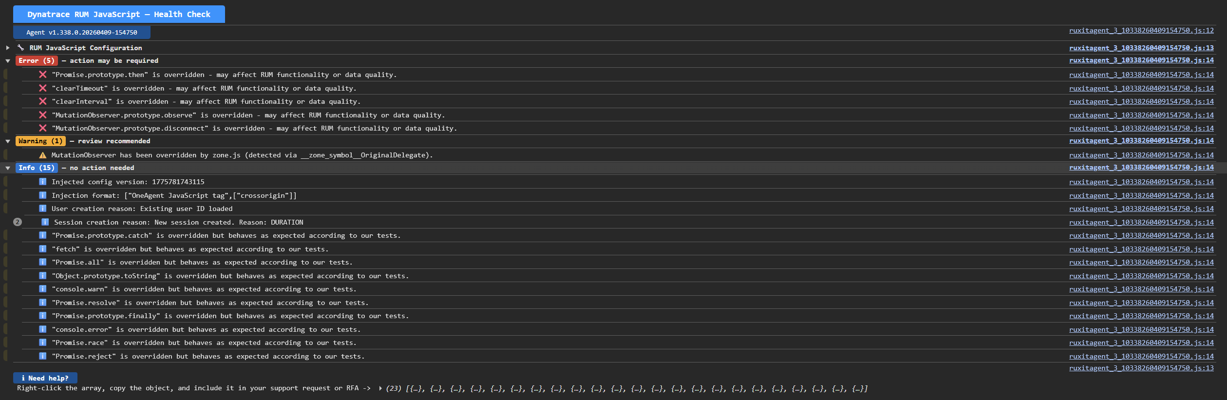

    The RUM JavaScript has a built-in Health check.
    On Version 1.337 or lower it can be invoked by calling
    dynatrace.runHealthCheck();
    On Version 1.339 and higher it can be invoked by calling
    await dynatrace.loadDebugTools();
    dynatrace.debugtools.runHealthCheck();
    The output looks like this:
    Findings have a severity assigned and are grouped by severity:
    Level Meaning
    ❌ ERROR A feature is completely broken with no usable fallback, AND the user can fix it — typically by correcting their configuration or addressing a runtime error in their integration. Immediate attention recommended.
    ⚠️ WARNING Something unexpected happened and data is being silently lost, or a feature is degraded but falls back to a reasonable default. The user may not notice without actively checking, but monitoring quality is affected. Any form of data drop — rate limiting, size limits, off state, browser limitations, or a discarded user action — belongs here.
    ℹ️ INFO A normal operational event useful for diagnosing behavior. No data is lost and no action is required. These messages describe expected lifecycle transitions (e.g. sessions starting, config versions loading, injection format detection).
    🔎 VERBOSE Fine-grained trace-level events primarily useful for debugging internals. High-frequency details that are too noisy for routine monitoring but valuable when investigating a specific issue.
    An internal Health check threw an unexpected error while running. The affected check produced no results.

    The RUM JavaScript detected that the function or object <XYZ> is no longer a native implementation. There are five variants of this message:
    • "<XYZ>" is overridden - may affect RUM functionality or data quality. (❌ ERROR)
      Something other than the RUM JavaScript has overridden a function that the RUM JavaScript actively uses, and the RUM JavaScript's tests confirmed the override does not behave as expected. This can lead to broken functionality or silent data loss.
    • "<XYZ>" is overridden and re-wrapped after RUM JavaScript. (⚠️ WARNING)
      The RUM JavaScript overrides this function for monitoring purposes, but something on the page has wrapped it again afterward. Data quality may be affected.
    • "<XYZ>" is overridden. RUM JavaScript would use it if modules (<modules>) are enabled. (⚠️ WARNING)
      The RUM JavaScript overrides this function in the listed modules, but those modules are not currently active. The override has no effect at the moment.
    • "<XYZ>" is overridden but behaves as expected according to our tests. (ℹ️ INFO)
      Something other than the RUM JavaScript has overridden the function, but the RUM JavaScript's built-in tests confirm the wrapped version still behaves correctly. No action required.
    • "<XYZ>" is overridden but not used by any active module. (ℹ️ INFO)
      The function is overridden by a third party, but no currently active RUM JavaScript module relies on it. No data quality impact expected.
    Mitigation: If you get the ❌ ERROR message, you can expand the object below the table to get more information. You expand the "details" of the entry and then it will show "function" and either "classic", "rumOnGrail" or both. If you expand those properties further, you can see where the implementation is, if it is not the native implementation. There might be some incompatibility between the custom implementation and what the official spec for the implementation states/what the RUM JavaScript expects.
    Example:
    • The Health check mentions e.g. clearInterval as being overridden.
    • Expand the Array shown below the table until you reach the details of the "clearInterval" is overridden finding.
