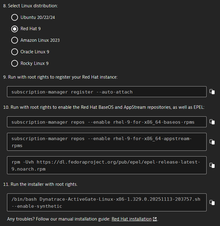

  11. Linux only Select a Linux distribution.
  12. Run the installer and any other commands—make sure you use the exact commands displayed in the UI.
    Linux only The installer automatically downloads the browser and dependencies required by the Synthetic engine. On Red Hat, Oracle Linux, and Rocky Linux you also need to enable repositories from which the installer downloads the dependencies. As a prerequisite for enabling proprietary repositories on Red Hat, you need to register your Red Hat instance. The web UI provides you with all the required commands for doing so, as shown in the example below.
  13. Verify the ActiveGate installation (Show deployment status).

  1. Set up repositories and install dependencies.
    Deprecated operating system
    ActiveGate version 1.325 is the last Synthetic-enabled ActiveGate to support Red Hat 8.
    • Register the Red Hat instance.
      sudo subscription-manager register --auto-attach
    • Enable the Red Hat Extras and Optional repositories as well as EPEL (Extra Packages for Enterprise Linux ).
      sudo subscription-manager repos --enable rhel-8-for-x86_64-baseos-rpms
      sudo subscription-manager repos --enable rhel-8-for-x86_64-appstream-rpms
      sudo rpm -Uvh https://dl.fedoraproject.org/pub/epel/epel-release-latest-8.noarch.rpm
    • Install Synthetic engine dependencies.
      sudo yum install -y xorg-x11-server-Xvfb xorg-x11-xkb-utils xorg-x11-server-utils xorg-x11-fonts-100dpi xorg-x11-fonts-75dpi xorg-x11-fonts-Type1 libwayland-server mesa-libgbm curl nss-tools

  5. After you satisfy the dependencies, run the ActiveGate installer with root rights with the --enable-synthetic parameter set to manual. For example:
    /bin/bash ./Dynatrace-ActiveGate-Linux.sh --enable-synthetic=manual

  4. Resolve all dependencies and enable repositories as required as shown in Install the browser and dependencies manually from S3 above. The custom repository can be used only for browser packages, not their dependencies.
  5. Install the ActiveGate with the Synthetic module enabled (--enable-synthetic) and the DYNATRACE_SYNTHETIC_CUSTOM_CHROMIUM_REPO environment variable pointing to the location of the custom repository (https://172.18.0.100/chromium-repo in this example).
