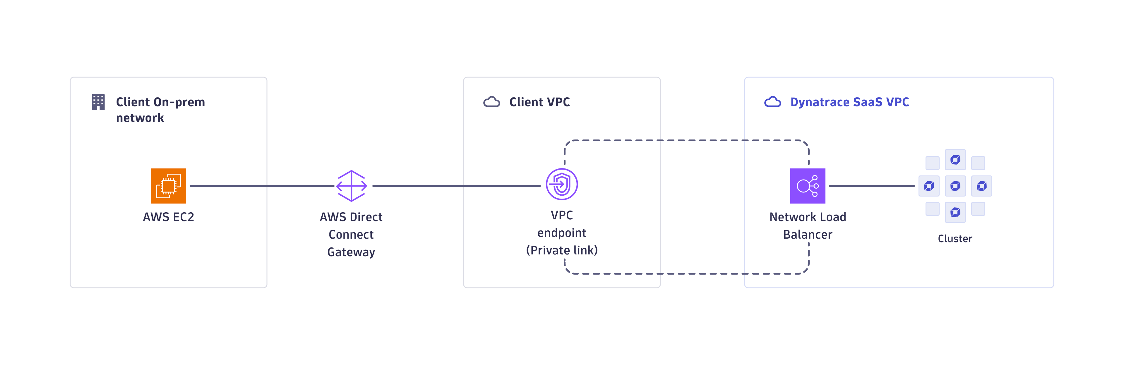

The primary use case for PrivateLink with Dynatrace is connectivity for monitored applications running in AWS VPCs. Dynatrace will not use Interface VPC endpoints to access Amazon CloudWatch and services such as EC2 or ELB.
PrivateLink connectivity overview
However, it’s also possible to use AWS VPCs for on-premises applications, provided that you use DirectConnect or VPN Gateway to connect your network to a VPC in a given region.
The interface VPC Endpoint (PrivateLink) must be created in the VPC that's located in the same region as the Dynatrace environment. However, you can still monitor hosts running in a different VPC, including a VPC located in a different region.
