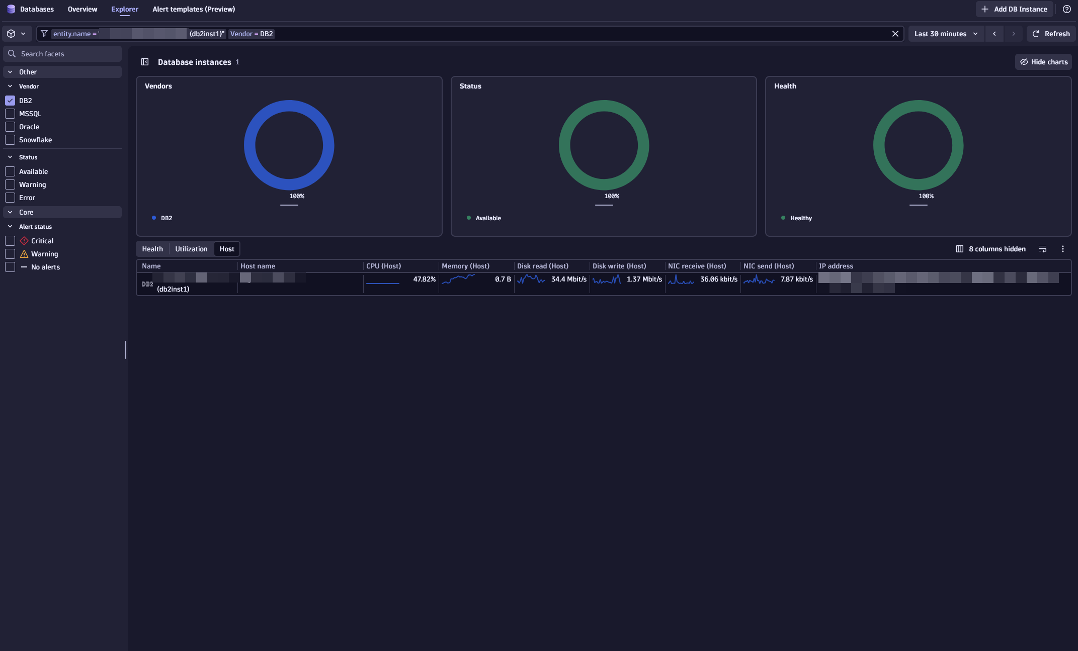

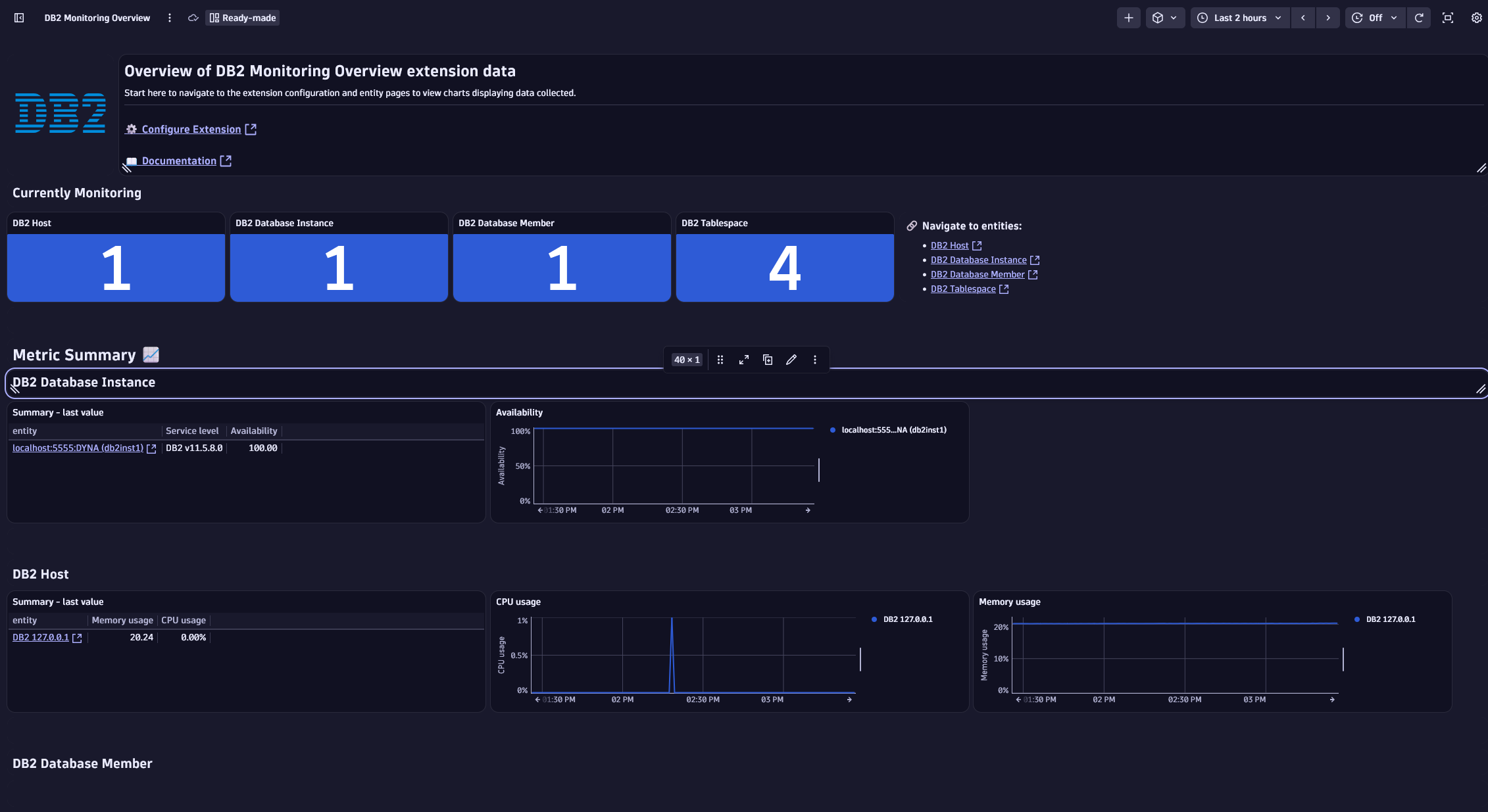

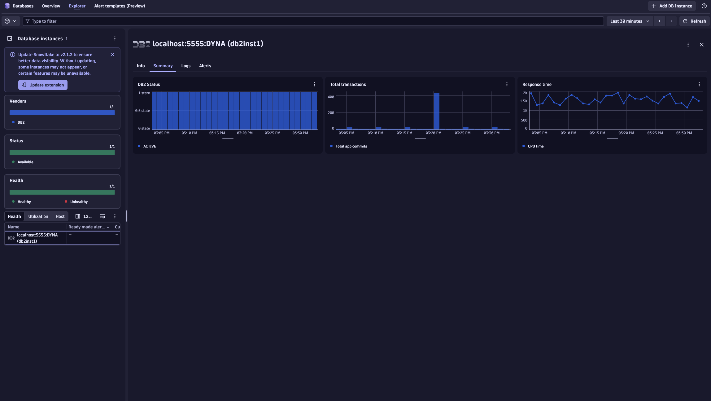

The included DB2 dashboard in the Dashboards App.The DB2 database instance entity as seen in the Databases App.The database host as seen in the Databases App. This data comes from the OneAgent when a host is also monitored by the extension.
1 of 3The included DB2 dashboard in the Dashboards App.
