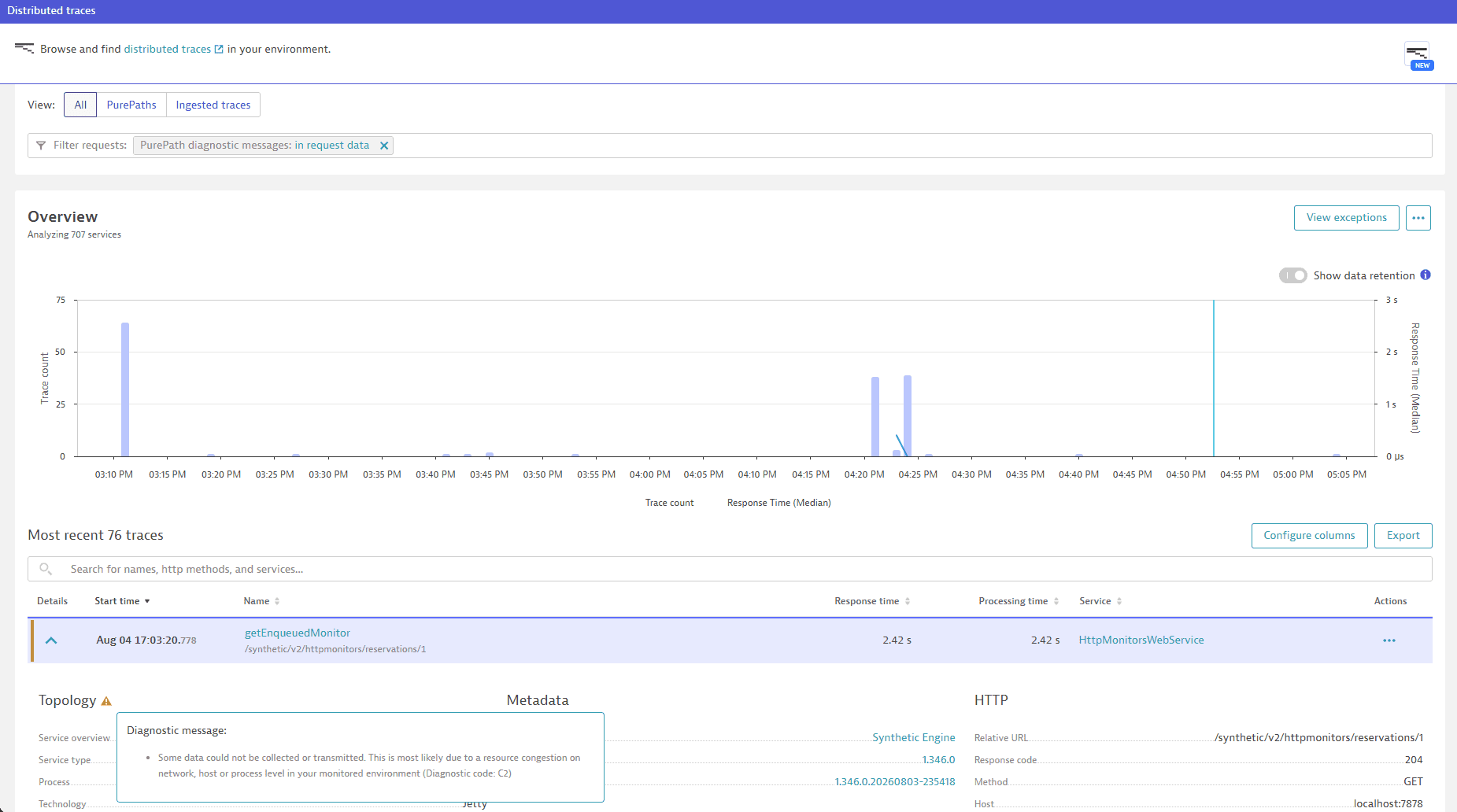

Captured distributed traces are the main source of data for Dynatrace Davis® causal AI. Because Davis relies on high data quality and fidelity, certain standards must be met to analyze the collected data; all services, methods, timings, properties, and so on must be correctly captured and transmitted. If this doesn't happen, you'll be informed of the issue via a diagnostic message for the affected traces.
  • In case the correct service can be determined, distributed traces with diagnostic messages are listed on the service's Distributed traces page, along with all other distributed traces related to the service.
  • In case a related service can't be determined, for example, because of a missing service name or type, distributed traces are listed as Unexpected services in the list of services of the process for which distributed traces have been captured.
    Unexpected services may be caused by network issues (data lost in transition) or by the abrupt termination of the process (restart or scaling).
