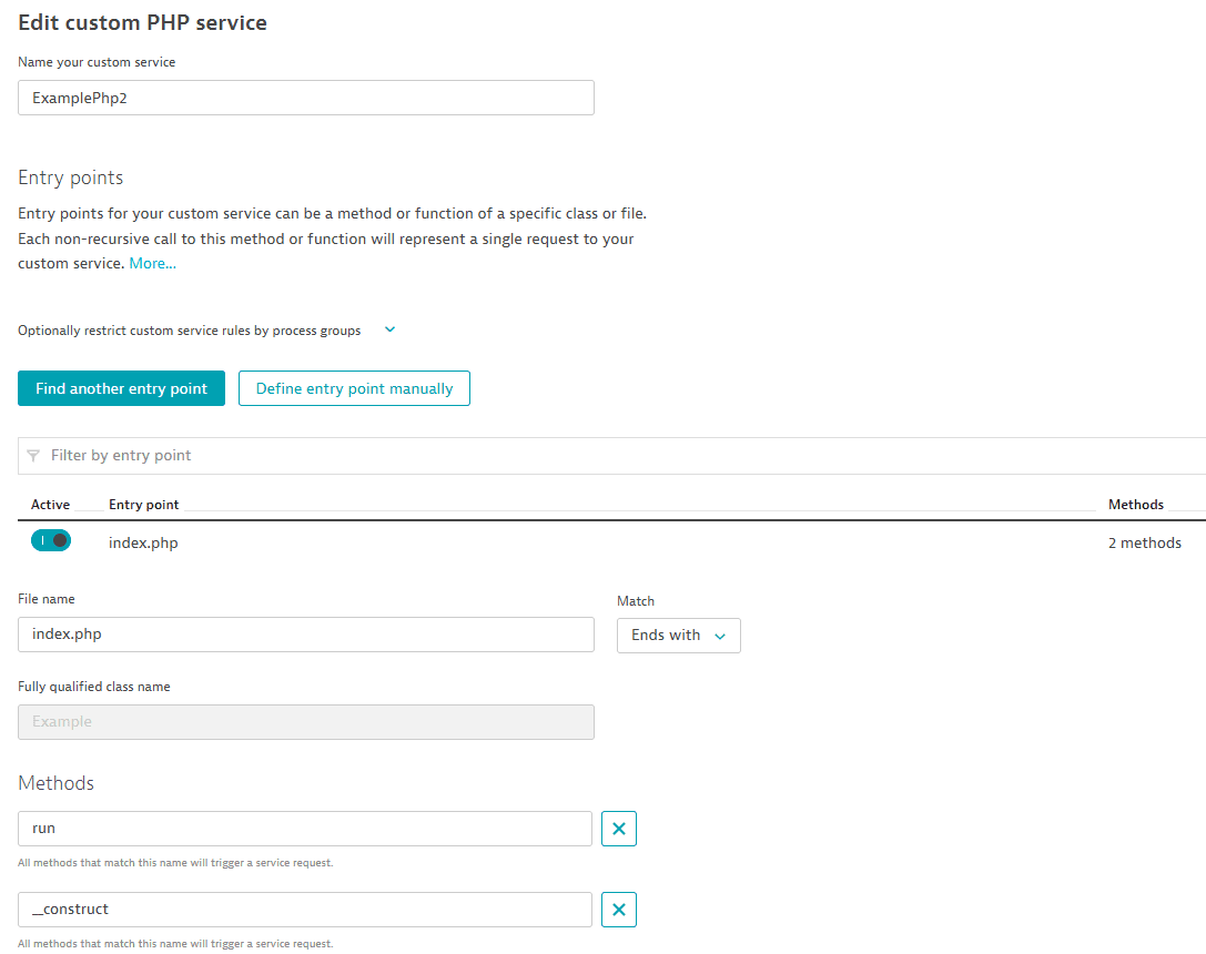

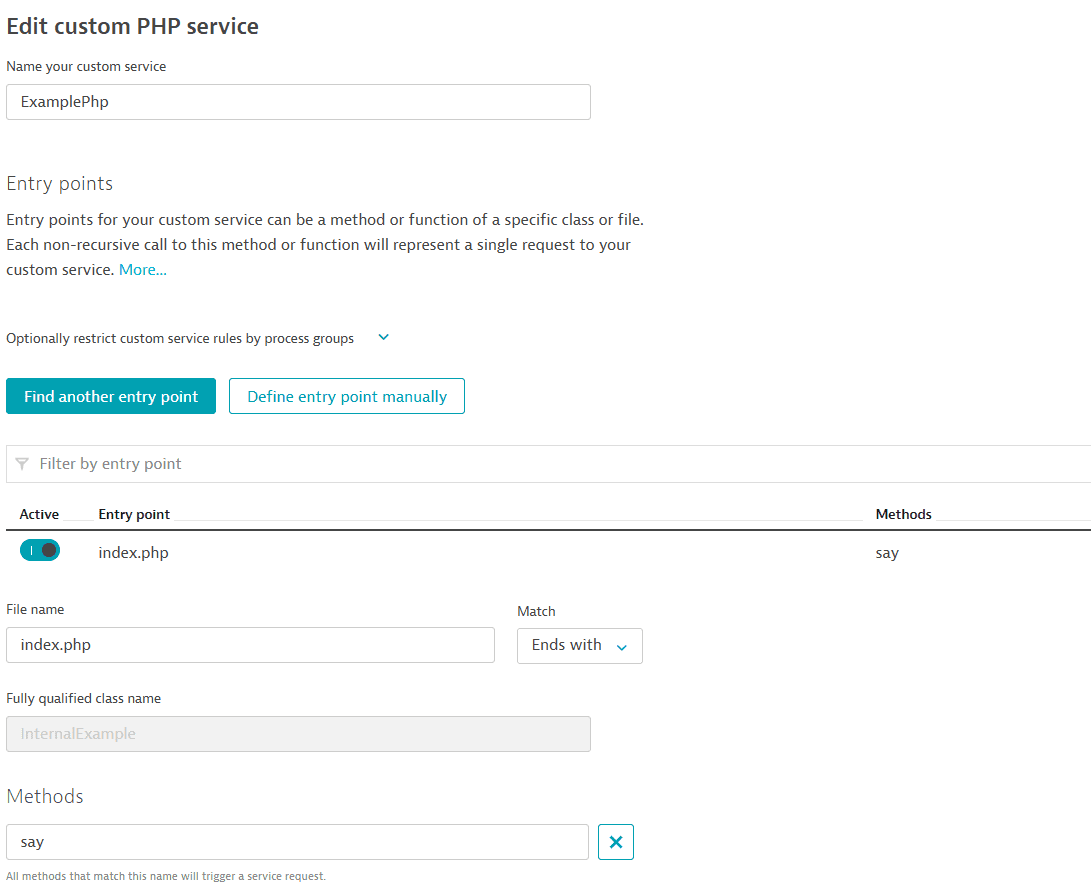

Now, we'll use our index.php file to define a custom service by following the steps in the Manually specify the entry point section above. Within the file, we can instrument specific functions as follows:
  • We can instrument the say function from the InternalExample class:
    Instrument the say function
  • We can instrument the run function from the Example class. Additionally, we'll instrument the __construct function of the Example class to show its creation in the trace.
    Instrument the construct function
In both examples, in the File name field, we use the Match option to use the local path to find the index.php file. Using local paths in custom service definitions is helpful because some PHP frameworks modify the script execution directory. When declaring class and method names, case sensitivity is essential, but you don't need to list method parameters.

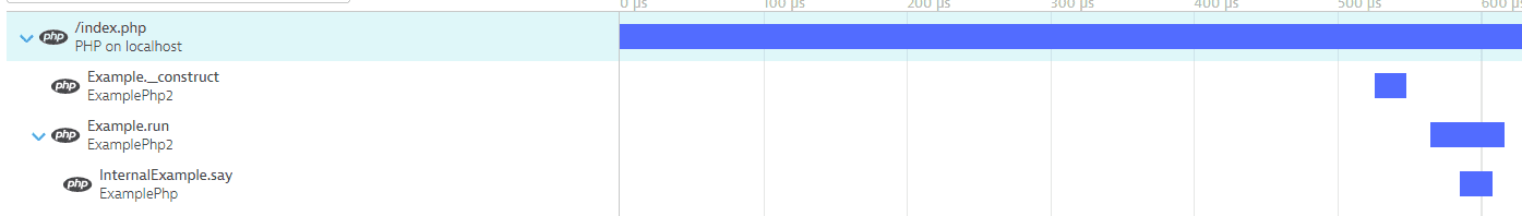

You can see the resulting pure paths in the Distributed Tracing (previous Dynatrace) or Distributed Traces Classic Distributed Traces Classic, both combined in one trace:
See several traces from one PHP file combined into one view
