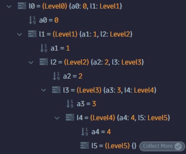

For example, if an object has a deeply nested field, we will stop when we reach the maximum collection depth (as in the following example). Note that l5 has more fields, but they weren’t collected because they were too deep.
example
